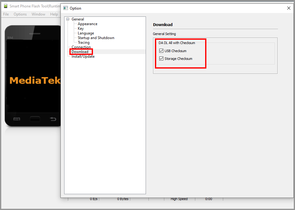

How To Fix in Lava Z81 FRP File & Fix Tool DL image Failed​
See the full video for Password
To solve the “DL Image Fail”
  • using the smartphone flash tool, you need to enable some option in the SP flash tool in the Download option, just open SP flash tool and load the Scatter.txt ofLava Z81 FRP File & Fix Tool DL image Failed file.
  • Select only Preloader file for Tool DL image Failed.
  • So, go to the “Options” tab which is the Left side corner of the SP Flash Tool, and click on the “Download” Tab.
  • Now Tick the 2 settings enable on download Tab ‘USB Checksum’ and ‘Storage Checksum’.
  • After completing the setting ‘DA DL All With Checksum’ just close the window.
  • After That Click on “Download”.
  • Then wait until the flashing process is complete.
  • After the flash complete
  • switch on the phone and you are done, there is no error on the phone screen anymore and you have successfully solved the “TOOL DL Image Fail” of the MediaTek Android smartphone.
