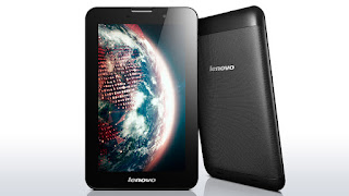

Lenovo Tab A3000 Dump File Dead Boot Repair Ufi Box

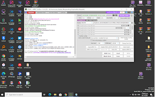

open ufi exe and identify emmc
Connection status: EHCI:HUB[#6]:USB 2.00 High-Speed
Interface: UFI High-Speed
Serial number: 0011-8840-6385
Boot version: 1.04, FW version: 1.14 (Aug 25 2021 04:56:05)
Insertion test... [No eMMC connected] Done
Init bus...
VCC: 3.3 V, VCCQ: 3.0 V
Bus: 8 bit (HS SDR 52MHz)
Access mode: sector mode
Product name: K8U00M (0x4b385530304d), rev: 0x04, serial number: 0x9FD18A53
Manufacturing date: Aug 2013
CID: 1501004B 38553030 4D049FD1 8A5380EE
CSD: D0270132 0F5903FF F6DBFFFF 8E40406C
EXT_CSD revision: 1.5 (MMC v4.41)
Partition info:
Boot1: 2 MiB
Boot2: 2 MiB
RPMB: 128 KiB [Authentication Key not yet programmed]
User area: 14.56 GiB(15,634,268,160 bytes)
Hardware reset function: 1
Partition configuration: 0x48
Boot acknowledge is sent during the boot operation
Boot partition 1 is enabled for boot
Partitioning support: 0x03
Device support partitioning feature
Device can have enhanced technological features
Device partitioning possible
Boot configuration protection: 0x00
Boot bus conditions: 0x00
Boot area write protection: 0x00
ANDROID System Info:
platform: MT6589, cpu abi: armeabi-v7a
manufacturer: LENOVO
board: a3000_row_call, name: LenovoA3000-H
brand: Lenovo, model: Lenovo A3000-H
build model list: Lenovo A3000-H
build id: JDQ39, version: 4.2.2 [Jelly Bean] (A3000_A422_003_014_130909_WW_CALL_FUSE)
build description: a3000_row_call-user 4.2.2 JDQ39 50 release-keys
EXT_CSD backup saved to "\\%BACKUPS%\K8U00M_9FD18A53.ext_csd"
eMMC selected: [SAMSUNG] KMK8U000VM-B410/16GB+LPDDR2 8Gb (BGA162)
