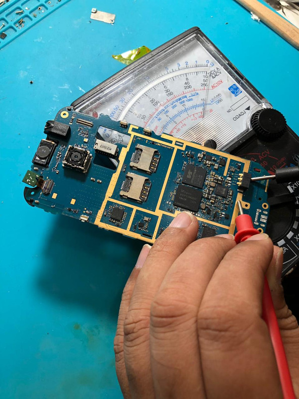

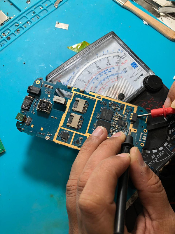

CHECK THIS PHONE FULL SHORT
2-
CHANGE METER PROBE STILL FULL SHORT
3-

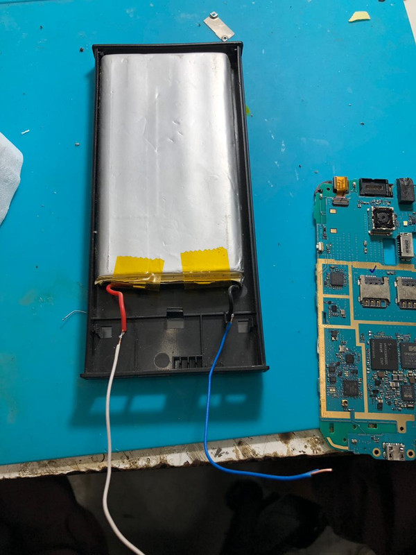

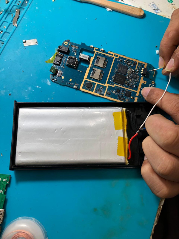

OPEN ANY POWER BANK AND REMOVE BATTERY
4-
CONNECT GROUND BLACK POINT TO GROUND AND RED ON BATTERY +
JUST FOR 3 SECONDS
5-

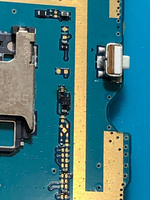

AND YOU WILL GETT BURN CAPACITOR LIKE THIS SOME CASEES IC PROBLEM THEN IC WILL HEATUP USE FLUX OR SPRAY TO FIND
MINE WAS CAPACITOR
6-

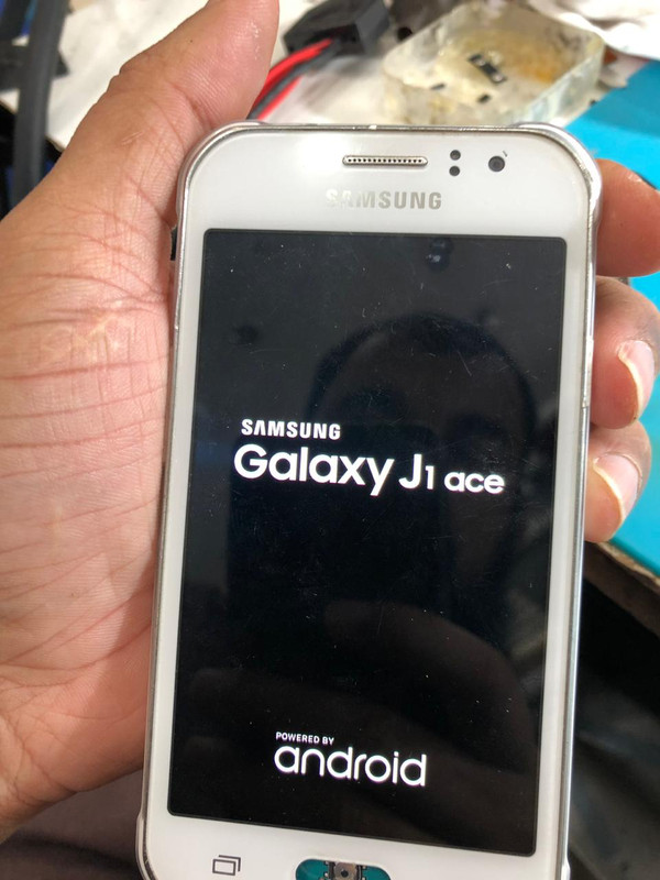

FINALY REMOVE BURN CAPACITOR AND PHONE IS WORK
<BEFORE I WAS WORK ON 2 J1 REMOVE ALMOST EVERYTHING CAP IC ON BOARD SPENT HOURS BUTT SHORTAGE WAS NOT REMOVED>
BUTT TODAY ITS TOOK 2 SECOND

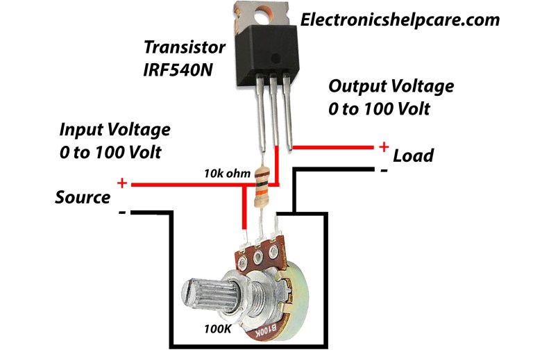

AS I WRITE WE ARE GOING TO MAKE IT FREE EERY ONE SO POST YOUR IDEA AND PICTURES HERE TO IMPROOVE AND ADD MORE FETURES IN SHORT KILLER TOOL
MY IDEAS

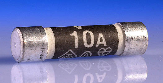

1-CAN ADD FUSE 0F 5 TO 10 AMP FOR SAFETY
2- CAN ADD VOLTAGE REGULATOR
BATTERY MOSTLY GIVE 3 TO 5 VOLTS
BUTT WE CAN RGULATE AND START CHECKING FROM 2 VOLTS
IFF SHORTAGE NOT DETECT INCREAS VOLTAGE 3,4,5....
ITS IMPORTANT FOR BOARD SAFETY HIGY VOLTAGE MAY DAMAGE PRINTS OR CPU OR EMMC OR ANOTHER SO START WITH 2 VOLTS
