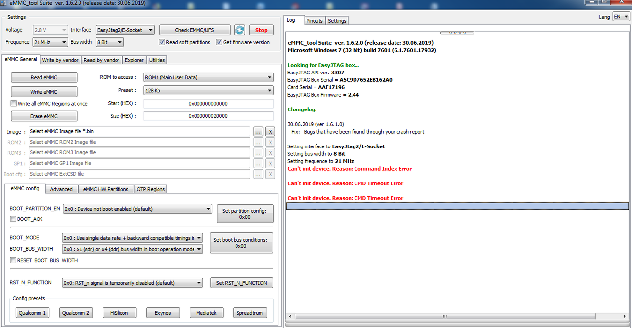

Read Info

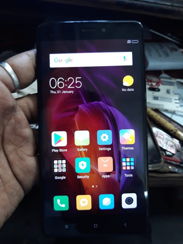

found Emmc dead
Now took New Emmc and Pogrammed
Factory Format

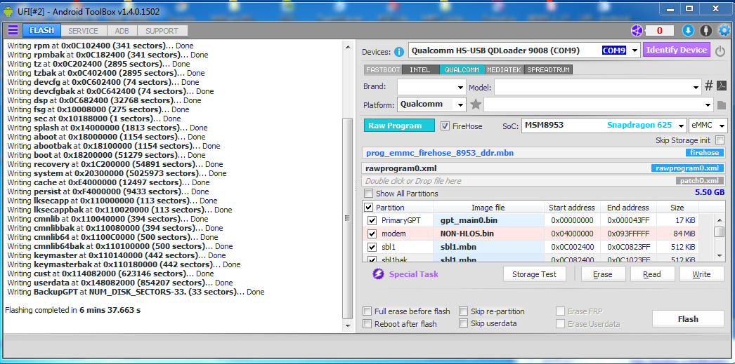

Now writing Firmware

02-Oct-19 6:30:07 PM> Opening file: G:\MI\note 4\mido_global_change_emmc\rawprogram0.xml
02-Oct-19 6:30:07 PM> The size of the last section has been updated
02-Oct-19 6:30:11 PM>

02-Oct-19 6:30:13 PM> Operation: Write by vendor (Qualcomm/HiSilicon/Omap)
02-Oct-19 6:30:13 PM> Creating GPT-partitioninig
02-Oct-19 6:30:13 PM> Writing PrimaryGPT at address: 000000000000
02-Oct-19 6:30:13 PM> Writing BackupGPT at address: 000E8F7FBE00
02-Oct-19 6:30:13 PM> GPT-partitioning done
02-Oct-19 6:30:13 PM> Partition name: modem
02-Oct-19 6:30:13 PM> Filename: NON-HLOS.bin , Offset: 000004000000 , filesize: 88080384 bytes
02-Oct-19 6:30:13 PM> eMMC switching to ROM1
02-Oct-19 6:30:14 PM> Erasing partition...
02-Oct-19 6:30:17 PM> Writing partition...
02-Oct-19 6:30:58 PM> Done writing partition. Write speed: 2132.37 KB/s
02-Oct-19 6:30:58 PM> Partition name: fsc
02-Oct-19 6:30:58 PM> Filename: fsc , Offset: 00000C000000 , filesize: 1024 bytes
02-Oct-19 6:30:58 PM> eMMC switching to ROM1
02-Oct-19 6:30:58 PM> Erasing partition...
02-Oct-19 6:30:58 PM> Writing partition...
02-Oct-19 6:30:58 PM> Done writing partition. Write speed: 365.73 KB/s
02-Oct-19 6:30:58 PM> Partition name: ssd
02-Oct-19 6:30:58 PM> Filename: ssd , Offset: 00000C000400 , filesize: 8192 bytes
02-Oct-19 6:30:59 PM> Writing partition...
02-Oct-19 6:30:59 PM> Done writing partition. Write speed: 518.33 KB/s
02-Oct-19 6:30:59 PM> Partition name: sbl1
02-Oct-19 6:30:59 PM> Filename: sbl1.mbn , Offset: 00000C002400 , filesize: 524288 bytes
02-Oct-19 6:30:59 PM> eMMC switching to ROM1
02-Oct-19 6:30:59 PM> Erasing partition...
02-Oct-19 6:31:00 PM> Writing partition...
02-Oct-19 6:31:00 PM> Done writing partition. Write speed: 2170.02 KB/s
02-Oct-19 6:31:00 PM> Partition name: sbl1bak
02-Oct-19 6:31:00 PM> Filename: sbl1.mbn , Offset: 00000C082400 , filesize: 524288 bytes
02-Oct-19 6:31:00 PM> eMMC switching to ROM1
02-Oct-19 6:31:00 PM> Erasing partition...
02-Oct-19 6:31:01 PM> Writing partition...
02-Oct-19 6:31:01 PM> Done writing partition. Write speed: 2377.57 KB/s
02-Oct-19 6:31:01 PM> Partition name: rpm
02-Oct-19 6:31:01 PM> Filename: rpm.mbn , Offset: 00000C102400 , filesize: 524288 bytes
02-Oct-19 6:31:01 PM> eMMC switching to ROM1
02-Oct-19 6:31:01 PM> Erasing partition...
02-Oct-19 6:31:02 PM> Done writing partition. Write speed: 2142.91 KB/s
02-Oct-19 6:31:02 PM> Partition name: rpmbak
02-Oct-19 6:31:02 PM> Filename: rpm.mbn , Offset: 00000C182400 , filesize: 524288 bytes
02-Oct-19 6:31:02 PM> eMMC switching to ROM1
02-Oct-19 6:31:02 PM> Erasing partition...
02-Oct-19 6:31:02 PM> Writing partition...
02-Oct-19 6:31:03 PM> Done writing partition. Write speed: 2388.85 KB/s
02-Oct-19 6:31:03 PM> Partition name: tz
02-Oct-19 6:31:03 PM> Filename: tz.mbn , Offset: 00000C202400 , filesize: 2097152 bytes
02-Oct-19 6:31:03 PM> eMMC switching to ROM1
02-Oct-19 6:31:03 PM> Erasing partition...
02-Oct-19 6:31:03 PM> Writing partition...
02-Oct-19 6:31:04 PM> Done writing partition. Write speed: 2317.93 KB/s
02-Oct-19 6:31:04 PM> Partition name: tzbak
02-Oct-19 6:31:04 PM> Filename: tz.mbn , Offset: 00000C402400 , filesize: 2097152 bytes
02-Oct-19 6:31:04 PM> eMMC switching to ROM1
02-Oct-19 6:31:04 PM> Erasing partition...
02-Oct-19 6:31:05 PM> Writing partition...
02-Oct-19 6:31:06 PM> Done writing partition. Write speed: 2382.22 KB/s
02-Oct-19 6:31:06 PM> Partition name: devcfg
02-Oct-19 6:31:06 PM> Filename: devcfg , Offset: 00000C602400 , filesize: 262144 bytes
02-Oct-19 6:31:06 PM> eMMC switching to ROM1
02-Oct-19 6:31:06 PM> Erasing partition...
02-Oct-19 6:31:06 PM> Writing partition...
02-Oct-19 6:31:07 PM> Done writing partition. Write speed: 1939.00 KB/s
02-Oct-19 6:31:07 PM> Partition name: devcfgbak
02-Oct-19 6:31:07 PM> Filename: devcfgbak , Offset: 00000C642400 , filesize: 262144 bytes
02-Oct-19 6:31:07 PM> eMMC switching to ROM1
02-Oct-19 6:31:07 PM> Erasing partition...
02-Oct-19 6:31:07 PM> Writing partition...
02-Oct-19 6:31:07 PM> Done writing partition. Write speed: 1868.10 KB/s
02-Oct-19 6:31:07 PM> Partition name: dsp
02-Oct-19 6:31:07 PM> Filename: dsp , Offset: 00000C682400 , filesize: 16777216 bytes
02-Oct-19 6:31:08 PM> Erasing partition...
02-Oct-19 6:31:08 PM> Writing partition...
02-Oct-19 6:31:15 PM> Done writing partition. Write speed: 2363.27 KB/s
02-Oct-19 6:31:15 PM> Partition name: modemst1
02-Oct-19 6:31:15 PM> Filename: modemst1 , Offset: 00000D682400 , filesize: 1572864 bytes
02-Oct-19 6:31:15 PM> eMMC switching to ROM1
02-Oct-19 6:31:16 PM> Erasing partition...
02-Oct-19 6:31:16 PM> Writing partition...
02-Oct-19 6:31:17 PM> Done writing partition. Write speed: 2286.85 KB/s
02-Oct-19 6:31:17 PM> Partition name: modemst2
02-Oct-19 6:31:17 PM> Filename: modemst2 , Offset: 00000D802400 , filesize: 1572864 bytes
02-Oct-19 6:31:17 PM> eMMC switching to ROM1
02-Oct-19 6:31:17 PM> Erasing partition...
02-Oct-19 6:31:18 PM> Writing partition...
02-Oct-19 6:31:18 PM> Done writing partition. Write speed: 2372.49 KB/s
02-Oct-19 6:31:18 PM> Partition name: DDR
02-Oct-19 6:31:18 PM> Filename: DDR , Offset: 000010000000 , filesize: 32768 bytes
02-Oct-19 6:31:18 PM> eMMC switching to ROM1
02-Oct-19 6:31:18 PM> Erasing partition...
02-Oct-19 6:31:19 PM> Writing partition...
02-Oct-19 6:31:19 PM> Done writing partition. Write speed: 1262.12 KB/s
02-Oct-19 6:31:19 PM> Partition name: fsg
02-Oct-19 6:31:19 PM> Filename: fsg , Offset: 000010008000 , filesize: 1572864 bytes
02-Oct-19 6:31:19 PM> eMMC switching to ROM1
02-Oct-19 6:31:19 PM> Erasing partition...
02-Oct-19 6:31:20 PM> Writing partition...
02-Oct-19 6:31:20 PM> Done writing partition. Write speed: 2287.96 KB/s
02-Oct-19 6:31:20 PM> Partition name: sec
02-Oct-19 6:31:20 PM> Filename: sec.dat , Offset: 000010188000 , filesize: 16384 bytes
02-Oct-19 6:31:20 PM> eMMC switching to ROM1
02-Oct-19 6:31:20 PM> Erasing partition...
02-Oct-19 6:31:21 PM> Writing partition...
02-Oct-19 6:31:21 PM> Done writing partition. Write speed: 860.66 KB/s
02-Oct-19 6:31:21 PM> Partition name: splash
02-Oct-19 6:31:21 PM> Filename: splash.img , Offset: 000014000000 , filesize: 11534336 bytes
02-Oct-19 6:31:21 PM> eMMC switching to ROM1
02-Oct-19 6:31:21 PM> Erasing partition...
02-Oct-19 6:31:22 PM> Writing partition...
02-Oct-19 6:31:27 PM> Done writing partition. Write speed: 2364.74 KB/s
02-Oct-19 6:31:27 PM> Partition name: aboot
02-Oct-19 6:31:27 PM> Filename: emmc_appsboot.mbn , Offset: 000018000000 , filesize: 1048576 bytes
02-Oct-19 6:31:27 PM> eMMC switching to ROM1
02-Oct-19 6:31:27 PM> Erasing partition...
02-Oct-19 6:31:27 PM> Writing partition...
02-Oct-19 6:31:28 PM> Done writing partition. Write speed: 2253.97 KB/s
02-Oct-19 6:31:28 PM> Partition name: abootbak
02-Oct-19 6:31:28 PM> Filename: emmc_appsboot.mbn , Offset: 000018100000 , filesize: 1048576 bytes
02-Oct-19 6:31:28 PM> eMMC switching to ROM1
02-Oct-19 6:31:28 PM> Erasing partition...
02-Oct-19 6:31:28 PM> Writing partition...
02-Oct-19 6:31:29 PM> Done writing partition. Write speed: 2375.25 KB/s
02-Oct-19 6:31:29 PM> Partition name: boot
02-Oct-19 6:31:29 PM> Filename: boot.img , Offset: 000018200000 , filesize: 67108864 bytes
02-Oct-19 6:31:29 PM> eMMC switching to ROM1
02-Oct-19 6:31:29 PM> Erasing partition...
02-Oct-19 6:31:31 PM> Writing partition...
02-Oct-19 6:31:59 PM> Done writing partition. Write speed: 2369.67 KB/s
02-Oct-19 6:31:59 PM> Partition name: recovery
02-Oct-19 6:31:59 PM> Filename: recovery.img , Offset: 00001C200000 , filesize: 67108864 bytes
02-Oct-19 6:31:59 PM> eMMC switching to ROM1
02-Oct-19 6:31:59 PM> Erasing partition...
02-Oct-19 6:32:01 PM> Writing partition...
02-Oct-19 6:32:29 PM> Done writing partition. Write speed: 2372.25 KB/s
02-Oct-19 6:32:29 PM> Partition name: devinfo
02-Oct-19 6:32:29 PM> Filename: devinfo , Offset: 000020200000 , filesize: 1048576 bytes
02-Oct-19 6:32:29 PM> eMMC switching to ROM1
02-Oct-19 6:32:29 PM> Erasing partition...
02-Oct-19 6:32:30 PM> Writing partition...
02-Oct-19 6:32:30 PM> Done writing partition. Write speed: 2258.72 KB/s
02-Oct-19 6:32:30 PM> Partition name: system
02-Oct-19 6:32:30 PM> Filename: system.img , Offset: 000020300000 , filesize: 3221225472 bytes
02-Oct-19 6:32:30 PM> eMMC switching to ROM1
02-Oct-19 6:32:30 PM> Erasing partition...
02-Oct-19 6:33:51 PM> Writing partition...
02-Oct-19 6:55:59 PM> Done writing partition. Write speed: 2368.25 KB/s
02-Oct-19 6:55:59 PM> Partition name: cache
02-Oct-19 6:55:59 PM> Filename: cache.img , Offset: 0000E4000000 , filesize: 268435456 bytes
02-Oct-19 6:55:59 PM> eMMC switching to ROM1
02-Oct-19 6:55:59 PM> Erasing partition...
02-Oct-19 6:56:06 PM> Writing partition...
02-Oct-19 6:57:57 PM> Done writing partition. Write speed: 2367.45 KB/s
02-Oct-19 6:57:57 PM> Partition name: persist
02-Oct-19 6:57:57 PM> Filename: persist.img , Offset: 0000F4000000 , filesize: 33554432 bytes
02-Oct-19 6:57:57 PM> eMMC switching to ROM1
02-Oct-19 6:57:57 PM> Erasing partition...
02-Oct-19 6:57:59 PM> Writing partition...
02-Oct-19 6:58:12 PM> Done writing partition. Write speed: 2364.18 KB/s
02-Oct-19 6:58:12 PM> Partition name: misc
02-Oct-19 6:58:12 PM> Filename: misc.img , Offset: 0000F6000000 , filesize: 1048576 bytes
02-Oct-19 6:58:12 PM> eMMC switching to ROM1
02-Oct-19 6:58:13 PM> Erasing partition...
02-Oct-19 6:58:13 PM> Writing partition...
02-Oct-19 6:58:14 PM> Done writing partition. Write speed: 2269.29 KB/s
02-Oct-19 6:58:14 PM> Partition name: keystore
02-Oct-19 6:58:14 PM> Filename: keystore.bin , Offset: 0000F6100000 , filesize: 524288 bytes
02-Oct-19 6:58:14 PM> eMMC switching to ROM1
02-Oct-19 6:58:14 PM> Erasing partition...
02-Oct-19 6:58:14 PM> Writing partition...
02-Oct-19 6:58:15 PM> Done writing partition. Write speed: 2113.14 KB/s
02-Oct-19 6:58:15 PM> Partition name: config
02-Oct-19 6:58:15 PM> Filename: config.img , Offset: 0000F6180000 , filesize: 32768 bytes
02-Oct-19 6:58:15 PM> eMMC switching to ROM1
02-Oct-19 6:58:15 PM> Erasing partition...
02-Oct-19 6:58:15 PM> Writing partition...
02-Oct-19 6:58:15 PM> Done writing partition. Write speed: 1242.58 KB/s
02-Oct-19 6:58:15 PM> Partition name: oem
02-Oct-19 6:58:15 PM> Filename: oem.bin , Offset: 0000F6188000 , filesize: 268435456 bytes
02-Oct-19 6:58:23 PM> Writing partition...
02-Oct-19 7:00:13 PM> Done writing partition. Write speed: 2367.38 KB/s
02-Oct-19 7:00:13 PM> Partition name: limits
02-Oct-19 7:00:13 PM> Filename: limits , Offset: 000108000000 , filesize: 32768 bytes
02-Oct-19 7:00:13 PM> eMMC switching to ROM1
02-Oct-19 7:00:14 PM> Erasing partition...
02-Oct-19 7:00:14 PM> Writing partition...
02-Oct-19 7:00:14 PM> Done writing partition. Write speed: 1238.57 KB/s
02-Oct-19 7:00:14 PM> Partition name: mota
02-Oct-19 7:00:14 PM> Filename: mota , Offset: 00010C000000 , filesize: 524288 bytes
02-Oct-19 7:00:14 PM> eMMC switching to ROM1
02-Oct-19 7:00:15 PM> Writing partition...
02-Oct-19 7:00:15 PM> Done writing partition. Write speed: 2116.09 KB/s
02-Oct-19 7:00:15 PM> Partition name: dip
02-Oct-19 7:00:15 PM> Filename: dip , Offset: 00010C080000 , filesize: 1048576 bytes
02-Oct-19 7:00:15 PM> eMMC switching to ROM1
02-Oct-19 7:00:15 PM> Erasing partition...
02-Oct-19 7:00:16 PM> Writing partition...
02-Oct-19 7:00:16 PM> Done writing partition. Write speed: 2233.95 KB/s
02-Oct-19 7:00:16 PM> Partition name: mdtp
02-Oct-19 7:00:16 PM> Filename: mdtp , Offset: 00010C180000 , filesize: 33554432 bytes
02-Oct-19 7:00:16 PM> eMMC switching to ROM1
02-Oct-19 7:00:16 PM> Erasing partition...
02-Oct-19 7:00:18 PM> Writing partition...
02-Oct-19 7:00:31 PM> Done writing partition. Write speed: 2370.14 KB/s
02-Oct-19 7:00:31 PM> Partition name: syscfg
02-Oct-19 7:00:31 PM> Filename: syscfg , Offset: 00010E180000 , filesize: 524288 bytes
02-Oct-19 7:00:31 PM> eMMC switching to ROM1
02-Oct-19 7:00:32 PM> Erasing partition...
02-Oct-19 7:00:32 PM> Writing partition...
02-Oct-19 7:00:32 PM> Done writing partition. Write speed: 2141.69 KB/s
02-Oct-19 7:00:32 PM> Partition name: mcfg
02-Oct-19 7:00:32 PM> Filename: mcfg , Offset: 00010E200000 , filesize: 4194304 bytes
02-Oct-19 7:00:32 PM> eMMC switching to ROM1
02-Oct-19 7:00:33 PM> Erasing partition...
02-Oct-19 7:00:33 PM> Writing partition...
02-Oct-19 7:00:35 PM> Done writing partition. Write speed: 2350.79 KB/s
02-Oct-19 7:00:35 PM> Partition name: lksecapp
02-Oct-19 7:00:35 PM> Filename: lksecapp.dat , Offset: 000110000000 , filesize: 131072 bytes
02-Oct-19 7:00:35 PM> eMMC switching to ROM1
02-Oct-19 7:00:35 PM> Erasing partition...
02-Oct-19 7:00:36 PM> Writing partition...
02-Oct-19 7:00:36 PM> Done writing partition. Write speed: 2026.11 KB/s
02-Oct-19 7:00:36 PM> Partition name: lksecappbak
02-Oct-19 7:00:36 PM> Filename: lksecappbak.dat , Offset: 000110020000 , filesize: 131072 bytes
02-Oct-19 7:00:36 PM> eMMC switching to ROM1
02-Oct-19 7:00:36 PM> Erasing partition...
02-Oct-19 7:00:36 PM> Done writing partition. Write speed: 2034.99 KB/s
02-Oct-19 7:00:36 PM> Partition name: cmnlib
02-Oct-19 7:00:36 PM> Filename: cmnlib , Offset: 000110040000 , filesize: 262144 bytes
02-Oct-19 7:00:37 PM> Erasing partition...
02-Oct-19 7:00:37 PM> Writing partition...
02-Oct-19 7:00:37 PM> Done writing partition. Write speed: 1839.81 KB/s
02-Oct-19 7:00:37 PM> Partition name: cmnlibbak
02-Oct-19 7:00:37 PM> Filename: cmnlibbak , Offset: 000110080000 , filesize: 262144 bytes
02-Oct-19 7:00:37 PM> eMMC switching to ROM1
02-Oct-19 7:00:38 PM> Writing partition...
02-Oct-19 7:00:38 PM> Done writing partition. Write speed: 1853.45 KB/s
02-Oct-19 7:00:38 PM> Partition name: cmnlib64
02-Oct-19 7:00:38 PM> Filename: cmnlib64 , Offset: 0001100C0000 , filesize: 262144 bytes

After this Flashed with Ufi Android tool
and phone is ready
found Emmc dead
Factory Format
02-Oct-19 6:28:41 PM> Looking for EasyJTAG box...
02-Oct-19 6:28:41 PM> EasyJTAG API ver. 3307
02-Oct-19 6:28:41 PM> Setting IO Levels to 2.8V
02-Oct-19 6:28:41 PM> Setting frequence to 21 MHz
02-Oct-19 6:28:41 PM> EasyJTAG Box Serial =
02-Oct-19 6:28:41 PM> EasyJTAG Box Firmware = 2.44
02-Oct-19 6:28:42 PM> Setting interface to EasyJtag2/E-Socket
02-Oct-19 6:28:42 PM> Setting bus width to 1 Bit
02-Oct-19 6:28:42 PM> Setting frequence to 21 MHz
02-Oct-19 6:28:43 PM> eMMC Init returned = 0
02-Oct-19 6:28:43 PM> EMMC Device Information :
02-Oct-19 6:28:43 PM> EMMC CID: 150100524331344D42076FC1DE07A3A7
02-Oct-19 6:28:43 PM> EMMC CSD: D02701320F5903FFF6DBFFEF8E40400D
02-Oct-19 6:28:43 PM> EMMC Manufacture : SAMSUNG , EMMC NAME: RC14MB , HEX: 524331344D42 , S/N: 6FC1DE07 , rev. 0x07
02-Oct-19 6:28:43 PM> EMMC Manufacture ID: 0x15 , OEM ID: 0x00 , Device Type: BGA (Discrete embedded) , Date: 10/2016
02-Oct-19 6:28:43 PM> EMMC ROM 1 (Main User Data) Capacity: 59640 MB (000E8F800000)
02-Oct-19 6:28:43 PM> EMMC ROM 2/3 (Boot Partition 1/2) Capacity: 4096 KB (000000400000)
02-Oct-19 6:28:43 PM> EMMC RPMB (Replay Protected Memory Block) Capacity: 4096 KB (000000400000) Counter: 22268 , Response: Not Clean
02-Oct-19 6:28:43 PM> EMMC Permanent Write Protection: No
02-Oct-19 6:28:43 PM> EMMC Temporary Write Protection: No
02-Oct-19 6:28:43 PM> Extended CSD Information :
02-Oct-19 6:28:43 PM> Extended CSD rev: 1.8 (MMC 5.1)
02-Oct-19 6:28:43 PM> Boot configuration [PARTITION_CONFIG]: 0x38 , Boot from: ROM1 (Main User Area)
02-Oct-19 6:28:43 PM> Boot Bus Config: 0x00 , width 1bit
02-Oct-19 6:28:43 PM> H/W Reset Function [RST_N_FUNCTION]: 0x01, RST_n signal is permanently enabled
02-Oct-19 6:28:43 PM> Supported partition features [PARTITIONING_SUPPORT]: 0x07
02-Oct-19 6:28:43 PM> Device supports partitioning features
02-Oct-19 6:28:43 PM> Device can have enhanced technological features in partitions and user data area
02-Oct-19 6:28:43 PM> Device can have extended partitions attribute
02-Oct-19 6:28:43 PM> Partition Settings [PARTITION_SETTING_COMPLETED]: 0x00
02-Oct-19 6:28:43 PM> Backup saved: RC14MB_6FC1DE07_20191002_182843.extcsd
02-Oct-19 6:28:43 PM> EMMC Init completed.
02-Oct-19 6:28:43 PM> Operation: Universal Factory Format
02-Oct-19 6:28:43 PM> Please, wait ...
02-Oct-19 6:28:45 PM>
02-Oct-19 6:28:45 PM> Successfully
02-Oct-19 6:29:27 PM>
and phone is ready
