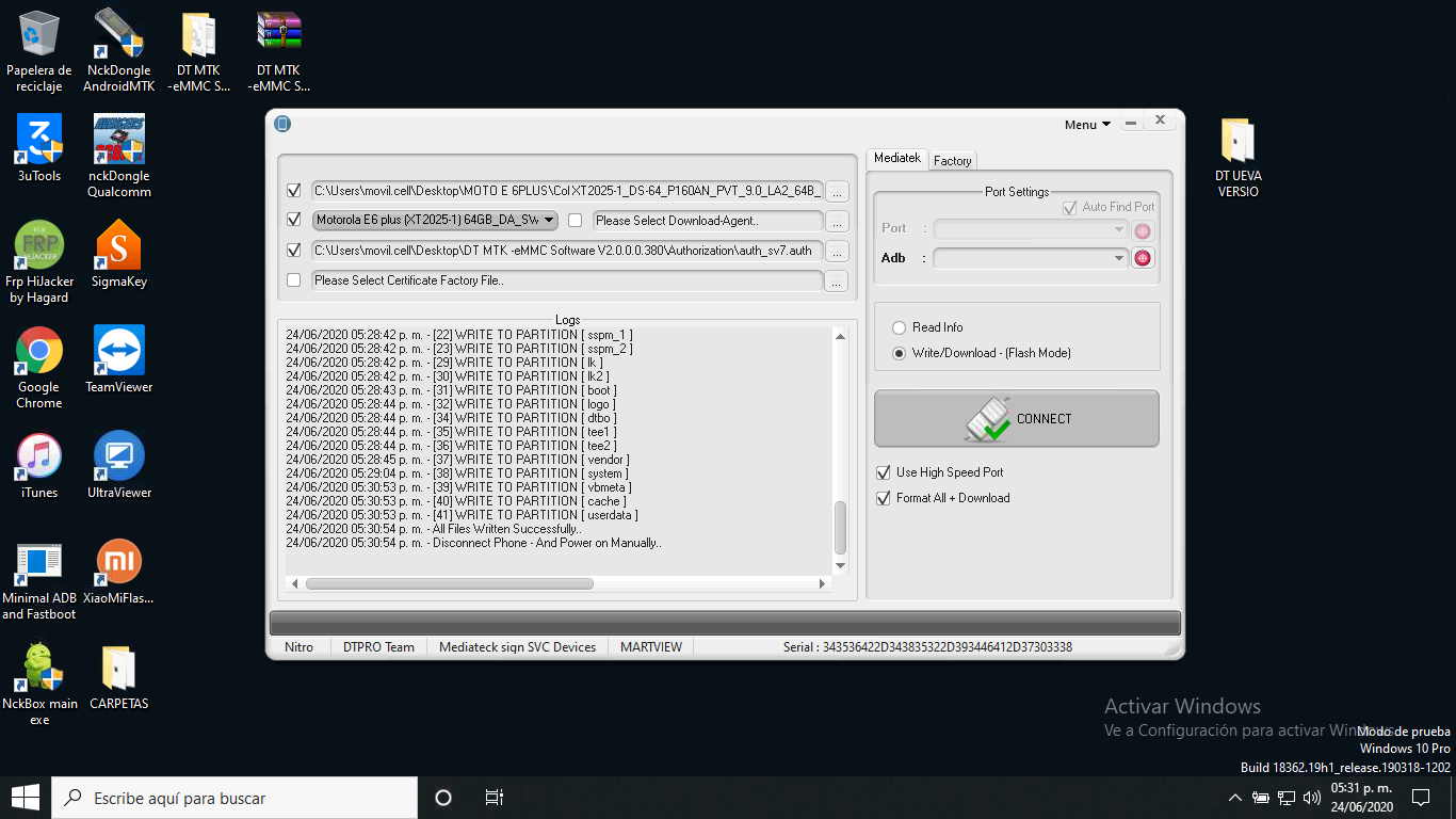

Motorola E6 plus recovered Success!! (customer test report from Colombia)

24/06/2020 05:28:11 p. m. - Loading Files...
24/06/2020 05:28:11 p. m. - Da File : C:\Users\movil.cell\Desktop\DT MTK -eMMC Software V2.0.0.0.380\X-Agent\Motorola E6 plus (XT2025-1) 64GB_DA_SWSEC_1848_PTB29.191.bin
24/06/2020 05:28:11 p. m. - Checking File 0 [preloader].. ok
24/06/2020 05:28:11 p. m. - Checking File 3 [recovery].. ok
24/06/2020 05:28:11 p. m. - Checking File 17 [signinfo].. ok
24/06/2020 05:28:11 p. m. - Checking File 18 [md1img].. ok
24/06/2020 05:28:11 p. m. - Checking File 19 [spmfw].. ok
24/06/2020 05:28:11 p. m. - Checking File 20 [scp1].. ok
24/06/2020 05:28:11 p. m. - Checking File 21 [scp2].. ok
24/06/2020 05:28:12 p. m. - Checking File 22 [sspm_1].. ok
24/06/2020 05:28:12 p. m. - Checking File 23 [sspm_2].. ok
24/06/2020 05:28:12 p. m. - Checking File 29 [lk].. ok
24/06/2020 05:28:12 p. m. - Checking File 30 [lk2].. ok
24/06/2020 05:28:12 p. m. - Checking File 31 [boot].. ok
24/06/2020 05:28:12 p. m. - Checking File 32 [logo].. ok
24/06/2020 05:28:12 p. m. - Checking File 34 [dtbo].. ok
24/06/2020 05:28:12 p. m. - Checking File 35 [tee1].. ok
24/06/2020 05:28:12 p. m. - Checking File 36 [tee2].. ok
24/06/2020 05:28:12 p. m. - Checking File 37 [vendor].. ok
24/06/2020 05:28:12 p. m. - Checking File 38 [system].. ok
24/06/2020 05:28:12 p. m. - Checking File 39 [vbmeta].. ok
24/06/2020 05:28:12 p. m. - Checking File 40 [cache].. ok
24/06/2020 05:28:12 p. m. - Checking File 41 [userdata].. ok
24/06/2020 05:28:12 p. m. - Chip : MT6765
24/06/2020 05:28:12 p. m. - Storage : EMMC
24/06/2020 05:28:12 p. m. - Format Before Flash Enabled...
24/06/2020 05:28:12 p. m. - Using High-Speed Port...
24/06/2020 05:28:12 p. m. - Starting Flash Task...
24/06/2020 05:28:13 p. m. - Waiting For Phone - [Brom Mode]...
24/06/2020 05:28:28 p. m. - Phone Found on : MediaTek USB Port (COM25)
24/06/2020 05:28:29 p. m. - Connected to Device [Brom-Mode]..
24/06/2020 05:28:29 p. m. - Writing Da File..
24/06/2020 05:28:31 p. m. - Connected to Device [Da-Mode]..
24/06/2020 05:28:32 p. m. - Formatting Data - Region : [0x0] - Size : [0x0]
24/06/2020 05:28:36 p. m. - Starting Flash Write Process..
24/06/2020 05:28:36 p. m. - Stage:
24/06/2020 05:28:36 p. m. - [0] WRITE TO PARTITION [ preloader ]
24/06/2020 05:28:36 p. m. - Writing Bootloader..
24/06/2020 05:28:37 p. m. - [3] WRITE TO PARTITION [ recovery ]
24/06/2020 05:28:37 p. m. - Writing Files..
24/06/2020 05:28:38 p. m. - [17] WRITE TO PARTITION [ signinfo ]
24/06/2020 05:28:39 p. m. - [18] WRITE TO PARTITION [ md1img ]
24/06/2020 05:28:42 p. m. - [19] WRITE TO PARTITION [ spmfw ]
24/06/2020 05:28:42 p. m. - [20] WRITE TO PARTITION [ scp1 ]
24/06/2020 05:28:42 p. m. - [21] WRITE TO PARTITION [ scp2 ]
24/06/2020 05:28:42 p. m. - [22] WRITE TO PARTITION [ sspm_1 ]
24/06/2020 05:28:42 p. m. - [23] WRITE TO PARTITION [ sspm_2 ]
24/06/2020 05:28:42 p. m. - [29] WRITE TO PARTITION [ lk ]
24/06/2020 05:28:42 p. m. - [30] WRITE TO PARTITION [ lk2 ]
24/06/2020 05:28:43 p. m. - [31] WRITE TO PARTITION [ boot ]
24/06/2020 05:28:44 p. m. - [32] WRITE TO PARTITION [ logo ]
24/06/2020 05:28:44 p. m. - [34] WRITE TO PARTITION [ dtbo ]
24/06/2020 05:28:44 p. m. - [35] WRITE TO PARTITION [ tee1 ]
24/06/2020 05:28:44 p. m. - [36] WRITE TO PARTITION [ tee2 ]
24/06/2020 05:28:45 p. m. - [37] WRITE TO PARTITION [ vendor ]
24/06/2020 05:29:04 p. m. - [38] WRITE TO PARTITION [ system ]
24/06/2020 05:30:53 p. m. - [39] WRITE TO PARTITION [ vbmeta ]
24/06/2020 05:30:53 p. m. - [40] WRITE TO PARTITION [ cache ]
24/06/2020 05:30:53 p. m. - [41] WRITE TO PARTITION [ userdata ]
24/06/2020 05:30:54 p. m. - All Files Written Successfully..
24/06/2020 05:30:54 p. m. - Disconnect Phone - And Power on Manually..
