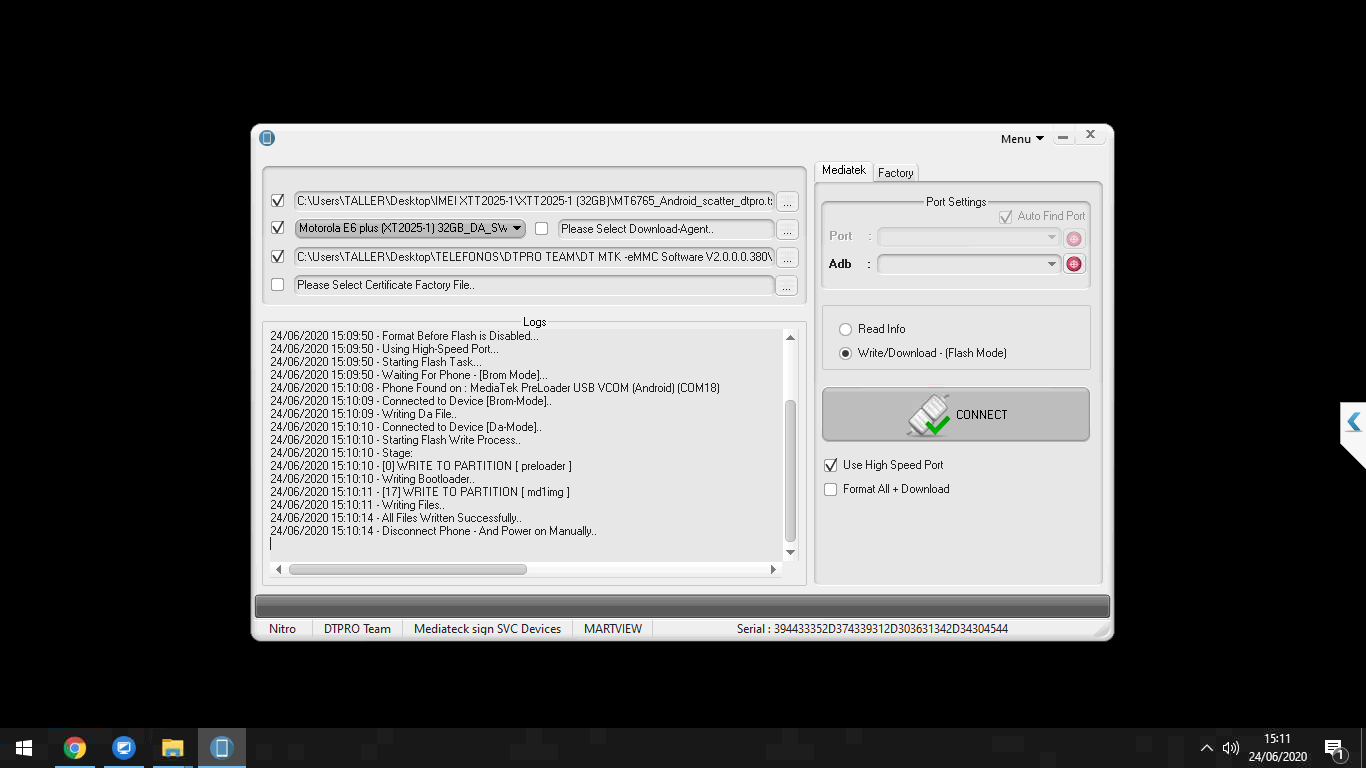

24/06/2020 15:09:49 - Loading Files...
24/06/2020 15:09:49 - Da File : C:\Users\TALLER\Desktop\TELEFONOS\DTPRO TEAM\DT MTK -eMMC Software V2.0.0.0.380\X-Agent\Motorola E6 plus (XT2025-1) 32GB_DA_SWSEC_1848_PTA29.162.bin
24/06/2020 15:09:49 - Checking File 0 [preloader].. ok
24/06/2020 15:09:50 - Checking File 17 [md1img].. ok
24/06/2020 15:09:50 - Chip : MT6765
24/06/2020 15:09:50 - Storage : EMMC
24/06/2020 15:09:50 - Format Before Flash is Disabled...
24/06/2020 15:09:50 - Using High-Speed Port...
24/06/2020 15:09:50 - Starting Flash Task...
24/06/2020 15:09:50 - Waiting For Phone - [Brom Mode]...
24/06/2020 15:10:08 - Phone Found on : MediaTek PreLoader USB VCOM (Android) (COM18)
24/06/2020 15:10:09 - Connected to Device [Brom-Mode]..
24/06/2020 15:10:09 - Writing Da File..
24/06/2020 15:10:10 - Connected to Device [Da-Mode]..
24/06/2020 15:10:10 - Starting Flash Write Process..
24/06/2020 15:10:10 - Stage:
24/06/2020 15:10:10 - [0] WRITE TO PARTITION [ preloader ]
24/06/2020 15:10:10 - Writing Bootloader..
24/06/2020 15:10:11 - [17] WRITE TO PARTITION [ md1img ]
24/06/2020 15:10:11 - Writing Files..
24/06/2020 15:10:14 - All Files Written Successfully..
24/06/2020 15:10:14 - Disconnect Phone - And Power on Manually..
