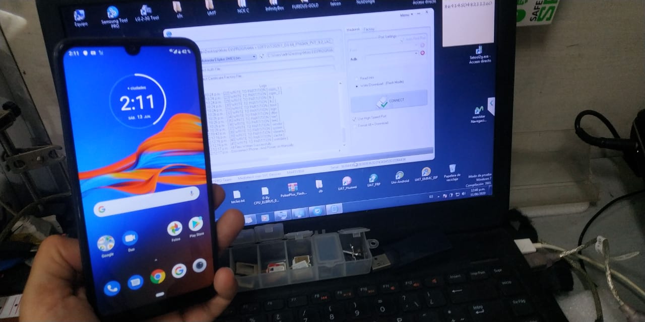

World First Motorola E6plus DownGrade for IMEI repair Success

11/06/2020 01:10:12 p.m. - Loading Files...
11/06/2020 01:10:13 p.m. - Da File : C:\Users\adn\Desktop\Moto E6\PROGRAMA + SOFT\XT2025-1_DS-64_P160AN_PVT_9.0_LA2_64B_CFC_191.01-01_FLASH_sign_SVC\DA_SWSEC_1848_PTB29.191.bin
11/06/2020 01:10:13 p.m. - Checking File 0 [preloader].. ok
11/06/2020 01:10:13 p.m. - Checking File 3 [recovery].. ok
11/06/2020 01:10:13 p.m. - Checking File 17 [signinfo].. ok
11/06/2020 01:10:13 p.m. - Checking File 18 [md1img].. ok
11/06/2020 01:10:13 p.m. - Checking File 19 [spmfw].. ok
11/06/2020 01:10:13 p.m. - Checking File 20 [scp1].. ok
11/06/2020 01:10:13 p.m. - Checking File 21 [scp2].. ok
11/06/2020 01:10:13 p.m. - Checking File 22 [sspm_1].. ok
11/06/2020 01:10:13 p.m. - Checking File 23 [sspm_2].. ok
11/06/2020 01:10:13 p.m. - Checking File 29 [lk].. ok
11/06/2020 01:10:13 p.m. - Checking File 30 [lk2].. ok
11/06/2020 01:10:13 p.m. - Checking File 31 [boot].. ok
11/06/2020 01:10:13 p.m. - Checking File 32 [logo].. ok
11/06/2020 01:10:13 p.m. - Checking File 34 [dtbo].. ok
11/06/2020 01:10:13 p.m. - Checking File 35 [tee1].. ok
11/06/2020 01:10:13 p.m. - Checking File 36 [tee2].. ok
11/06/2020 01:10:13 p.m. - Checking File 37 [vendor].. ok
11/06/2020 01:10:13 p.m. - Checking File 38 [system].. ok
11/06/2020 01:10:13 p.m. - Checking File 39 [vbmeta].. ok
11/06/2020 01:10:13 p.m. - Checking File 40 [cache].. ok
11/06/2020 01:10:13 p.m. - Checking File 41 [userdata].. ok
11/06/2020 01:10:13 p.m. - Chip : MT6765
11/06/2020 01:10:13 p.m. - Storage : EMMC
11/06/2020 01:10:13 p.m. - Format Before Flash is Disabled...
11/06/2020 01:10:13 p.m. - Using High-Speed Port...
11/06/2020 01:10:13 p.m. - Starting Flash Task...
11/06/2020 01:10:13 p.m. - Waiting For Phone - [Brom Mode]...
11/06/2020 01:10:17 p.m. - Phone Found on : MediaTek PreLoader USB VCOM (Android) (COM6)
11/06/2020 01:10:17 p.m. - Connected to Device [Brom-Mode]..
11/06/2020 01:10:17 p.m. - Writing Da File..
11/06/2020 01:10:18 p.m. - Connected to Device [Da-Mode]..
11/06/2020 01:10:19 p.m. - Starting Flash Write Process..
11/06/2020 01:10:19 p.m. - Stage:
11/06/2020 01:10:19 p.m. - [0] WRITE TO PARTITION [ preloader ]
11/06/2020 01:10:19 p.m. - Writing Bootloader..
11/06/2020 01:10:19 p.m. - [3] WRITE TO PARTITION [ recovery ]
11/06/2020 01:10:19 p.m. - Writing Files..
11/06/2020 01:10:21 p.m. - [17] WRITE TO PARTITION [ signinfo ]
11/06/2020 01:10:21 p.m. - [18] WRITE TO PARTITION [ md1img ]
11/06/2020 01:10:24 p.m. - [19] WRITE TO PARTITION [ spmfw ]
11/06/2020 01:10:24 p.m. - [20] WRITE TO PARTITION [ scp1 ]
11/06/2020 01:10:24 p.m. - [21] WRITE TO PARTITION [ scp2 ]
11/06/2020 01:10:24 p.m. - [22] WRITE TO PARTITION [ sspm_1 ]
11/06/2020 01:10:24 p.m. - [23] WRITE TO PARTITION [ sspm_2 ]
11/06/2020 01:10:24 p.m. - [29] WRITE TO PARTITION [ lk ]
11/06/2020 01:10:24 p.m. - [30] WRITE TO PARTITION [ lk2 ]
11/06/2020 01:10:24 p.m. - [31] WRITE TO PARTITION [ boot ]
11/06/2020 01:10:26 p.m. - [32] WRITE TO PARTITION [ logo ]
11/06/2020 01:10:26 p.m. - [34] WRITE TO PARTITION [ dtbo ]
11/06/2020 01:10:26 p.m. - [35] WRITE TO PARTITION [ tee1 ]
11/06/2020 01:10:26 p.m. - [36] WRITE TO PARTITION [ tee2 ]
11/06/2020 01:10:26 p.m. - [37] WRITE TO PARTITION [ vendor ]
11/06/2020 12:10:43 p.m. - [38] WRITE TO PARTITION [ system ]
11/06/2020 12:12:16 p.m. - [39] WRITE TO PARTITION [ vbmeta ]
11/06/2020 12:12:16 p.m. - [40] WRITE TO PARTITION [ cache ]
11/06/2020 12:12:16 p.m. - [41] WRITE TO PARTITION [ userdata ]
11/06/2020 12:12:17 p.m. - All Files Written Successfully..
11/06/2020 12:12:17 p.m. - Disconnect Phone - And Power on Manually..
