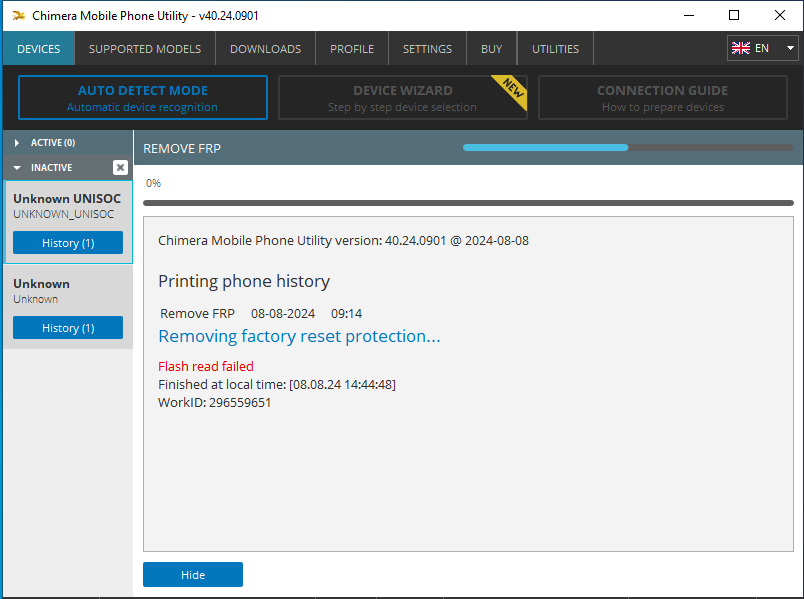

after i read info show this
Chimera Mobile Phone Utility version: 40.24.0901 @ 2024-08-08
Removing factory reset protection...
Flash read failed
Finished at local time: [08.08.24 14:44:34]

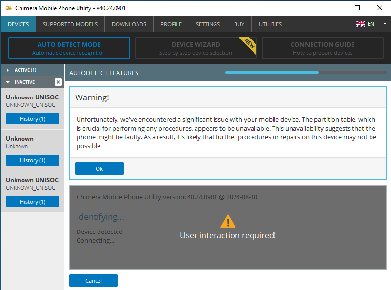

Dear User,
Try to press and hold the power + volume up/down buttons for a prolonged period while connecting the device to ChimeraTool, and see if it can connect in bootrom mode again.
If that doesn't work you can also try to disconnect and then reconnect the battery, or remove the battery completely, and insert it into another phone to charge it, then put it back into the original G14 and see if it can boot up.
