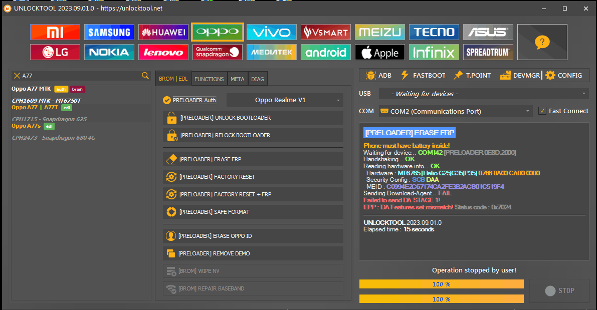

today in my shop come oppo a77 cph2385 with FRP Lock so i am trying frp ock remove with unlock tool but every times this error coming:
Sending Download -Agent... FAIL
Failed To Send DA STAGE 1!
EPP:DA Featues Set Mismatch! Status Code:0x7024
So Please Solve My Problem & In Next Update Of Unlock Tool Please ADD This Model For Remove FRP Lock,Write Flash Read Pattern Lock Etc Work

bro i was check in UnlockTool-2023-09-02-0 but this model not was in List Oppo A77 CPH2385 But now this mobile Return to Customer But Today 04.09.2023 unlock tool team by Release new setup UnlockTool_2023.09.03.3 but this model add only name with Oppo A77 4G but MY mobile was Oppo A77 CPH2385

Bro First you check
In New update Oppo A77 CPH2385 not in List

I'm having a similar problem with my Techno Spark 7P - KF7J, unlocktool displays DA features mismatch when I try to use the Techno 2023 MTK Preloader to enter brom. Can anyone help me solve my issue?
I flashed firmware V529 which automatically has the security patch update to 2023 and blocks BROM. I then flashed a downgraded preloader from an extracted firmware with V373 via fastboot and BROM was working fine and also rooted the phone.
I later tried to have a complete have a complete flash to remove root and relock bootloader so I selected format all + download in SP Flash Tool and the process failed with the preloader. The phone isn't powering on anymore and the port displays MediaTek Preloader USB Vcom when I plug it to my laptop.
I have researched on the internet for possible test points but have found none for Techno KF7J, is there any other way to flash the phone?
