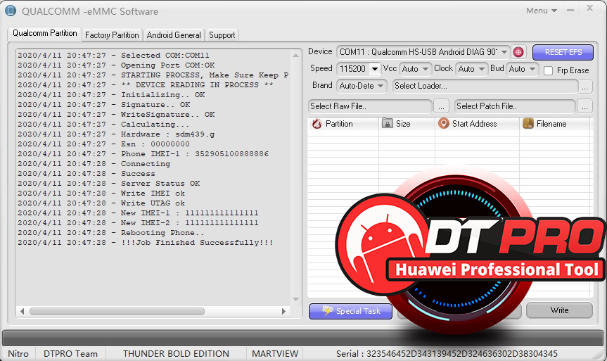

Nokia 4.2 TA-1149 IMEI repair Success (Just One click)
DTPRO Tool
Sep 3, 2018
5,247
4,866
nico_2202
2020/4/11 20:47:27 - Selected COM:COM11
2020/4/11 20:47:27 - Opening Port COM:OK
2020/4/11 20:47:27 - STARTING PROCESS, Make Sure Keep Phone Screen UNLOCKED!!
2020/4/11 20:47:27 - * DEVICE READING IN PROCESS *
2020/4/11 20:47:27 - Initializing.. OK
2020/4/11 20:47:27 - Signature.. OK
2020/4/11 20:47:27 - WriteSignature.. OK
2020/4/11 20:47:27 - Calculating...
2020/4/11 20:47:27 - Hardware : sdm439.g
2020/4/11 20:47:27 - Esn : 00000000
2020/4/11 20:47:27 - Phone IMEI-1 : 352905100888886
2020/4/11 20:47:28 - Connecting
2020/4/11 20:47:28 - Success
2020/4/11 20:47:28 - Server Status OK
2020/4/11 20:47:28 - Write IMEI ok
2020/4/11 20:47:28 - Write UTAG ok
2020/4/11 20:47:28 - New IMEI-1 : 111111111111111
2020/4/11 20:47:28 - New IMEI-2 : 111111111111111
2020/4/11 20:47:28 - Rebooting Phone..
2020/4/11 20:47:28 - !!!Job Finished Successfully!!!

how to enable diag port plz explain

go to android general tab activate developer options on the computer activate usb debugging give the red dot to choose android composite then identify and finally enable diag checkbox
Hi, i try enable diagport , and , no enable diag port

Steps to Enable Or Disable Diag Mode on Qualcomm device
A. Dial Number
  • Open the phone dialer app and type ##717717## to enable.
Now, you have Enabled Or Disabled Diag Mode on Qualcomm device. If this does not work, then try the second method.
B. Terminal Emulator App (APK) to Enable Or Disable Diag Mode on Qualcomm device
  • Your phone should be Rooted first for the second method.
  • Install Terminal Emulator Apk on your phone.
  • Connect the device to the computer.
  • Enable USB Debugging on your handset via the Developer Options.
  • Now, open the terminal emulator.
  • Type the following command and press enter:
su
  • Then type another command below and hit enter to apply:
setprop sys.usb.config diag,adb
  • Done. You’ve Enabled Or Disabled Diag Mode on Qualcomm device.
C. ADB Command Method (Recommended)
  • Root access is required.
  • Enable USB Debugging on your phone from Developer Options.
  • Next, connect your device to the computer.
  • Open Minimal ADB and Fastboot command prompt on your PC.
  • Type the following commands and hit enter one by one to apply:
adb devices
adb shell
su
Reactions: everecu

Only run::: open bootloader method--
enable usb debbuf..
connect wifi
enable oem
open terminal so minimal fastboot and type
fastboot oem unlok
Mr coders Dtpro fix solution:
No is possible repair imei
No is possible enable Diag

this methos is tested 100% for all our customers!!
Unlock Bootloader (Xtool Module)
Root with Magisk
Enable diag (emm-sofware Module)
IMEI repair (emmc-software)
Bootloader
Enable Diag + IMEI repair
covvvva
Feb 20, 2020
3
Hi.. my problem is solved Thanks to Dt pro support Colombia :) (Julio G. Torralvo)..
