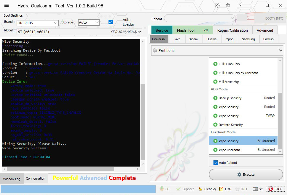

Oneplus 6T (A6010, A6013) Wipe Security done with fastboot mode by Hydra Tooll
1. Run Hydra Qualcomm Tool.
2. Choose Brand and Module.
3. Go to "Service"--> "Universal"
4. Choose "Partition" from drop down menu.
5. Choose "Wipe security" from fastboot mode.
6. Choose "Auto Reboot" if you want to rebbot the device after operation.
6. Click on "Execute"
7. Connect cellphone with computer using usb data cable.
8. Wait until the operation is completed.
