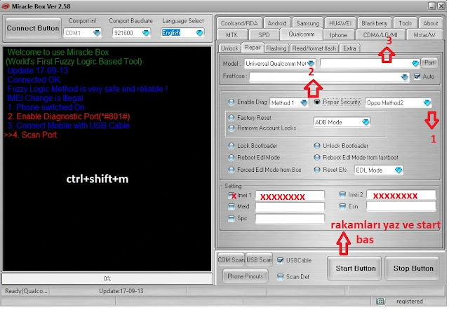

Dial *#801# or *#8011# and click the tab at the top (Diag port will open)
Do Repair both Security with Umt or Hydra Tool or if you have Miracle Box
Click on the qualcomm option in the Miracle box and enter the repair section belowDetails are in the picture

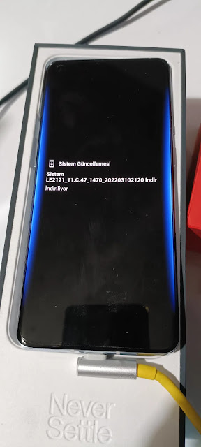

Phone Restart *#06# and confirm If the process is OK, update the software with ota Update2 times until latest version
