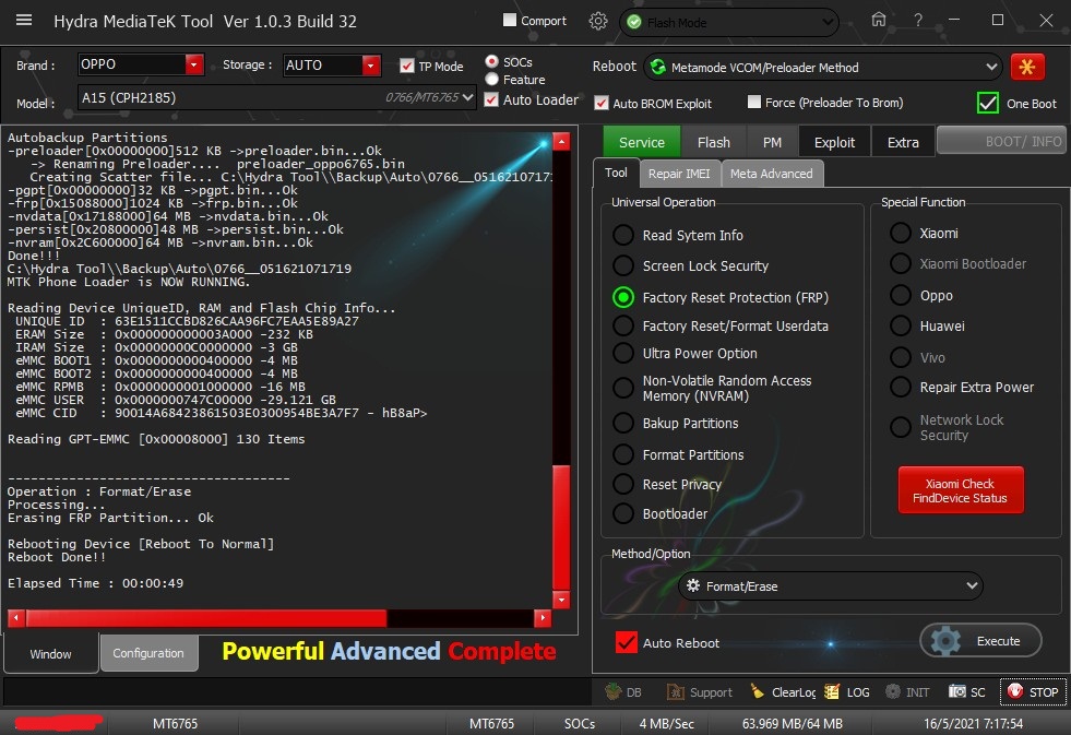

Hydra Oppo A15 CPH 2185 Factory Reset Protection (FRP) successfully removed by Hydra Tool
549
Oppo A15 CPH 2185 Factory Reset Protection (FRP) successfully removed by Hydra Tool​
1. Run MTK Tool and choose "Sosc"
2. Choose Brand and Module.
3. Go to "Service"--> "Tool" from Universal Option
4. Choose "Factory Reset Protection (FRP)"
5. Choose "Format / Erase" from "Method / Option" drop down menu.
6. Connect device to computer using USB Data Cable.
7. Wait until the operation is completed
Screen Shorts
Oppo-A15-CPH-2185-Factory-Reset-Protection-FRP-successfully-removed-by-Hydra-Tool.jpg
Logs
FriendlyName :MediaTek USB Port (COM29)
Device :6&df2ee03&0&2
SymbolicName :\??\USB#VID_0E8D&PID_0003#6&df2ee03&0&2#{a5dcbf10-6530-11d2-901f-00c04fb951ed}
Handshaking...Ok
Identifying Hardware ID.....
Reading Device hardware info..
hw code : 0766MT6765 [6765]
hw subcode : 8A00
hw version : CA00
sw version : 0000
Target config : E5
SB : 01 (True)
SLA : 00 (False)
DAA : 04 (True)
Exploiting Device...
Successfully Exploited...
Handshaking...Ok
hw subcode : 8A00
hw version : CA00
sw version : 0000
Target config : 00
SB : 00 (False)
SLA : 00 (False)
DAA : 00 (False)
FUSEID : 00000000
SECURE VERSION : 00
BL VERSION : FE
NORMAL BOOT
Preparing Download Agent..
DA : [Not Exist]
Trying Default 6765.bin
Ver : MTK_AllInOne_DA_v3.3001.2020-11-03.22:07_536568
Init : Loader [1]
Sending : Accepted
Identifying Protocol...
Protocol : New
Synchronization...SYNC
Mode : brom
Preloader Initialization...
Parsing A15s_preloader_oppo6765.bin
Init : Accepted
Execute Secondary Loader
Init : Loader [2]
Executing : SYNC
UNIQUE ID : 63E1511CCBD826CAA96FC7EAA5E89A27
ERAM Size : 0x000000000003A000 -232 KB
eMMC CID : 90014A68423861503E0300954BE3A7F7 - hB8aP>
DA Speed : high-speed
Autobackup Partitions
-> Renaming Preloader.... preloader_oppo6765.bin
Creating Scatter file... C:\Hydra Tool\\Backup\Auto\0766__051621071719\MT6765_Android_scatter.txt
-frp[0x15088000]1024 KB ->frp.bin...Ok
-nvdata[0x17188000]64 MB ->nvdata.bin...Ok
-persist[0x20800000]48 MB ->persist.bin...Ok
-nvram[0x2C600000]64 MB ->nvram.bin...Ok
Done!!!
Operation : Format/Erase
Processing...
Erasing FRP Partition... Ok
Reboot Done!!
Elapsed Time : 00:00:49
Reactions: FAROK
