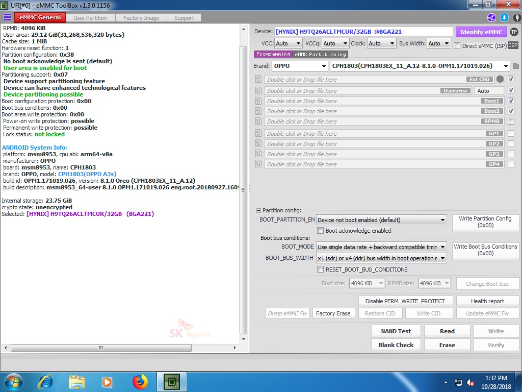

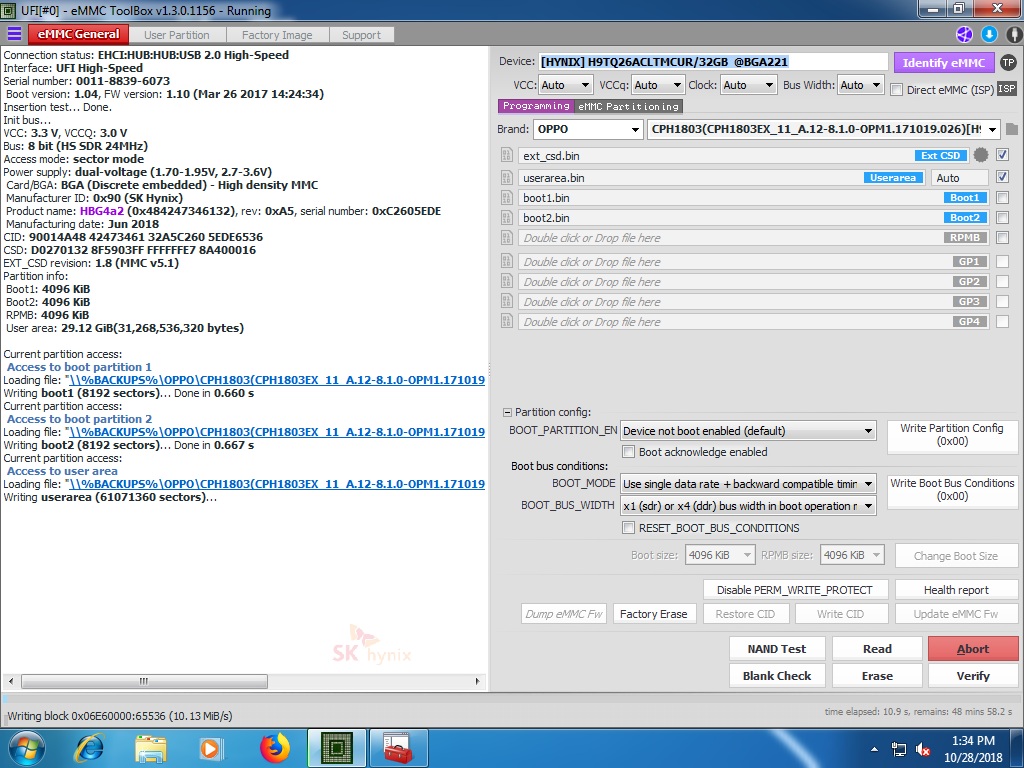

OPPO A3S DEAD 9008 PORT RECOVERED SUCCESSFULLY.

OPPO A3S
THOSE WHO HAVE BRICKED THEIR PHONES CAN ALSO FOLLOW SAME TO RECOVER .
TRIED ONLINE FLASHING BUT HANG LOGO.
BEST REGARDS
DELHI EMMC GROUP
