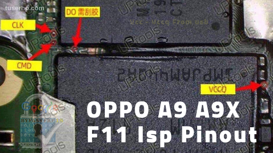

OPPO F11 DEAD AFTER FORMAT WITH UFI
Only MTK Port Show... And There Is No CLK Resister For Remove And Sort It Please Help Me
HERE IS LOG!

there is only 4 test point
no shorting...
