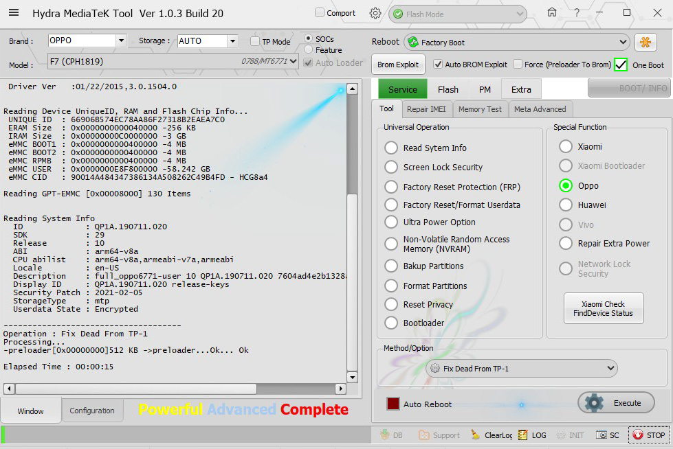

Oppo F7 (CPH1819) Fix Dead from TP 1 successfuly done by Hydra Tool
1. Run Hydra MTK Module,
2. Select Brand and Model
3. Go to Service-->Tools-->Oppo
4. Choose "Fixed Dead from TP 1" from Method / Option
5. Execute and connect the device to the computer
6. wait until the process is completed.
FriendlyName :MediaTek USB Port_V1632 (COM15)
SymbolicName :\??\USB#VID_0E8D&PID_0003#6&129ddb08&0&2#{a5dcbf10-6530-11d2-901f-00c04fb951ed}
UNIQUE ID : 66906B574EC78AA86F27318B2EAEA7C0
eMMC CID : 90014A484347386134A508262C49B4FD - HCG8a4
Reading System Info
SDK : 29
Release : 10
ABI : arm64-v8a
Locale : en-US
Description : full_oppo6771-user 10 QP1A.190711.020 7604ad4e2b1328a1 release-keys
Display ID : QP1A.190711.020 release-keys
Security Patch : 2021-02-05
StorageType : mtp
Userdata State : Encrypted
Operation : Fix Dead From TP-1
Processing...
-preloader[0x00000000]512 KB ->preloader...Ok... Ok
Elapsed Time : 00:00:15
