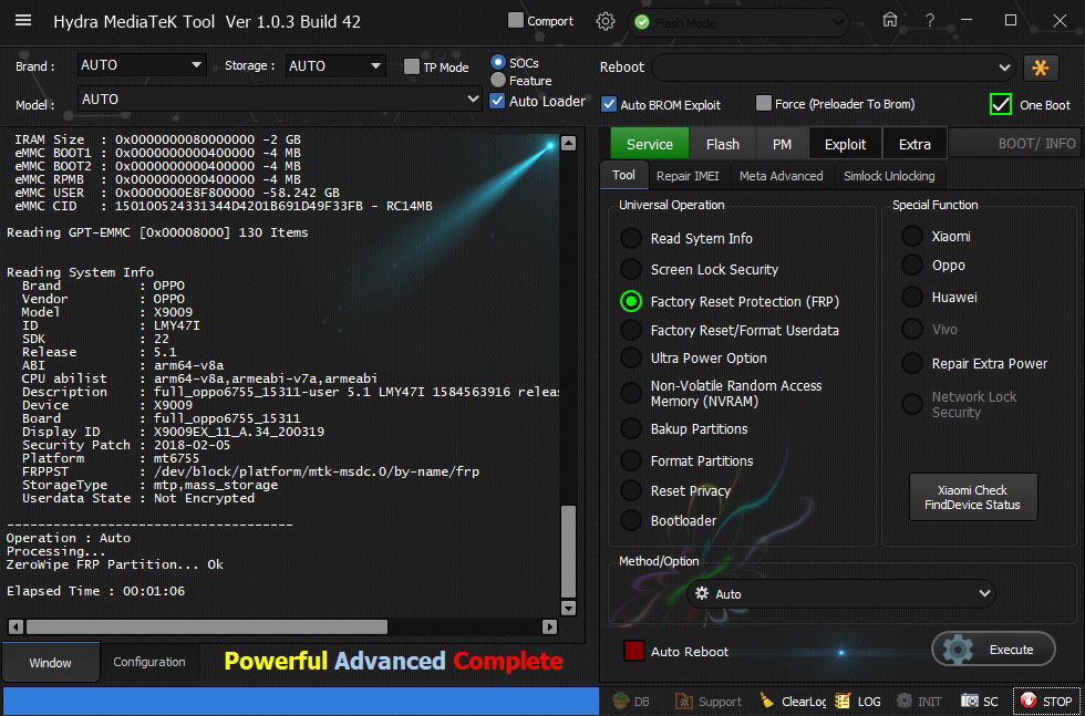

Hydra Oppo X9009 (F1 Plus) removing FRP partition successfully done by Hydra Tool
550
1. Run MTK Tool and choose "Sosc"
2. Choose Brand and Module as "Auto"
3. Go to "Service"--> "Tool" from Universal Option
4. Choose "Factory Reset Protection (FRP)"
5. Choose "Auto" from "Method / Option" drop down menu.
6. Connect device to computer using USB Data Cable.
7. Wait until the operation is completed
FriendlyName :MediaTek USB Port_V1632 (COM9)
Device :5&1d6c0649&0&4
SymbolicName :\??\USB#VID_0E8D&PID_0003#5&1d6c0649&0&4#{a5dcbf10-6530-11d2-901f-00c04fb951ed}
Handshaking...Ok
Identifying Hardware ID.....
Reading Device hardware info..
hw code : 0326MT6750T [6755]
hw subcode : 8A00
hw version : CB00
sw version : 0001
Target config : 01
SB : 01 (True)
SLA : 00 (False)
DAA : 00 (False)
Exploiting Device...
Exploit Sent..
Successfully Exploited...
Handshaking...Ok
hw subcode : 8A00
hw version : CB00
sw version : 0001
Target config : 00
SB : 00 (False)
SLA : 00 (False)
DAA : 00 (False)
FUSEID : 02000000
SECURE VERSION : 05
BL VERSION : FE
NORMAL BOOT
Preparing Download Agent..
DA : 6755_SWSEC_D36514C0DE.bin
Ver : MTK_AllInOne_DA_v3.3001.00.00
Init : Loader [1]
Sending : Accepted
Identifying Protocol...
Protocol : New
Synchronization...SYNC
Mode : brom
Preloader Initialization...
Parsing F1S_preloader_oppo6750_15131.bin
Init : Accepted
Execute Secondary Loader
Init : Loader [2]
Executing : SYNC
UNIQUE ID : 0461C3537043FF63ED41E450606DD69A
IRAM Size : 0x0000000080000000 -2 GB
eMMC CID : 150100524331344D4201B691D49F33FB - RC14MB
DA Speed :
Change to HIGH SPEED...
Port Identification :DA_HIGHSPEED_VCOM
FriendlyName :MediaTek DA USB VCOM (Android) (COM25)
Device :5&1ba1e768&0&4
SymbolicName :\??\USB#VID_0E8D&PID_2001#5&1ba1e768&0&4#{a5dcbf10-6530-11d2-901f-00c04fb951ed}
Reading System Info
Brand : OPPO
Vendor : OPPO
Model : X9009
SDK : 22
Release : 5.1
ABI : arm64-v8a
Description : full_oppo6755_15311-user 5.1 LMY47I 1584563916 release-keys
Device : X9009
Board : full_oppo6755_15311
Display ID : X9009EX_11_A.34_200319
Security Patch : 2018-02-05
Platform : mt6755
FRPPST : /dev/block/platform/mtk-msdc.0/by-name/frp
StorageType : mtp,mass_storage
Autobackup Partitions
-> Renaming Preloader.... preloader_oppo6755_15111.bin
Creating Scatter file... C:\Hydra Tool\\Backup\Auto\0326__053021110655\MT6750T_Android_scatter.txt
-frp[0x03F88000]1024 KB ->frp.bin...Ok
-nvdata[0x04088000]32 MB ->nvdata.bin...Ok
-protect1[0x08088000]8 MB ->protect1.bin...Ok
-protect2[0x08888000]15.469 MB ->protect2.bin...Ok
-nvram[0x0CF00000]5 MB ->nvram.bin...Ok
Done!!!
Reading System Info
Brand : OPPO
Vendor : OPPO
Model : X9009
SDK : 22
Release : 5.1
ABI : arm64-v8a
Device : X9009
Platform : mt6755
Operation : Auto
Processing...
ZeroWipe FRP Partition... Ok
Elapsed Time : 00:01:06
