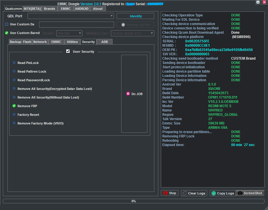

remove frp xiaomi redmi note 5 8.1.0 miui10 done
[url=https://www.0zz0.com][/URL]
Checking Operation Type         DONE
Waiting For EDL Device        DONE
Checking device communication    DONE
Device connection is being verified    DONE
Checking Qcom Boot Download Agent    Done
Checking device platform         (MSM8996)
SERIAL :    0x002D5755FE
MSMID  :    0x00000CC0E1
OEM PK :    0xa7b8b82545a98eca23d6e9105fb46456
SW VER :    0x0000000003
Checking send bootloader method    CUSTEM Brand
Sending device bootloader        DONE
Start protocol initialization        DONE
Loading device partition table    DONE
Loading Device Information        DONE
Parsing Device Information        DONE
Android Ver        8.1.0
Brand        XIAOMI
Build Date        1545642673
Build Number        OPM1.171019.011
Inc Ver        V10.2.1.0.OEIMIXM
Model        REDMI NOTE 5
Name        WHYRED
Region        WHYRED_GLOBAL
Sdk Version        27
Emmc Size        59639 MB
Type        ARM64-V8A
Preparing to erase partitions...     DONE
Removing FRP Lock        DONE
Rebooting             DONE
Elapsed time:             00 min  27 sec

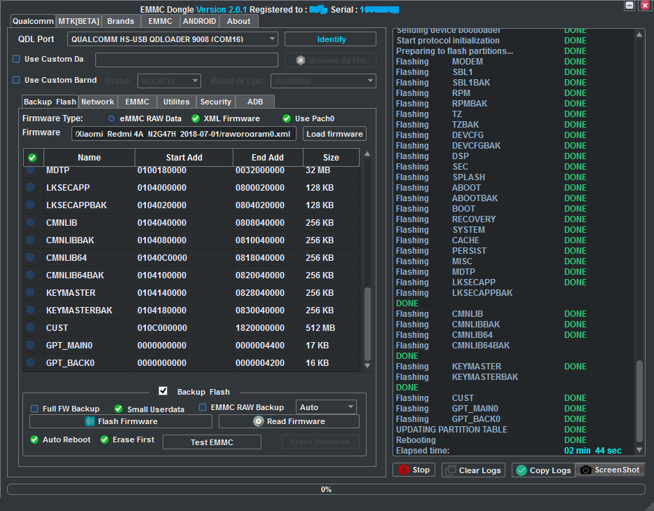

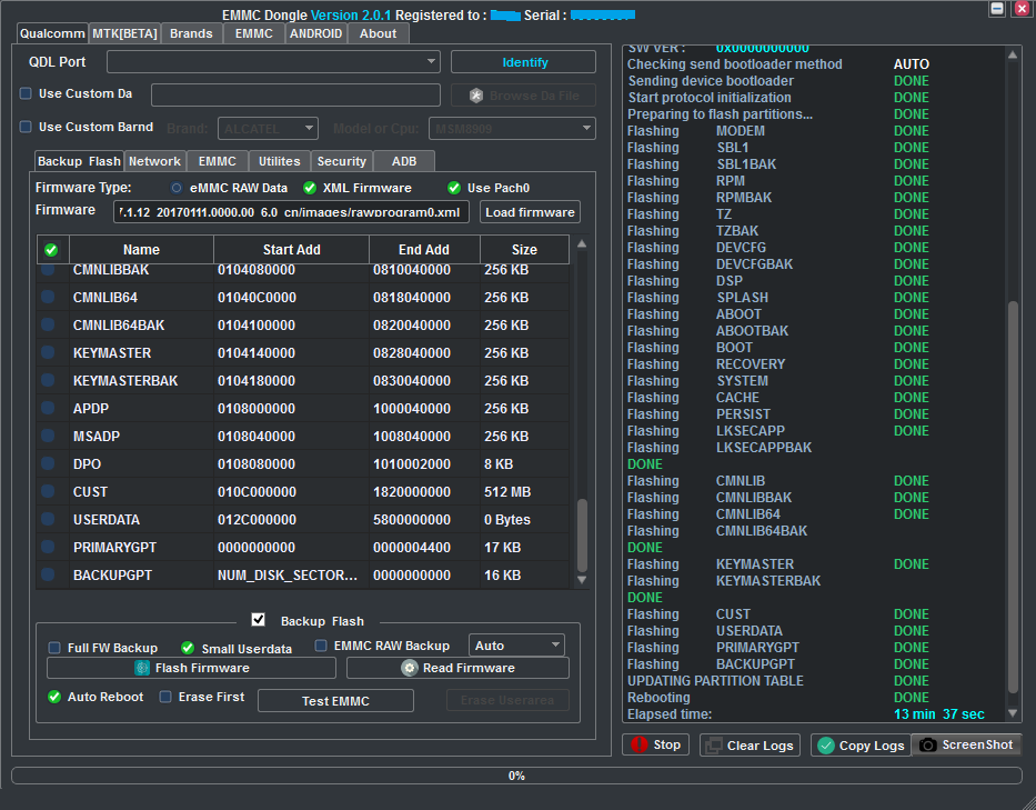

WRITE FIRMWARE DONE XIAOMI REDMI 4A
Checking FW Type         DONE
Checking firmware file        DONE
Loading device partition table...     DONE
Checking Patch0 file        DONE
Loading device information...     DONE
Android Ver        6.0.1
Brand        XIAOMI
Build Date        1484071338
Build Number        MMB29M
Inc Ver        7.1.12
Model        REDMI 4A
Name        ROLEX
Sdk Version        23
Platform        MSM8937
Ram Capacity        2048 MB
Type        ARM64-V8A
Checking device platform         (MSM8917)
SERIAL :    0x00BD31D2B1
MSMID  :    0x00000560E1
OEM PK :    0x57158eaf1814d78fd2b3105ece4db18a
SW VER :    0x0000000000
Checking send bootloader method    AUTO
Preparing to flash partitions...     DONE
Flashing     MODEM        DONE
Flashing     SBL1        DONE
Flashing     SBL1BAK        DONE
Flashing     RPM        DONE
Flashing     RPMBAK        DONE
Flashing     TZ        DONE
Flashing     TZBAK        DONE
Flashing     DEVCFG        DONE
Flashing     DEVCFGBAK        DONE
Flashing     DSP        DONE
Flashing     SPLASH        DONE
Flashing     ABOOT        DONE
Flashing     ABOOTBAK        DONE
Flashing     BOOT        DONE
Flashing     RECOVERY        DONE
Flashing     SYSTEM        DONE
Flashing     CACHE        DONE
Flashing     PERSIST        DONE
Flashing     LKSECAPP        DONE
Flashing     LKSECAPPBAK        DONE
Flashing     CMNLIB        DONE
Flashing     CMNLIBBAK        DONE
Flashing     CMNLIB64        DONE
Flashing     CMNLIB64BAK        DONE
Flashing     KEYMASTER        DONE
Flashing     KEYMASTERBAK        DONE
Flashing     CUST        DONE
Flashing     USERDATA        DONE
Flashing     PRIMARYGPT        DONE
Flashing     BACKUPGPT        DONE
UPDATING PARTITION TABLE        DONE
Rebooting             DONE
Elapsed time:             13 min  37 sec

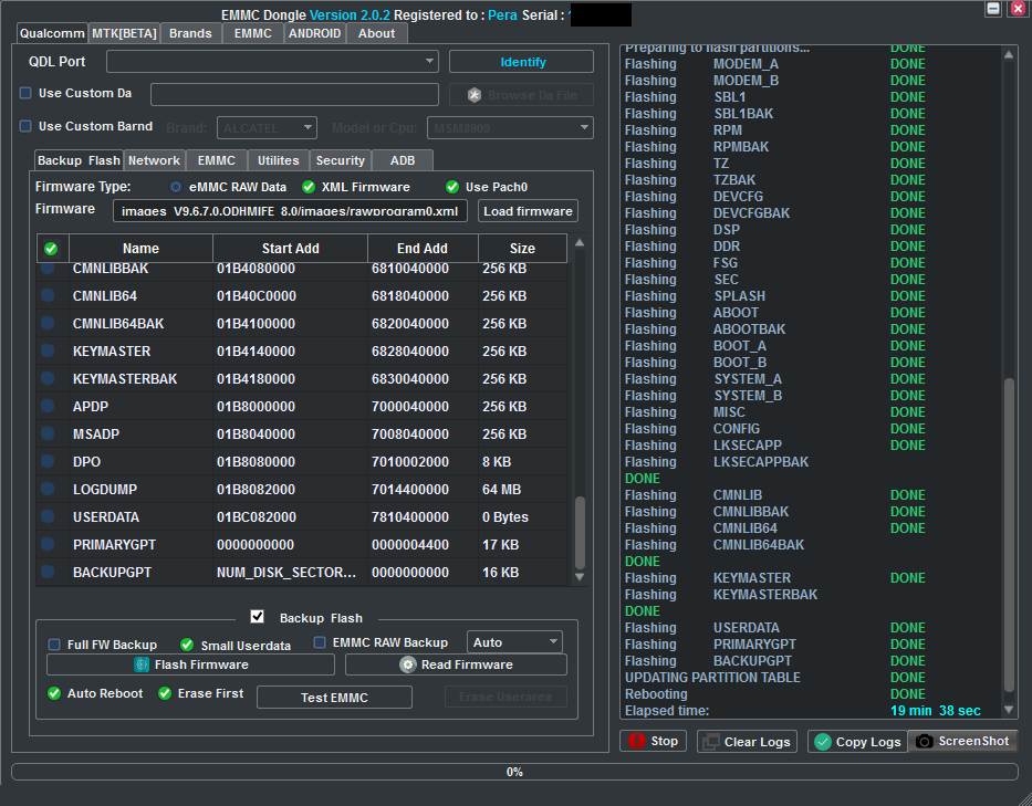

WRITE FIRMWARE DONE XIAOMI MI A1
Backup & Flash Instructions
●● Supported Interfaces                 ● Qualcomm Hs Usb QDloader 9008
How to Backup Firmware
 ● Connect device in EDL Mode
 ● Click Identify Button
 ● wait until Load Partition table and device Information
 ● check Full Fw Backup if you want to Read Full Partitions
 ● and uncheck if you want to Read Ordinary Firmware
 ● check small userdata  if you want to Read Formatted userdata small data file) to save time file size start from 30MB to max 200MB
 ● check Emmc Raw Data backup if you want to Read Dump
 ● then click Read Firmware button
How to Flash Firmware
 ● choose appropriate firmware file
 ● then click Flash Firmware button
Note : no need to click Identify Button for Flash
if failed to send BOOTLOADER then you need to USE Custem DA AGENT or change to custem barnd method
●● Supported Firmwares                 ● Qualcomm XML firmwares
 ● Qualcomm Emmc Raw Data Files (Dump)
 ● Huawei Qualcomm Update.app files
Checking device platform         (MSM8953)
SERIAL :    0x00621754C5
MSMID  :    0x00000460E1
Flashing     MODEM_A        DONE
Flashing     MODEM_B        DONE
Flashing     SBL1        DONE
Flashing     RPM        DONE
Flashing     TZ        DONE
Flashing     TZBAK        DONE
Flashing     DSP        DONE
Flashing     DDR        DONE
Flashing     FSG        DONE
Flashing     SEC        DONE
Flashing     ABOOT        DONE
Flashing     BOOT_A        DONE
Flashing     BOOT_B        DONE
Flashing     SYSTEM_A        DONE
Flashing     SYSTEM_B        DONE
Flashing     MISC        DONE
Flashing     CONFIG        DONE
Rebooting             DONE
Elapsed time:             19 min  38 sec

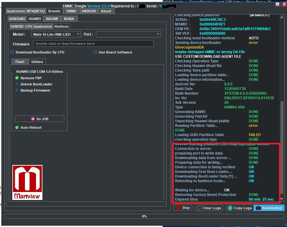

Remove FRP Huawei Mate 10 Lite (RNE-L23) huawei usb com 1.0
Connection to server        DONE
preparing port to write data        DONE
Downloading data from server ...    DONE
Preparing data for writing...        DONE
Device connection is being verified    OK
Downloading First Boot-Loader....    OK
Downloading BootLoader Data [1] ...    OK
Rebooting to fastboot mode...    OK
Waiting for device...     OK
Removing Factory Reset Protection    DONE
Elapsed time:             00 min  25 sec
