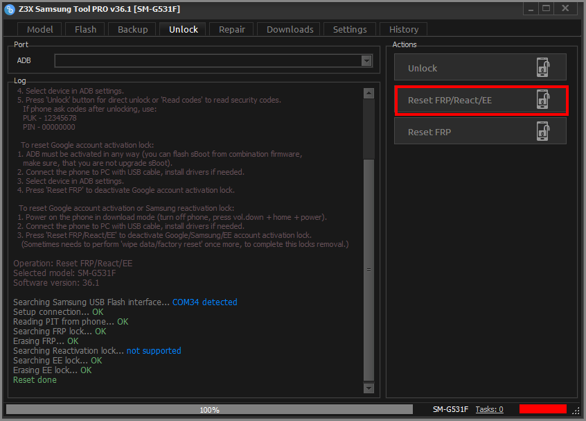

Operation: Reset FRP/React/EE
Selected model: SM-G531H/DS
Software version: 31.0
Searching Samsung USB Flash interface... COM146 detected
Setup connection... OK
Reading PIT from phone... OK
Searching FRP lock... OK
Erasing FRP... OK
Searching Reactivation lock... not supported
Searching EE lock... OK
Erasing EE lock... OK
Reset done
Done with Samsung Tool PRO v.31.0

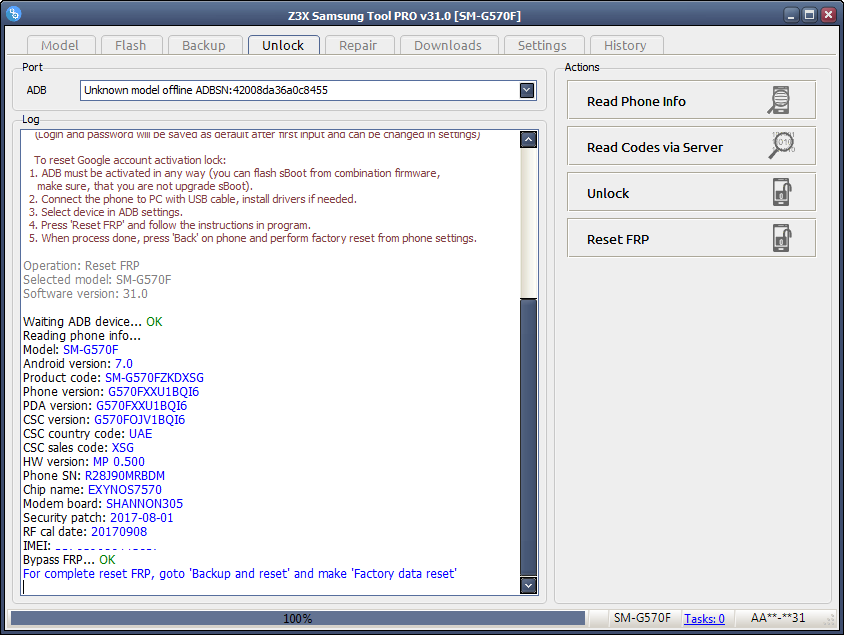

Selected model: SM-J210F
Erasing FRP lock... OK
Reset done
For complete reset FRP, goto 'Backup and reset' and make 'Factory data reset'

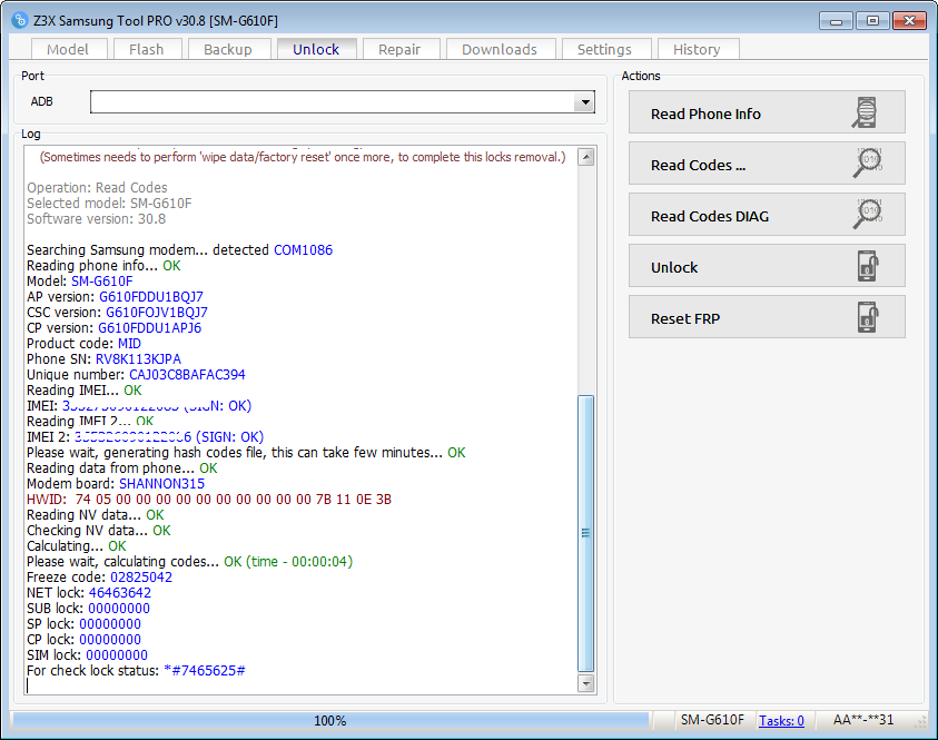

Samsung E1190 Unlock Z3x
Selected model: E1190
Selected com port: COM22
Selected speed port: 921600
Please, connect phone and press power button 3 seconds
Phone Detected
Sending loader1... OK
Flash ID: 7A
Sending loader2... OK
Please wait for patching firmware...
Already patched SW
Phone Detected
Use automatic parameters
Phone in TAT MODE
Phone master IMEI: 00000000000000
Phone slave IMEI: 00000000000000
Phone SW: E1190BOLA1
Phone CSC: E1190TMPKH1
Phone BT ADDR: 0000-00-000000
Phone SN: R21D66QQG4
Deactivated MSL - TRUE
[FREZEE]: 00000000
[NET Lock]: 00000000
[Subset Lock]: 00000000
[SP Lock]: 00000000
[CP Lock]: 00000000
[Sim Lock]: 00000000
[Phone Lock]: 00000000
Read info - ok
Elapsed time: 35 second, sw ver: 3.5.0040

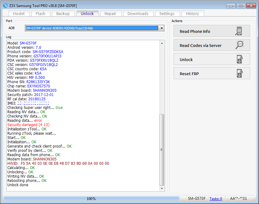

Operation: Repair
Selected model: SM-G925T
Software version: 29.4
If you are looking for 'Repair Network' function then you should use 'Patch Certificate'
Waiting ADB device... OK
Reading phone info...
Model: SM-G925T
Android version: 7.0
Product code:
Phone version: G925TUVS6FRA3
PDA version: G925TUVS6FRA3
CSC version: G925TTMB6FRA3
CSC country code: USA
CSC sales code: TMB
HW version:
Phone SN: 00000000000
Chip name: EXYNOS7420
Modem board: SHANNON333
Security patch: 2018-01-01
RF cal date:
IMEI: 350000000000006
Checking Super user right... true
Reading NV data... OK
Checking NV data... OK
Initialization zTool... OK
Running zTool, please wait... OK
HWID: 08 43 3D 76 D5 06 00 00 00 00 00 00 00 00 00 00
Calculating... OK
Repairing... OK
Writing NV data... OK
Rebooting phone... OK
Repair done
Done with Samsung Tool PRO v.29.4
