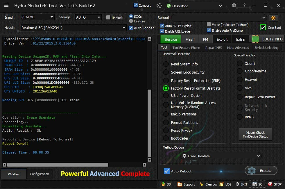

Realme 8 5G (RMX2341) Demo successfully removed by Hydra Tool
This Operation goes Flash Mode with COM Port
1. Run Hydra MTK module and choose "SOSC".
2. Tick "COM Port" at the TOP
2. Choose Brand and Module
3. Tick "Auto Loader", "Auto Broom Exploit" and "Enable UBL Loader"
4. Tick "Enable Auto Pre DUMP"
5. Go to "Service" -->"Tool" Tab.
6. Choose "Read System Info"
Note: This function tells you this device completely supports or not.
7. connect device to the computer with USB Data cable with Flash Mode
8. Wait until Hydra shows you all information on the screen.
9. choose "Factory Reset / Format User Data"
10. Choose "Erase user data" from "Method / Option"
11. Tick "Auto Reboot"
12. Click "Execute"
13. connect device to the computer with USB Data cable with Flash Mode
14. Wait until the process is completed.
