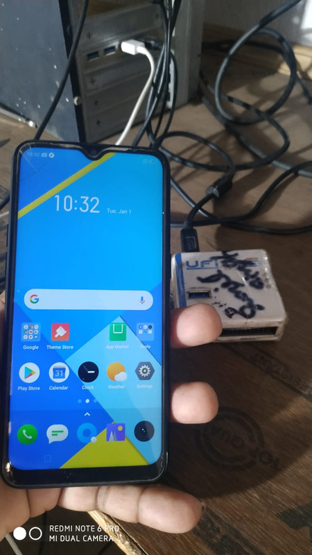

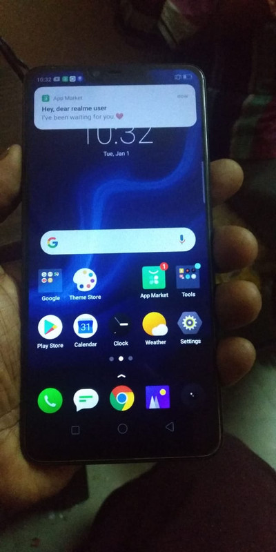

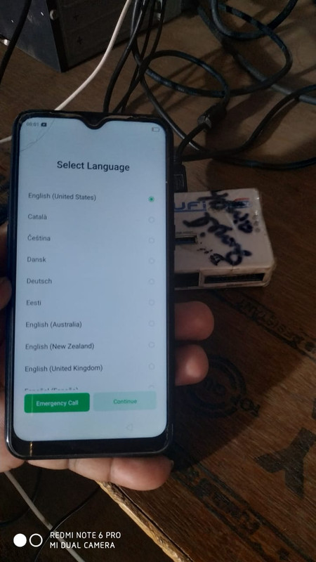

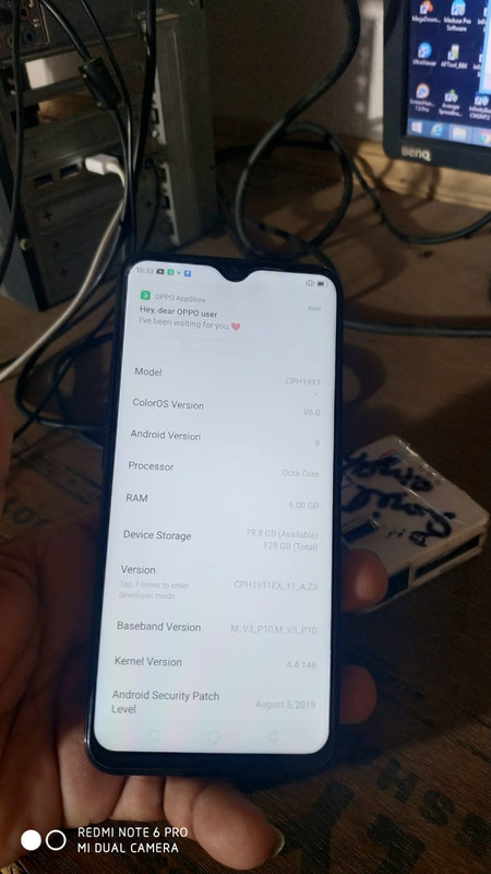

TODAY ANOTHER REAL ME PATTERN AND FRP SUCCESS BY UFI BOX 1.4.0.1502

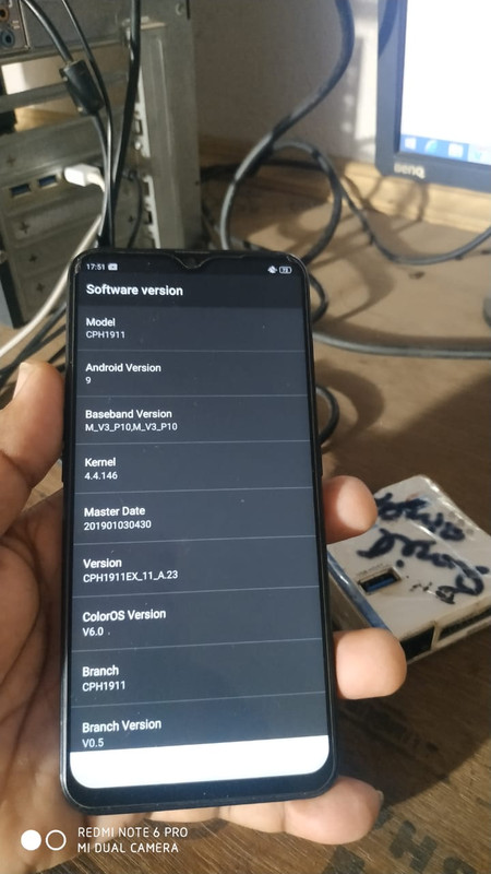

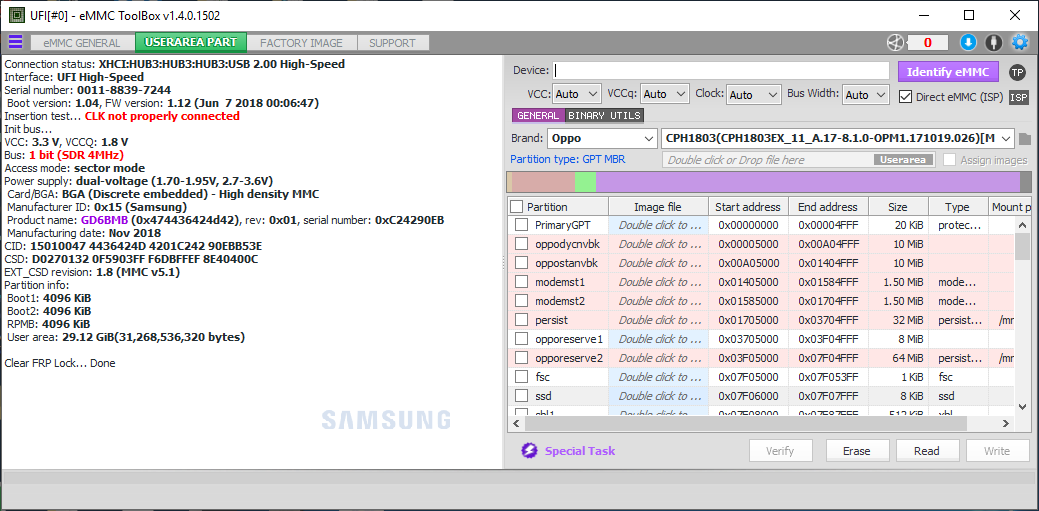

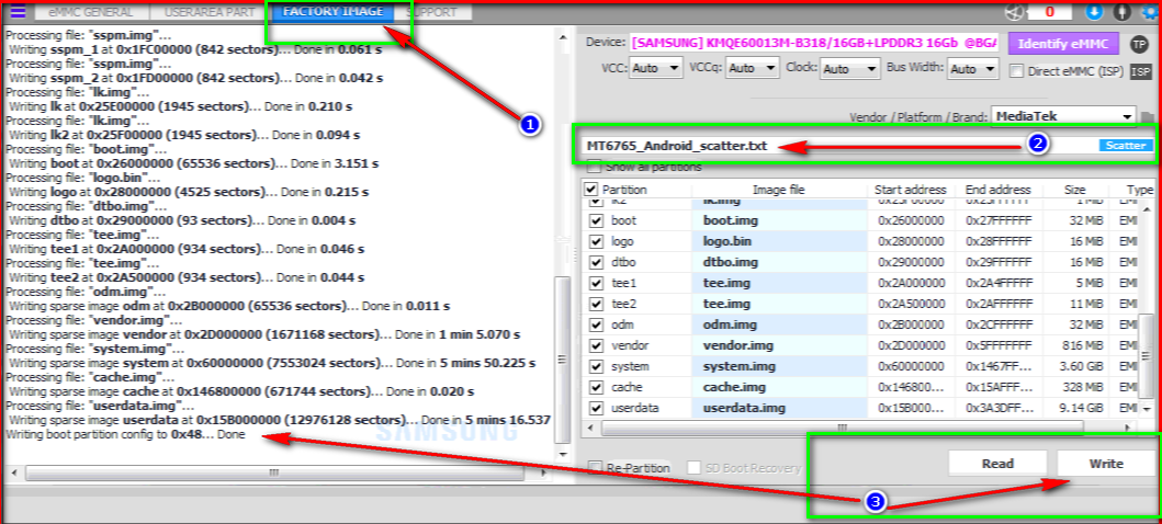

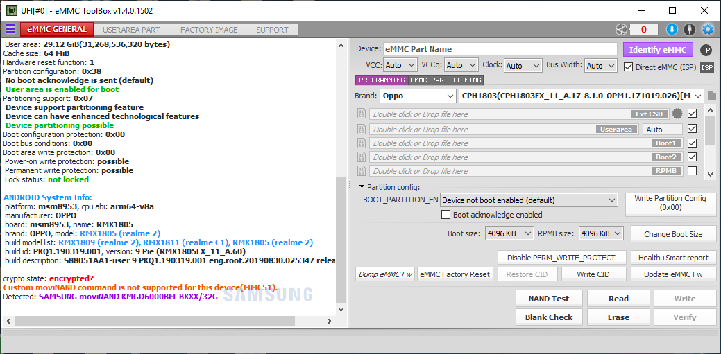

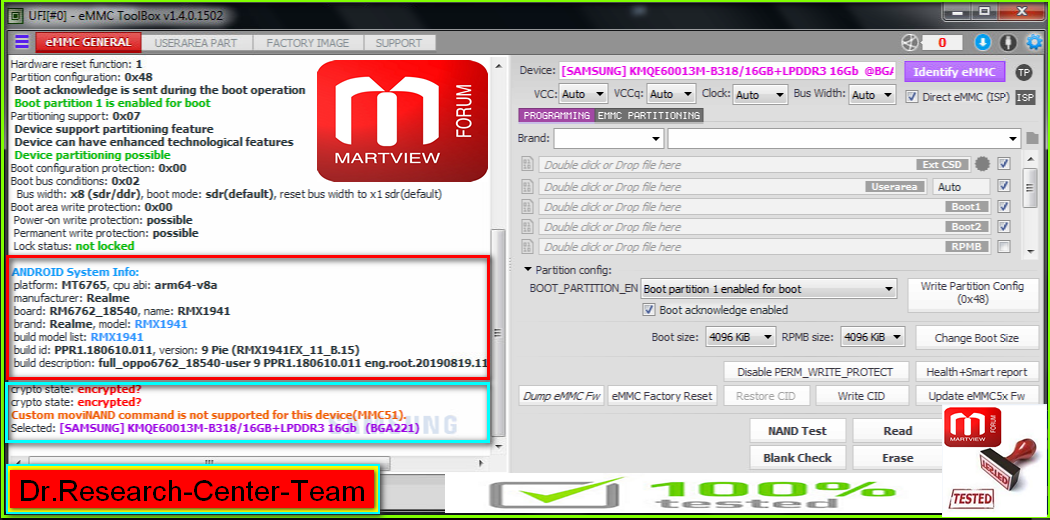

Realme C2 ( RMX1941 / RMX1945 ) Dead By Other Technician Total EMMC Erase Successfully Recovered Handset By Offline Flashing With UFI-BOX
OG FLASH TOOL TRY
Dr.Research-Center-Team
please tell us how to recover rmx1945 dead after format by ufi . its been 15 days that my handset is dead , customer is giving me so much pain , please help , only making mtk port

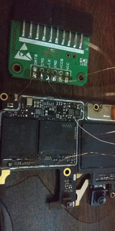

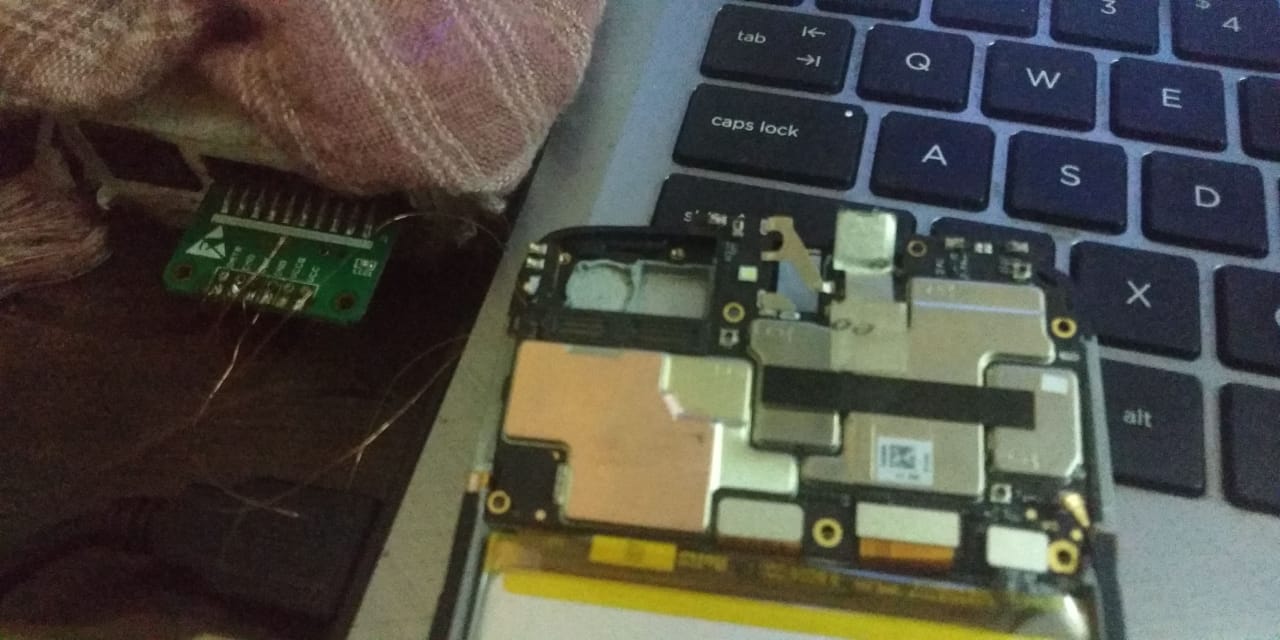

i also have real me c2 rmx 1945 dead while unlock try to flash after remove emmc with ufi but no sucess please help.showing unencrypted.
there is not support from ufi team what so ever , they dont even care if your handset is dead , i think its waste of buying ufi anybody intersted in nbuying ufi one month old please pm , i should move to another Jtag where supporter should help

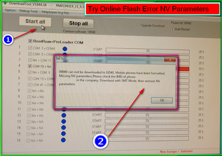

Bro I already flash msm tool mean online flashing. But imei 0 not solve I paide 700
Online flashing not solve bro any other solution I have bill box everything also have ufi esay jatg plus or Medusa pro
Solution bro
Solution bro
Modem 1 backup he
Maybe you ufi is your first jtag box
Every box has it own bugs
Jtag is all about hardware small bugs can make ur phone not boot again error maybe on your PCB not box
Check CMD clk racistor it may break
And if it's break it will loss connectivity b/w emmc and CPU
So the box will detect ur emmc but CPU can't
