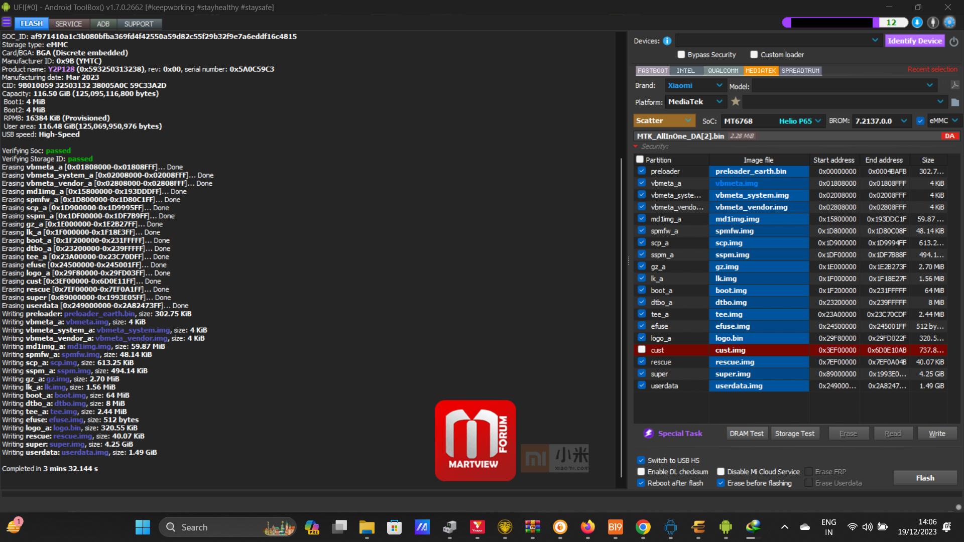

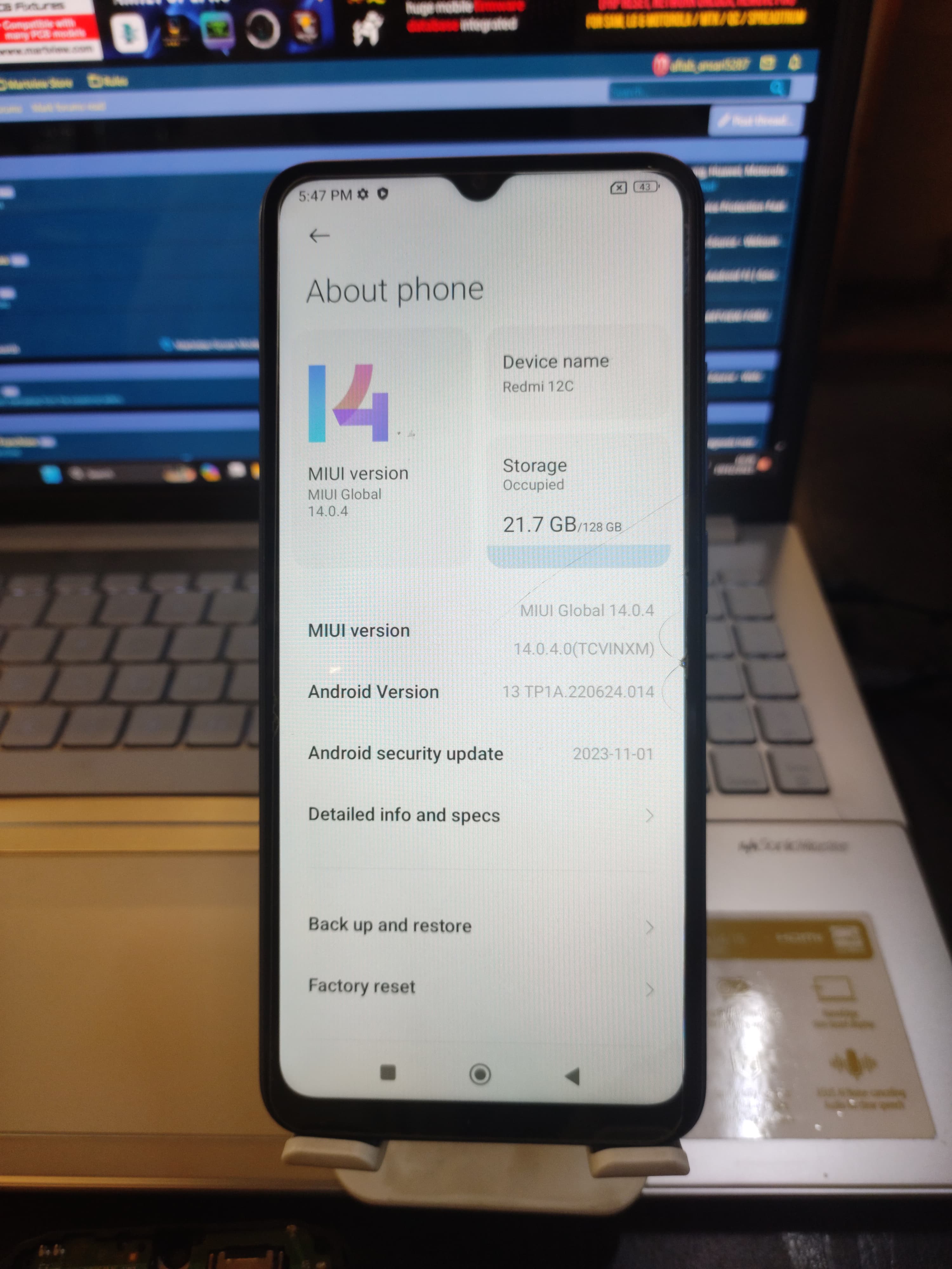

Its RSA Protected device so First Thing is to Chnage this Resistance in 10k ohm.​
Someone had already destroyed the system in this device, so I have erased it with UFI and fully flashed it.​

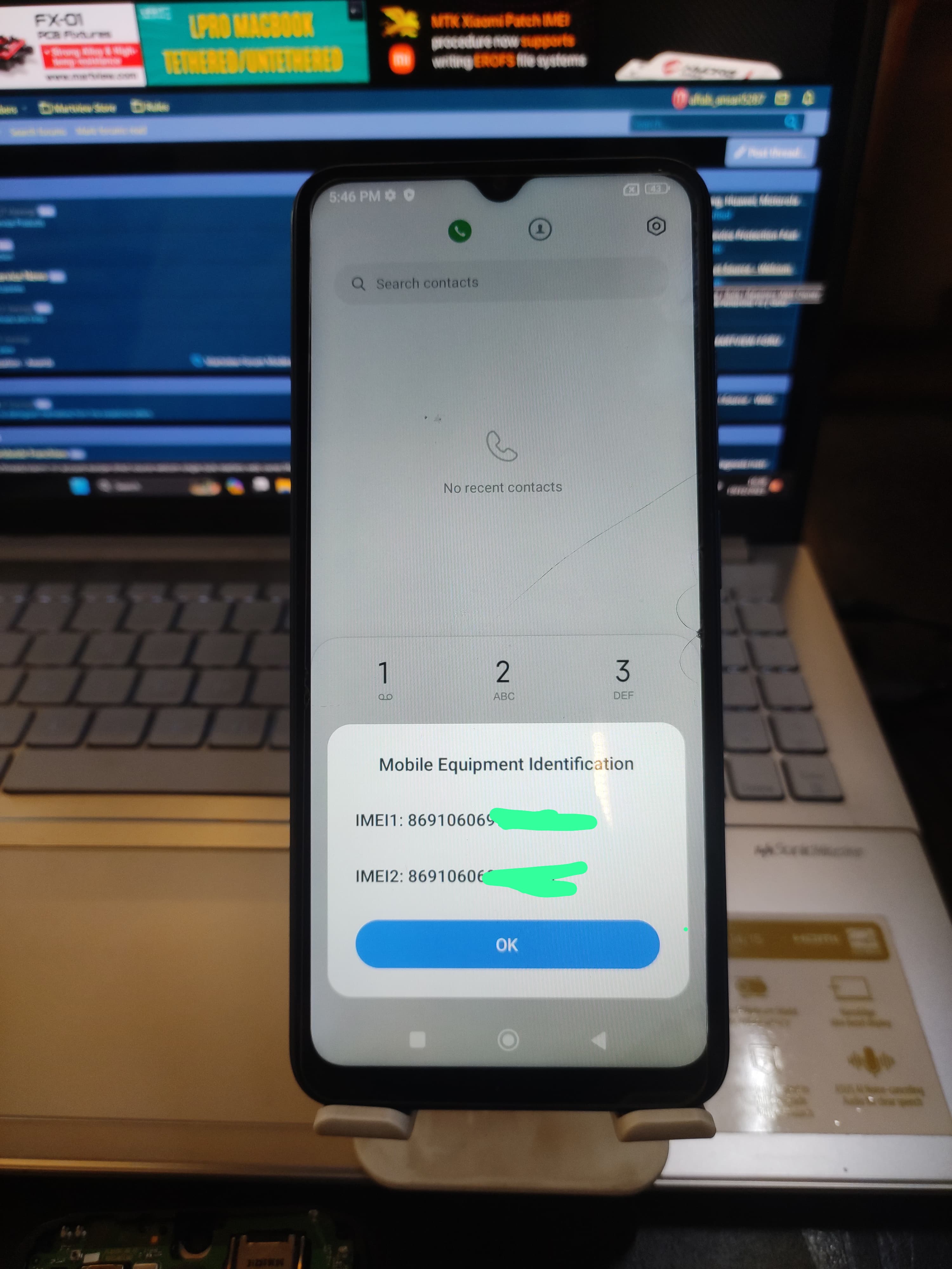

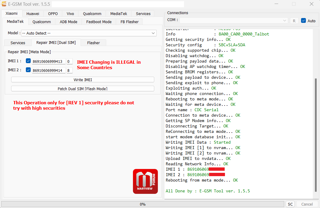

After doing all this its baseband became unknown and imei became null. Then we repaired its baseband. To repair its baseband, we erased its security part.​
After that its imei has been repaired.​
Job Done​

Bro This we did not do And it doesn't even matter. We selected the Scatter file on UFI and UFI automatically deselected it.

You can repair imei using hardware method. You can check by flashing this file earth_global_images_V13.0.5.0.SCVMIXM_20230310.0000.00_12.0_global_596373c569
