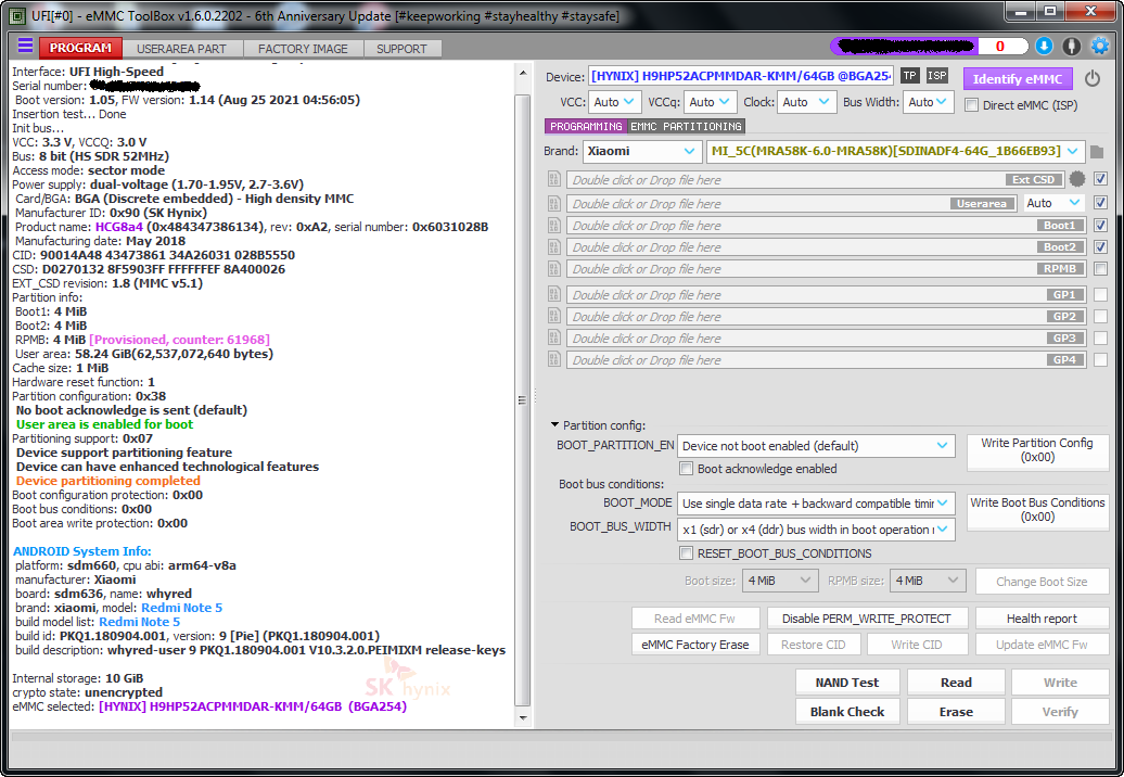

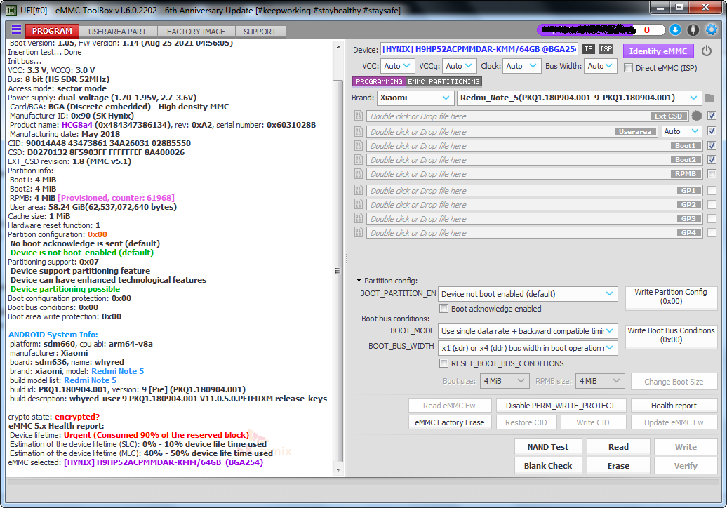

hello everyone I Am New User Of UFI Box & Redmi Note 5 Hang On LOGO So Please Help Me so i am sharing some report so please help me
CONNECT SUCCESSFULLY & Health Report :
So Please help me & solve my problem
Note:what will my next work for solve this problem please tell me

Take a Backup Of Dump File In 1GB. then identify eMMC & go to the userarea part then take the backup of security data.
identify eMMC again.We have told the next steps through image.
After all this is completed. you re-identify emmc.Now you can write the dump file and the security file in userarea part.Now you go to Factory Image tab and now you flash the official stock firmware.Do emmc identify again. And now factory reset.
identify eMMC again & post screen shot here.

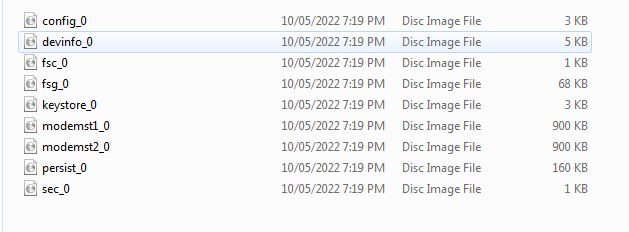

can you tell me which security files take backup
please Sir

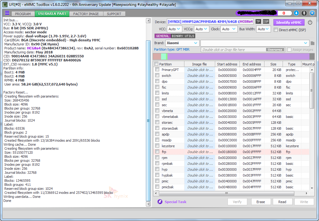

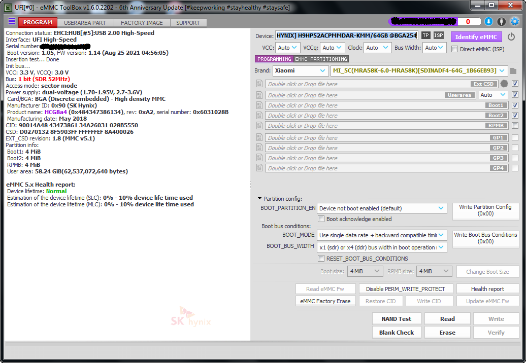

Sir all process done so please Check & tell me all OK if not ok please tell me :
identify eMMC:
Health Report:
identify eMMC:
Health Report:
factory reset once

factory reset also done & again identify eMMC :
please Check & tell me all OK if not ok what will my next work for solve this problem please tell me
