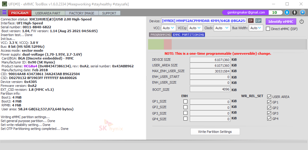

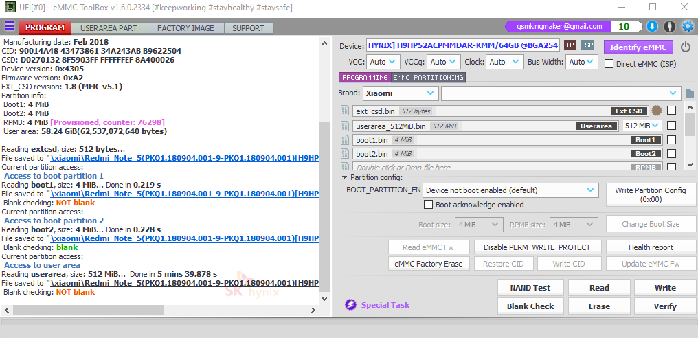

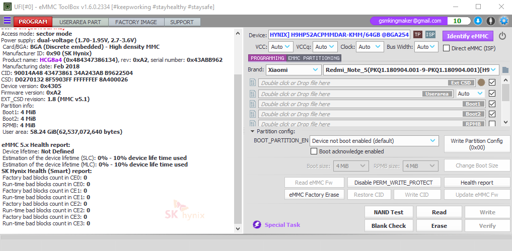

Connection status: XHCI:HUB3[#3]:USB 2.00 High-Speed
Interface: UFI High-Speed
Serial number: 0011-8840-6822
Boot version: 1.04, FW version: 1.14 (Aug 25 2021 04:56:05)
Insertion test... Done
Init bus...
VCC: 3.3 V, VCCQ: 3.0 V
Bus: 8 bit (HS SDR 52MHz)
Access mode: sector mode
Manufacturer ID: 0x90 (SK Hynix)
Product name: HCG8a4 (0x484347386134), rev: 0xA2, serial number: 0x43ABB962
Manufacturing date: Feb 2018
CID: 90014A48 43473861 34A243AB B9622504
CSD: D0270132 8F5903FF FFFFFFEF 8A400026
Device version: 0x4305
Firmware version: 0xA2
EXT_CSD revision: 1.8 (MMC v5.1)
Partition info:
Boot1: 4 MiB
Boot2: 4 MiB
RPMB: 4 MiB [Provisioned, counter: 76298]
User area: 58.24 GiB(62,537,072,640 bytes)
Cache size: 1 MiB
Hardware reset function: 1
Secure Feature support: 0x55
Partition configuration: 0x00
No boot acknowledge is sent (default)
Device is not boot-enabled (default)
Partitioning support: 0x07
Device support partitioning feature
Device can have enhanced technological features
Device partitioning possible
Boot configuration protection: 0x00
Boot bus conditions: 0x00
Boot area write protection: 0x00
ANDROID System Info:
platform: sdm660, cpu abi: arm64-v8a
manufacturer: Xiaomi
board: sdm636, name: whyred
brand: xiaomi, model: Redmi Note 5
build id: PKQ1.180904.001, version: 9 [Pie] (PKQ1.180904.001)
build description: whyred-user 9 PKQ1.180904.001 V11.0.5.0.PEIMIXM release-keys
crypto state: encrypted?
EXT_CSD backup saved to "\HCG8a4_43ABB962.ext_csd"
eMMC selected: [HYNIX] H9HP52ACPMMDAR-KMM/64GB (BGA254)
