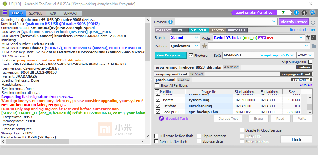

Scanning for Qualcomm HS-USB QDLoader 9008 device...
Download Port: Qualcomm HS-USB QDLoader 9008 (COM2)
Connection status: XHCI:HUB3[#2]:USB 2.00 High-Speed
USB Device: [Qualcomm CDMA Technologies MSM] QUSB__BULK
USB Driver: [Network Connect] bmusbser, version: 3.0.0.0, date: 2-5-2018
Initializing...
MSM Serial number: 0xb760c10b
MSM HW ID: 0x000ba0e1 (SDM632), OEM ID: 0x0072 (Xiaomi), MODEL ID: 0x0000
OEM Public Key Hash: 57158eaf1814d78fd2b3105ece4db18a817a08ac664a5782a925f3ff8403d39a
SBL SW version: 1
Firehose: prog_emmc_firehose_8953_ddr.mbn
hash: 7867a9f9e60b7ebcc90645a95c9375850e4c9b08, size: 434.86 KiB
oem version: c5-miui-ota-bd18.bj
qc version: BOOT.BF.3.3.2-00053
variant: JAADANAZA
Loading firehose... Done
Handshaking...
Sending ping... Done
Sending configurations...
Requesting flash signature from server...
Warning: low system memory detected, please consider upgrading your system !
First authentication failed, retrying ...
ERROR: Only nop and sig tag can be recevied before authentication.
[SERVER] XIAOMI_FL [onc_in,b760c10b] ref id: XF06598806632, cost: 3, your balance: 7
TargetName: 8953
MemoryName: eMMC
Version: 1
Firehose configured.
Storage type: eMMC
Manufacturer ID: 0x90 (SK Hynix)
Product name: hB8aP (0x68423861503e), rev: 0x30, serial number: 0x07389CFD
Capacity: 29.13 GiB (31,281,119,232 bytes)
Boot1: 4 MiB
Boot2: 4 MiB
RPMB: 4 MiB
User area: 29.12 GiB(31,268,536,320 bytes)

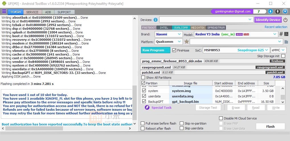

Processing rawprogram0.xml
Writing PrimaryGPT at 0x00000000 (34 sectors)... Done
Writing config at 0x00028000 (64 sectors)... Done
Writing lksecapp at 0x00040000 (113 sectors)... Done
Writing lksecappbak at 0x00060000 (113 sectors)... Done
Writing devcfg at 0x00080000 (80 sectors)... Done
Writing devcfgbak at 0x000C0000 (80 sectors)... Done
Writing rpm at 0x00180000 (342 sectors)... Done
Writing rpmbak at 0x00200000 (342 sectors)... Done
Writing misc at 0x00400000 (16 sectors)... Done
Writing sbl1 at 0x00600000 (885 sectors)... Done
Writing sbl1bak at 0x00700000 (885 sectors)... Done
Writing cmnlib at 0x00800000 (402 sectors)... Done
Writing cmnlibbak at 0x00900000 (402 sectors)... Done
Writing cmnlib64 at 0x00A00000 (518 sectors)... Done
Writing cmnlib64bak at 0x00B00000 (518 sectors)... Done
Writing keymaster at 0x00C00000 (625 sectors)... Done
Writing keymasterbak at 0x00D00000 (625 sectors)... Done
Writing aboot at 0x00E00000 (1509 sectors)... Done
Writing abootbak at 0x01000000 (1509 sectors)... Done
Writing tz at 0x01400000 (2992 sectors)... Done
Writing tzbak at 0x01800000 (2992 sectors)... Done
Writing dsp at 0x04000000 (32768 sectors)... Done
Writing splash at 0x06000000 (1004 sectors)... Done
Writing boot at 0x18000000 (131072 sectors)... Done
Writing recovery at 0x1C000000 (131072 sectors)... Done
Writing modem at 0x20000000 (180224 sectors)... Done
Writing dtbo at 0x27700000 (16384 sectors)... Done
Writing vbmeta at 0x27F00000 (8 sectors)... Done
Writing cache at 0x30000000 (241 sectors)... Done
Writing cust at 0x50000000 (260945 sectors)... Done
Writing vendor at 0x84000000 (1898601 sectors)... Done
Writing system at 0xC4000000 (6922762 sectors)... Done
Writing userdata at 0x1A4000000 (104929 sectors)... Done
Writing BackupGPT at NUM_DISK_SECTORS-33. (33 sectors)... Done
Applying DISK patch... Done
Flashing completed in 3 mins 7.281 s
You have used 1 out of 10 slot for today.
You have used 1 available XIAOMI_FL slot for this phone, you have 2 try left to try again in case this task fails.
Please pay attention to the error messages and spesific hints before retry !!!
You are paying for authorization access and NOT the task, there is no refund for failed tasks and tasks with 3 retry
Refunds are only for failed tasks because of server issues, software issues or bugs and unknown problem with no retry !!!
You may retry the task for more times without further authorization as long as you don't unplug the USB cable.
Boot authorization has been reported successfully.To keep the boot state authorized, DO NOT unplug the USB cable, change brand/model selection or closing the applicat
