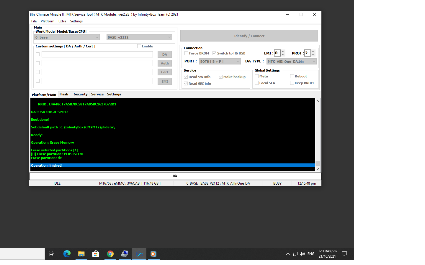

Operation : Erase Memory
Erase selected partitions [1]
[0] Erase partition : PERSISTENT
Erase partition Ok!
Operation finished!

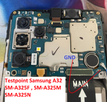

1st of all open your mobile and find the test ponit like see my post 2nd open cm2mt2 2.28 and identify your mobile and connect test point and pluge usb cable then again cm2 tab and goto Extra tab and read memory
Turn off your Samsung mobile Samsung A32 (A325F A325F/D A325M)
Remove the back cover
Unplug the battery
Open CM2 MT2.exe
Click on Identify / Connect
Short-test the test points and connect the usb cable.
Wait a moment
After reading, disconnect the Samsung a32 mobile
Then
Click on extra , it will open the CM2 memory tool (Emmc).
Click on Init Device
Short test points and connect the usb cable
Wait a few seconds to fully initialize the cm2 phone.
Scroll down and find "PERSISTENT".
Highlight (CHECK) PERSISTENTON and expand the
Right click on RD : FILE : c:/xxxxxxxxxx
And read selected (for backup)
After successful backup
Right-click again on RD : FILE : c:/xxxxxxxxxx and click Wipe Selected.
A "Apop up message " will appear on the screen.
Click "YES".
Wait until the process is complete
After success, unplug the Samsung a32 from the wall outlet, connect the battery and turn it on.
Congratulations, the Samsung a32 lock has been removed.
