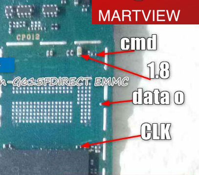

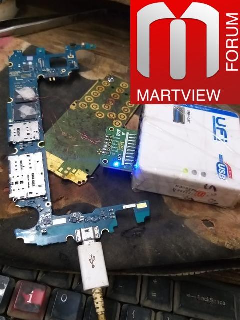

Samsung J7 Max[G615F] Dead Mtk Port Set Alive Sucessfully
Got Water Damage Handset Fully Dead
1St Reboll Power Ic Now Set Come In Dead Port MTK USB Port
Dead MTK Port
G615 ISP PINOUT
CONNECT WITH ISP PINOUT

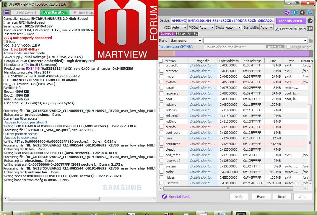

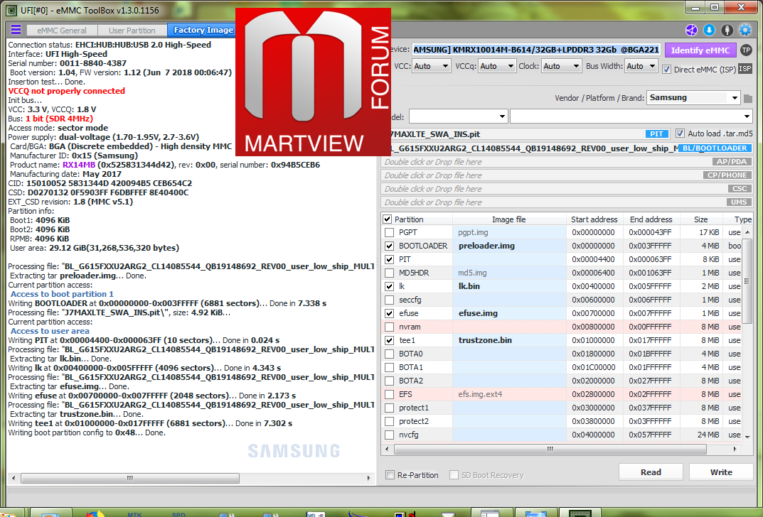

UFI LOG-1
UFI LOG-2

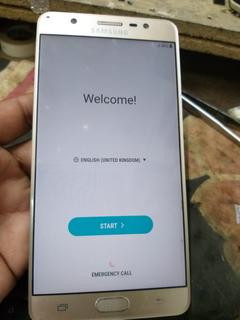

HANDSET ALIVE SUCESSFULLY
After Emmc Repair BY Ufi Set Working Fine NOW:G::G::)

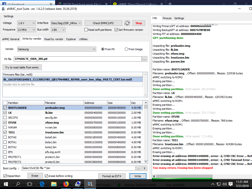

Why did you choose ONLY 4 files : preloader.img ,lk.bin ,efuse.img and trustzone.bin ?
Is there any rule which files to flash??
Thanks
