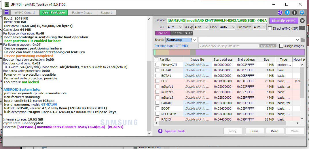

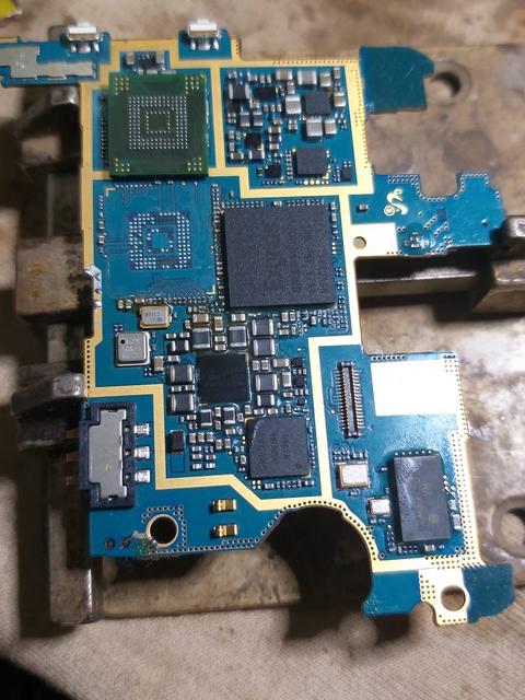

Samsung Galaxy Note-2 Dead Handset+Dead Emmc Also Recover Successfully With Ufi-Box Complete Image Guide Step By Step-

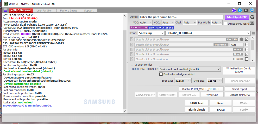

Remove Emmc Then Need to Sort Emmc Tp After Emmc Firmware Update All Process Step By Step
Board Image Emmc Remove

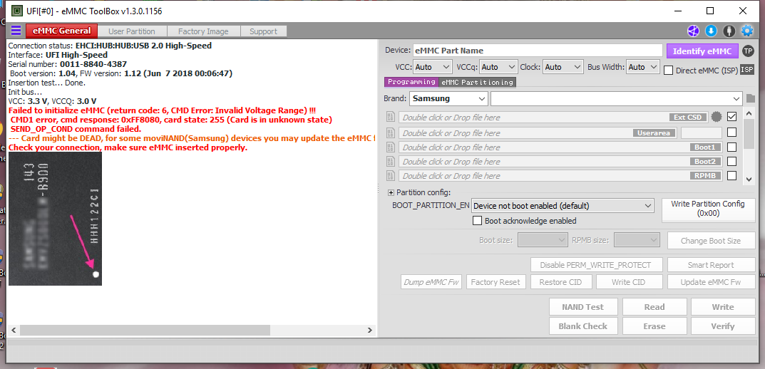

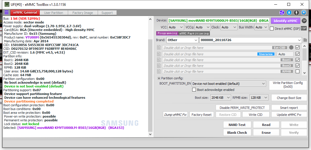

Emmc Dead Show HEre
After Short Emmc Tp

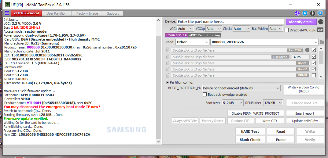

Emmc Firmware Update-
Congratulation Emmc Alive Now Ready To Work/Reprogram

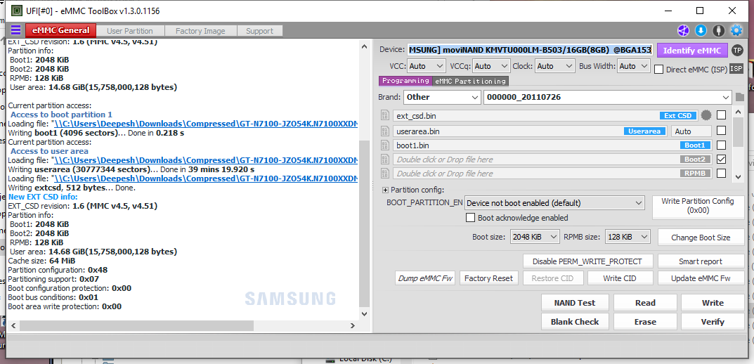

Write Dump To Emmc Card-
After Write Dump Ufi-Log-

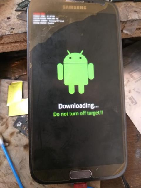

Great Set Now On Download Mode-
After Full Flash

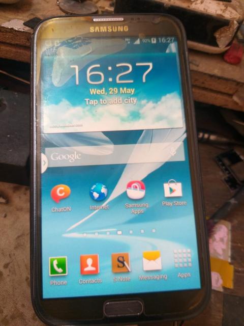

Congratulation Set Working Fine All Ok Network Ok

Emmc Dead Show HEre
After Short Emmc Tp
After Full Flash
