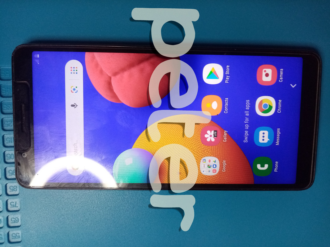

Infinity Samsung M01 Core SM-M013F FRP Reset done

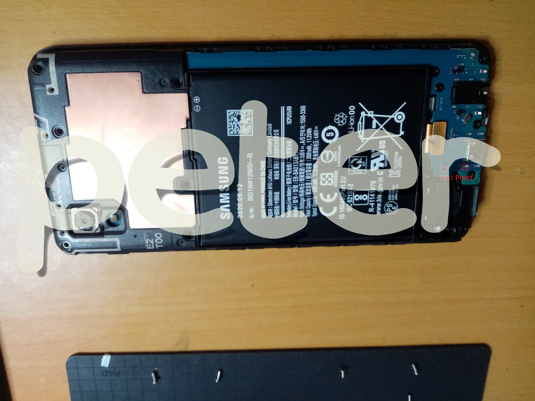

Open Phone back casing for Test Point

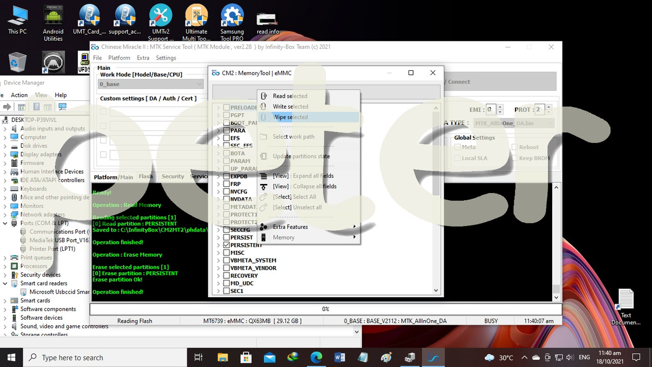

Run InfinityBox CM2MT2
Click Extra tab
Click Memory Tool
Click Init Device
Connect Test Point
Insert USB cable
Check PERSISTENT box
Click PERSISTENT and right-click mouse
Click Read selected for backup
Click Wipe selected
Done..
Test Point :
Wipe Partition :
Done!!!
