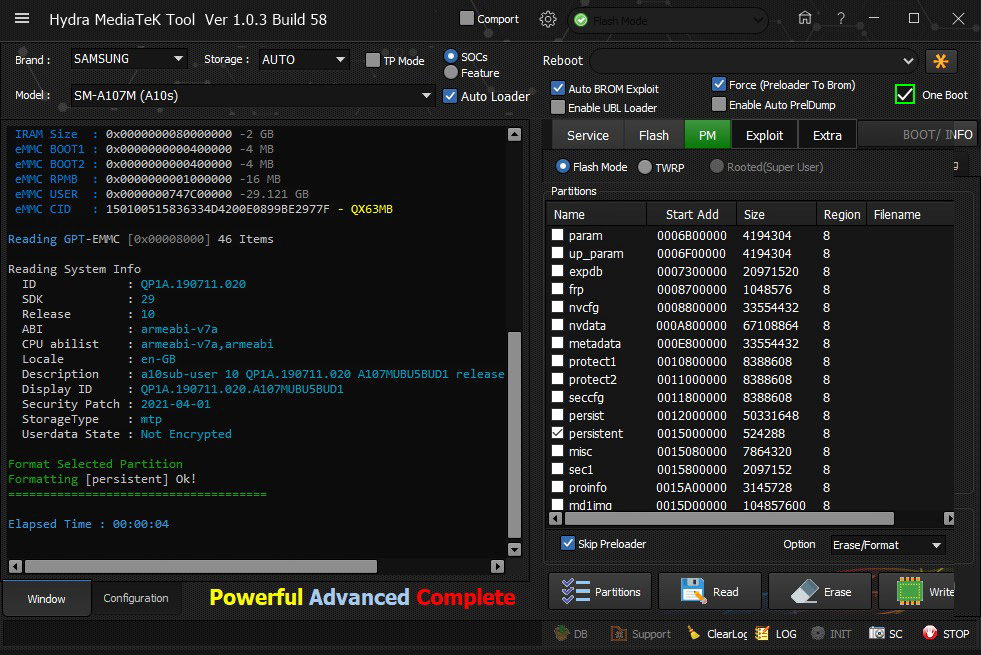

Samsung SM-A107M (A10s) formatting Persistent to remove FRP removed by Hyda Tool
1. Run MTK tool of Hydra Dongle.
2. Choose Correct Module and Brand.
3. Choose "Auto Broom Exploit"
4. Click on "Boot / Info" and wait it reads all.
5. Go to "PM" Tab
6. Skip "preloader"
7. Click on "Partition" button.
8. Now connect device to computer with Data Cable.
9. Wait it shows the different partition.
10. Choose "Presistent"
11. Click on "Erase"
12. Wait until the process is completed
