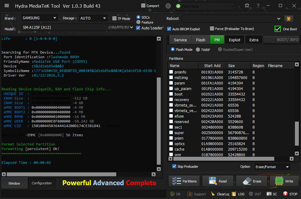

Hydra Samsung SM-A125F (A12) formatting selected partition (Persistence) done by Hydra Tool
550
1. Run Hydra MTK Module and Sosc.
2. Choose Brand and Module
3. Go to "PM" Tab.
4. Choose "Flash Mode" from fastboot mode.
5. Click "Read" and wait few second
6. Choose Selected partition like "Presistence" here
7. Choose format / erase ect according to your need.
8. connect device to the computer with USB Data cable
9. Wait until the process is completed.
