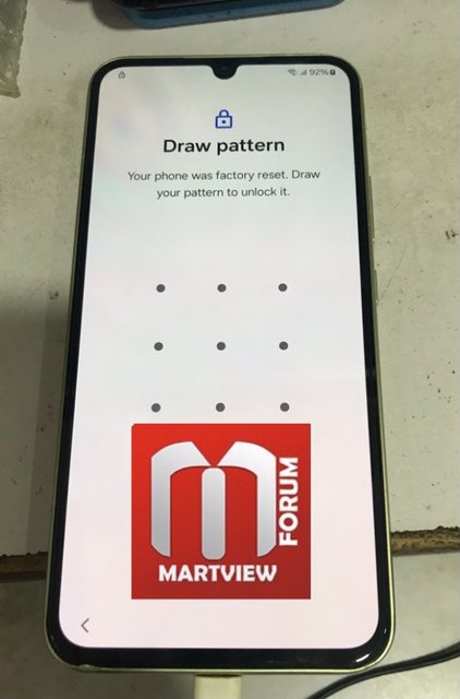

Z3X SAMSUNG SM-A346E SAMSUNG GALAXY A34 5G FRP DONE ONE CLICK WITH PANDORA TOOL WITH SINGLE TESTPOINT FIX

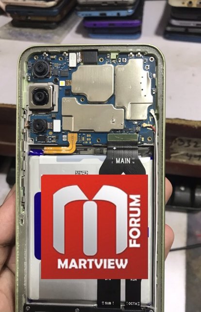

Selected model: Samsung SM-A346E (Samsung Galaxy A34 5G)
Operation: Erase FRP And Wipe
Software version: 9.3
Erasing of partitions can damage your device.
Make sure that you have a backup created. Continue? YES
Connect Type-C to NONE... OK
Host Power Off... OK
Connect phone to [PC] in BROM/PRELOADER Mode

Release testpoint, waiting 2 seconds
Advanced Bypass Security... OK

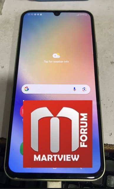

Read partition "frp"... OK
Read partition "persistent"... OK
Backup saved to C:/Program%20Files%20(x86)/Z3X/Pandora/Backup/MTK/Samsung_SM-A346E%20(Samsung%20Galaxy%20A34%205G)/FRP_BACKUP_(2025-8-10_10-51-9)/
Format FRP... [P1] [P2] OK
Writting FRP data... OK
Formatting "userdata" partition... [P1] OK
Formatting "cache" partition... [P1] OK
Formatting "metadata" partition... [P1] OK
Creating default filesystems... [USERDATA: F2FS] ... [CACHE: EXT4] ... OK
Wipe data done!
