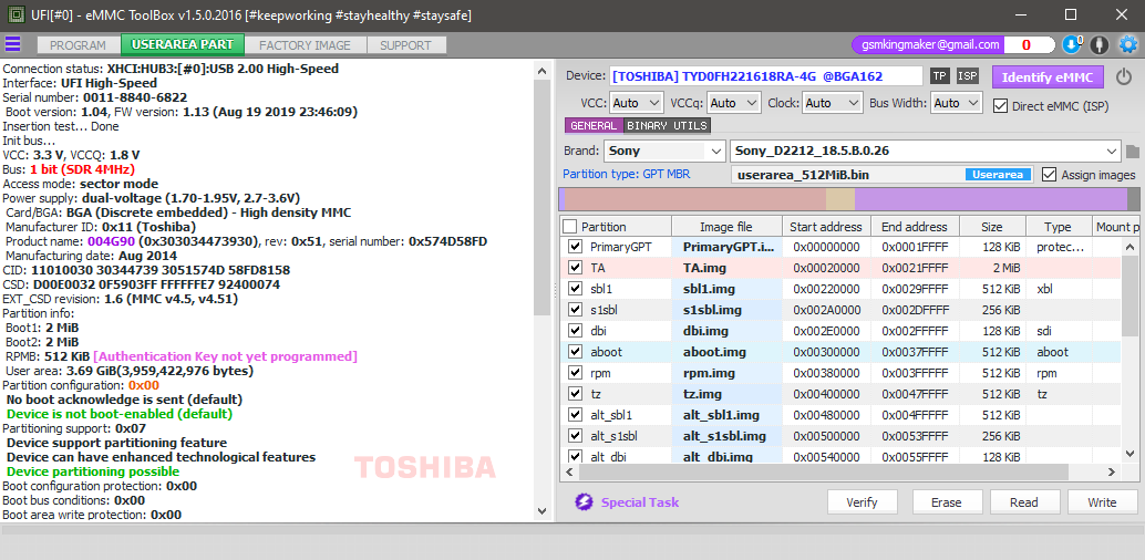

Sony Xperia E3 Dual [ D2212 ] Dead Set Recover Done
BY
UFI BOX
READ INFO
.BY
UFI BOX
READ INFO
Connection status: XHCI:HUB3:[#0]:USB 2.00 High-Speed
Interface: UFI High-Speed
Serial number: 0011-8840-6822
Boot version: 1.04, FW version: 1.13 (Aug 19 2019 23:46:09)
Insertion test... Done
Init bus...
VCC: 3.3 V, VCCQ: 1.8 V
Bus: 1 bit (SDR 4MHz)
Access mode: sector mode
Manufacturer ID: 0x11 (Toshiba)
Product name: 004G90 (0x303034473930), rev: 0x51, serial number: 0x574D58FD
Manufacturing date: Aug 2014
CID: 11010030 30344739 3051574D 58FD8158
CSD: D00E0032 0F5903FF FFFFFFE7 92400074
EXT_CSD revision: 1.6 (MMC v4.5, v4.51)
Partition info:
Boot1: 2 MiB
Boot2: 2 MiB
RPMB: 512 KiB [Authentication Key not yet programmed]
User area: 3.69 GiB(3,959,422,976 bytes)
Partition configuration: 0x00
No boot acknowledge is sent (default)
Device is not boot-enabled (default)
Partitioning support: 0x07
Device support partitioning feature
Device can have enhanced technological features
Device partitioning possible
Boot configuration protection: 0x00
Boot bus conditions: 0x00
Boot area write protection: 0x00

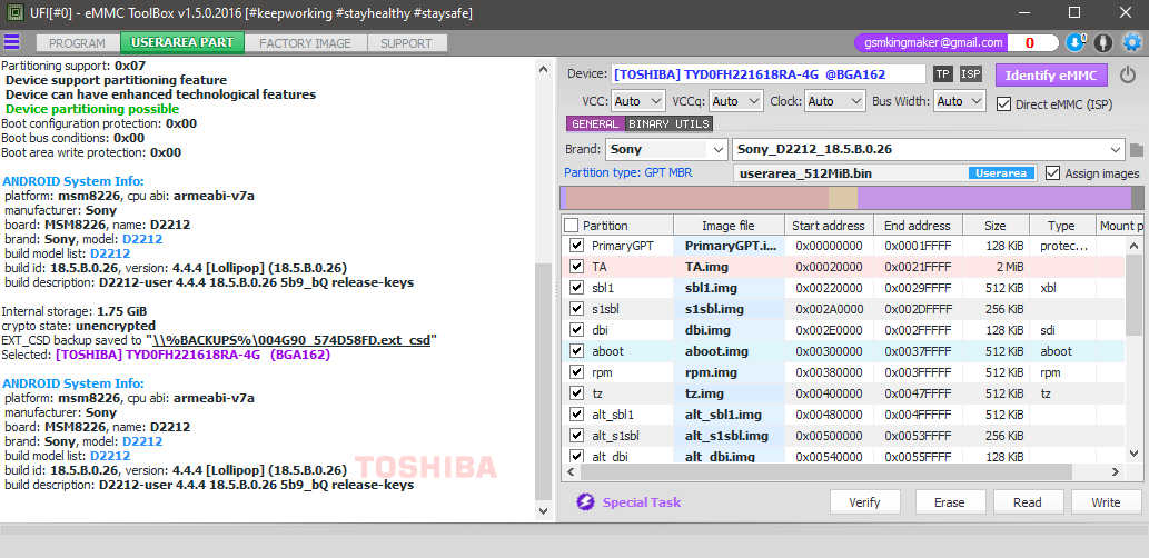

ANDROID System Info:
platform: msm8226, cpu abi: armeabi-v7a
manufacturer: Sony
board: MSM8226, name: D2212
brand: Sony, model: D2212
build model list: D2212
build id: 18.5.B.0.26, version: 4.4.4 [Lollipop] (18.5.B.0.26)
build description: D2212-user 4.4.4 18.5.B.0.26 5b9_bQ release-keys
Internal storage: 1.75 GiB
crypto state: unencrypted
EXT_CSD backup saved to "\\%BACKUPS%\004G90_574D58FD.ext_csd"

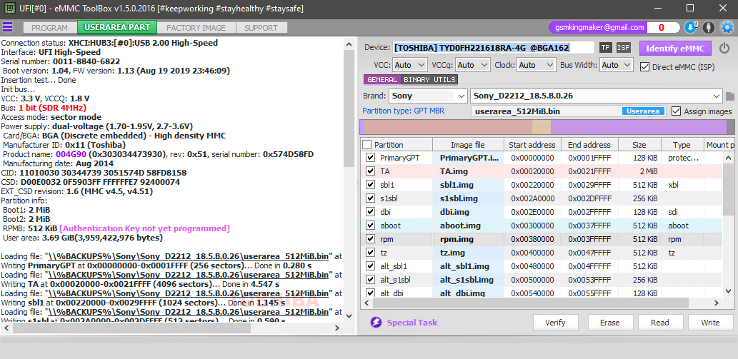

Selected: [TOSHIBA] TYD0FH221618RA-4G (BGA162)
Init bus...
Partition info:
Boot1: 2 MiB
Boot2: 2 MiB

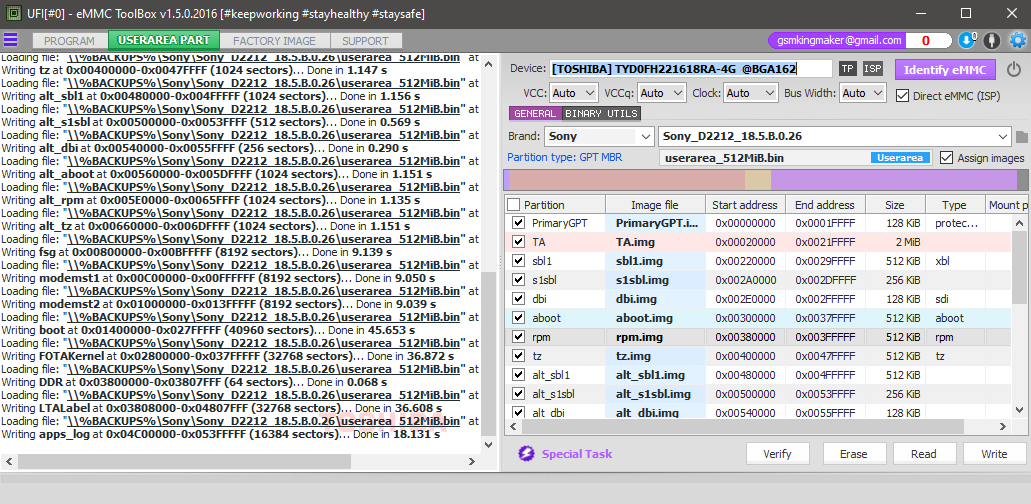

Loading file: "\\%BACKUPS%\Sony\Sony_D2212_18.5.B.0.26\userarea_512MiB.bin" at 0x00000000, size: 128 KiB...
Writing PrimaryGPT at 0x00000000-0x0001FFFF (256 sectors)... Done in 0.280 s
Loading file: "\\%BACKUPS%\Sony\Sony_D2212_18.5.B.0.26\userarea_512MiB.bin" at 0x00020000, size: 2 MiB...
Writing TA at 0x00020000-0x0021FFFF (4096 sectors)... Done in 4.547 s
Loading file: "\\%BACKUPS%\Sony\Sony_D2212_18.5.B.0.26\userarea_512MiB.bin" at 0x00220000, size: 512 KiB...
Writing sbl1 at 0x00220000-0x0029FFFF (1024 sectors)... Done in 1.145 s
Loading file: "\\%BACKUPS%\Sony\Sony_D2212_18.5.B.0.26\userarea_512MiB.bin" at 0x002A0000, size: 256 KiB...
Writing s1sbl at 0x002A0000-0x002DFFFF (512 sectors)... Done in 0.590 s
Loading file: "\\%BACKUPS%\Sony\Sony_D2212_18.5.B.0.26\userarea_512MiB.bin" at 0x002E0000, size: 128 KiB...
Writing dbi at 0x002E0000-0x002FFFFF (256 sectors)... Done in 0.280 s
Loading file: "\\%BACKUPS%\Sony\Sony_D2212_18.5.B.0.26\userarea_512MiB.bin" at 0x00300000, size: 512 KiB...
Writing aboot at 0x00300000-0x0037FFFF (1024 sectors)... Done in 1.161 s
Loading file: "\\%BACKUPS%\Sony\Sony_D2212_18.5.B.0.26\userarea_512MiB.bin" at 0x00380000, size: 512 KiB...
Writing rpm at 0x00380000-0x003FFFFF (1024 sectors)... Done in 1.180 s
Loading file: "\\%BACKUPS%\Sony\Sony_D2212_18.5.B.0.26\userarea_512MiB.bin" at 0x00400000, size: 512 KiB...
Writing tz at 0x00400000-0x0047FFFF (1024 sectors)... Done in 1.147 s
Loading file: "\\%BACKUPS%\Sony\Sony_D2212_18.5.B.0.26\userarea_512MiB.bin" at 0x00480000, size: 512 KiB...
Writing alt_sbl1 at 0x00480000-0x004FFFFF (1024 sectors)... Done in 1.156 s
Loading file: "\\%BACKUPS%\Sony\Sony_D2212_18.5.B.0.26\userarea_512MiB.bin" at 0x00500000, size: 256 KiB...
Writing alt_s1sbl at 0x00500000-0x0053FFFF (512 sectors)... Done in 0.569 s
Loading file: "\\%BACKUPS%\Sony\Sony_D2212_18.5.B.0.26\userarea_512MiB.bin" at 0x00540000, size: 128 KiB...
Writing alt_dbi at 0x00540000-0x0055FFFF (256 sectors)... Done in 0.290 s
Loading file: "\\%BACKUPS%\Sony\Sony_D2212_18.5.B.0.26\userarea_512MiB.bin" at 0x00560000, size: 512 KiB...
Writing alt_aboot at 0x00560000-0x005DFFFF (1024 sectors)... Done in 1.151 s
Loading file: "\\%BACKUPS%\Sony\Sony_D2212_18.5.B.0.26\userarea_512MiB.bin" at 0x005E0000, size: 512 KiB...
Writing alt_rpm at 0x005E0000-0x0065FFFF (1024 sectors)... Done in 1.135 s
Loading file: "\\%BACKUPS%\Sony\Sony_D2212_18.5.B.0.26\userarea_512MiB.bin" at 0x00660000, size: 512 KiB...
Writing alt_tz at 0x00660000-0x006DFFFF (1024 sectors)... Done in 1.151 s
Loading file: "\\%BACKUPS%\Sony\Sony_D2212_18.5.B.0.26\userarea_512MiB.bin" at 0x00800000, size: 4 MiB...
Writing fsg at 0x00800000-0x00BFFFFF (8192 sectors)... Done in 9.139 s
Loading file: "\\%BACKUPS%\Sony\Sony_D2212_18.5.B.0.26\userarea_512MiB.bin" at 0x00C00000, size: 4 MiB...
Writing modemst1 at 0x00C00000-0x00FFFFFF (8192 sectors)... Done in 9.050 s
Loading file: "\\%BACKUPS%\Sony\Sony_D2212_18.5.B.0.26\userarea_512MiB.bin" at 0x01000000, size: 4 MiB...
Writing modemst2 at 0x01000000-0x013FFFFF (8192 sectors)... Done in 9.039 s
Loading file: "\\%BACKUPS%\Sony\Sony_D2212_18.5.B.0.26\userarea_512MiB.bin" at 0x01400000, size: 20 MiB...
Writing boot at 0x01400000-0x027FFFFF (40960 sectors)... Done in 45.653 s
Loading file: "\\%BACKUPS%\Sony\Sony_D2212_18.5.B.0.26\userarea_512MiB.bin" at 0x02800000, size: 16 MiB...
Writing FOTAKernel at 0x02800000-0x037FFFFF (32768 sectors)... Done in 36.872 s
Loading file: "\\%BACKUPS%\Sony\Sony_D2212_18.5.B.0.26\userarea_512MiB.bin" at 0x03800000, size: 32 KiB...
Writing DDR at 0x03800000-0x03807FFF (64 sectors)... Done in 0.068 s
Loading file: "\\%BACKUPS%\Sony\Sony_D2212_18.5.B.0.26\userarea_512MiB.bin" at 0x03808000, size: 16 MiB...
Writing LTALabel at 0x03808000-0x04807FFF (32768 sectors)... Done in 36.608 s
Loading file: "\\%BACKUPS%\Sony\Sony_D2212_18.5.B.0.26\userarea_512MiB.bin" at 0x04C00000, size: 8 MiB...
Writing apps_log at 0x04C00000-0x053FFFFF (16384 sectors)... Done in 18.131 s
