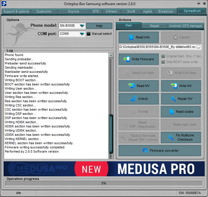

Samsung A310F Write Flash Done
Welcome to Octoplus Box Samsung software version 2.7.1
Selected AP file: G:\SAMSUNG\A310F 6.0\SM-A310F_1_
20180208115201_0za55dcuz5\A310FXXU4CRB1_A310FOXX4CRB1
_A310FXXU4CRB2_HOME.tar.md5
Please put the phone into Download Mode and connect USB cable.
To put SM-A310F into Download Mode, You have to perform the
following steps:
1. Press and hold "Volume-" + "Home" + "Power ON" keys.
2. When phone turns on, press "Volume+" key.
Found phone on
Advanced mode!
Firmware write started.
Writing BOOTLOADER section...
BOOTLOADER section has been written successfully.
Writing CM section...
CM section has been written successfully.
Writing BOOT section...
BOOT section has been written successfully.
Writing RECOVERY section...
RECOVERY section has been written successfully.
Writing SYSTEM section...
SYSTEM section has been written successfully.
Writing RADIO section...
RADIO section has been written successfully.
Firmware writing successfully completed.
Performed by 2.7.1 Software version.

B355 Recovered Successfully

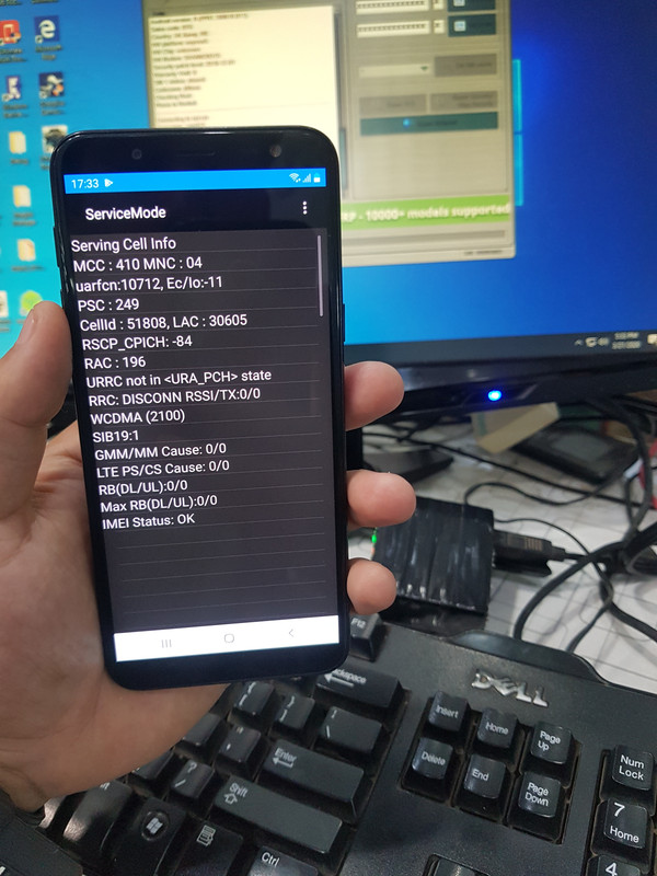

SW Logs
JavaScript:
Platform: Samsung Android
Selected port: COM8
Selected model: SM-J600FN
Operation: Repair Network
Detected phone model: SM-J600FN
Firmware compiled date: Wed Dec  4 12:16:14 KST 2019
PDA version: J600FNXXU6BSL1
CSC version: J600FNOXM6BSL1
SW version: J600FXXU6BSK2
Build number: QB14449434
Phone SN: RF8K70NHTRK
Android version: 9 (PPR1.180610.011)
Sales code: BTU
Country: UK & IRE
HW platform: exynos5
HW Chip: unknown
HW Modem: SHANNON315
Security patch level: 2019-12-01
Warranty Void: 0
SIM 1 status: absent
Codename: j6ltexx
Checking Root:
Phone is Rooted.
Connecting to server ..
Username: zain012
Connect to server successfull.
Checking smart card...
Smart card successfully checked.
Your balance: 100 credits.
Checking operation...OK
Repairing network. Please wait, this can take some time...OK
Network is successfully repaired.
Performed by 2.9.1 Software version.
