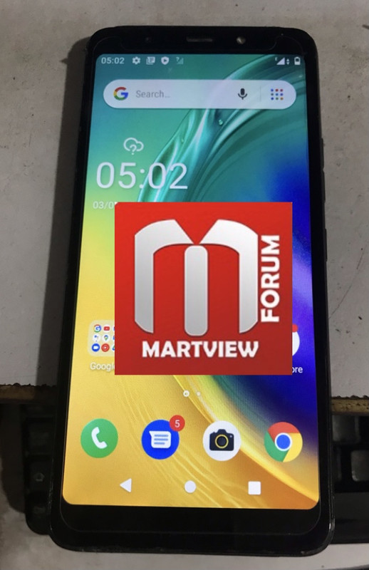

Selected model: Tecno BC2 (Tecno Pop 4)
Operation: Erase FRP
Software version: 9.3
Connect Type-C to NONE... OK
Host Power Off... OK
Connect phone to [PC] in BROM/PRELOADER Mode
Waiting for device... OK
Driver: [MediaTek Inc.,wdm_usb,MediaTek USB Port_V1632,usb2ser.sys,3.0.1504.0]
Device found at COM50 [BROM]
Open port... OK
Send start cmd... OK
Get HW code from device... 6580
Get sec config... OK [00000005]
Active sec flags: [SBC DAA]
Get HW & SW version from device... OK
HW VER: CA00, SW VER: 0000, HW SUB CODE: 8A00
Detect chip [MT6580]
LibUSB installed
Library Version [1]
Select platform... OK
Init BROM... OK
Force Charge... OK
Disable WatchDog Timer... OK
Release testpoint, waiting 2 seconds
Advanced Bypass Security... OK
Open port... OK
Get sec config... OK [00000000]
Library Version [1]
Init BROM... OK
Force Charge... OK
Load DownloadAgent... OK
ME_ID = 0xC04DCFCF, 0x42ABA1B5, 0x01E86562, 0xDBDAE27B
Get BROM version... OK
Search DA... OK [26]
Send preloader... OK
Start preloader... OK
Checking preloader answer... OK
Send bootloader... OK
Start bootloader... OK
Checking bootloader answer... OK
Wait for answer from bootloader... OK
Wait for hw detection... OK
Wait DA version... v4.2
Send BROM version... OK
Send storage config... OK
SyncBmtInfoWithDA... OK
Set params... OK
Read flash info... OK
EMMC_ID: 0x5100011541333658E1980342E9974F9B
Load EMI from phone... OK
Init DRAM... OK
Enable DRAM... OK
Sync with DA... OK
Wait for DA H/W detection... OK
EMMC INFO:
EMMC_CNAME: QX63AB
EMMC_ID : 0x1501005158363341420398E19B4F97E9
EMMC_BOOT1: 0x0000400000 (4.00Mb)
EMMC_BOOT2: 0x0000400000 (4.00Mb)
EMMC_RPMB : 0x0000400000 (4.00Mb)
EMMC_USER : 0x0747C00000 (29.12Gb)
RAM INFO:
INT_SRAM: 0x0000020000 (128.00Kb)
EXT_RAM : 0x0080000000 (2.00Gb)
HEALTH:
Pre EOL Info: normal
DeviceLifeTimeEstA: 10% - 20% device life time used
DeviceLifeTimeEstB: 10% - 20% device life time used
Checking USB status... USB_FULL_SPEED
Switching to USB high speed... OK
Driver: [MediaTek Inc.,wdm_usb,MediaTek DA USB VCOM (Android),usb2ser.sys,3.0.1504.0]
High Speed USB detected at COM25
Open port... OK
Checking USB status... USB_HIGH_SPEED
Read partitions info from phone... OK
Checking A/B state... OK
Read product info... [EXT4] ... OK
Product Brand : TECNO
Product Manufacturer : TECNO MOBILE LIMITED
Product Model : TECNO BC2
Product Name : BC2-OP
Product Device : TECNO-BC2
Product Board : k80hd_bsp_fwv_512m
Board Platform : mt6580
Build ID : QP1A.190711.020
Build Date : Tue May 3 13:45:59 CST 2022
Display ID : BC2-VP592AB-QGo-OP-220503V019
Security Patch : 2022-04-05
Version SDK : 29
Version Release : 10
Version Codename : REL
Firmware Version : AB-OP-220503V019
Userdata FS Type : F2FS
Read partition frp... OK
Backup saved to C:/Program%20Files%20(x86)/Z3X/Pandora/Backup/MTK/Tecno_BC2%20(Tecno%20Pop%204)/FRP_BACKUP_(2025-8-23_11-59-41)/
Format FRP... [P1] OK
Fix TOOL DL Image error... OK
Erase FRP done!
