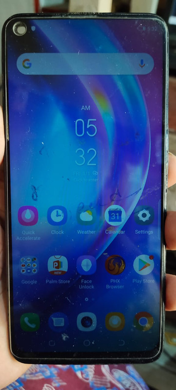

EMMC CHANGE TO 3GB 32GB(SAMSUNG) FROM 4GB 64GB(SKHYNIX)

Setting boot partition config to 0x48... Done
![](/proxy.php?image=https%3A%2F%2Fi.postimg.cc%2FXJH6txqG%2F0b0a41d8-a2c6-49c3-ac70-aad3ae06f93c.jpg&hash=d027c8fc7d6ffddf5a012add8de90c65)
