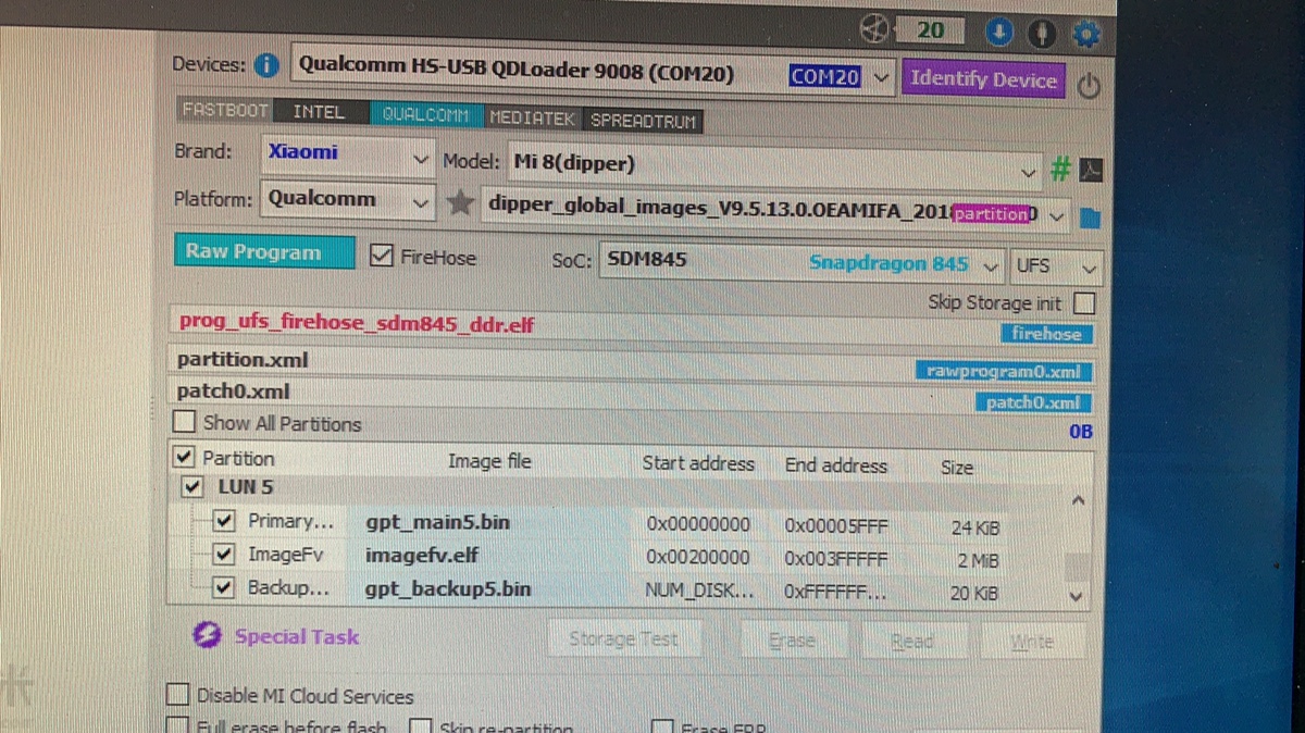

this is support oppo a3s flasing ?
Firmware package: CPH1803EX_11_A.13_181103_2bc89894
Scanning for Qualcomm HS-USB QDLoader 9008 device...
Download Port: Qualcomm HS-USB QDLoader 9008 (COM19)

one problem is there ,that box firmware not updating
try to update from setting showing update but after
update the vertion is in 1.10 not updating in 1.13 plz help
exe updated to 1.4.0.1467 but firmware vertion not updating from 1.10 to 1.13... tryed update from setting plz help....
