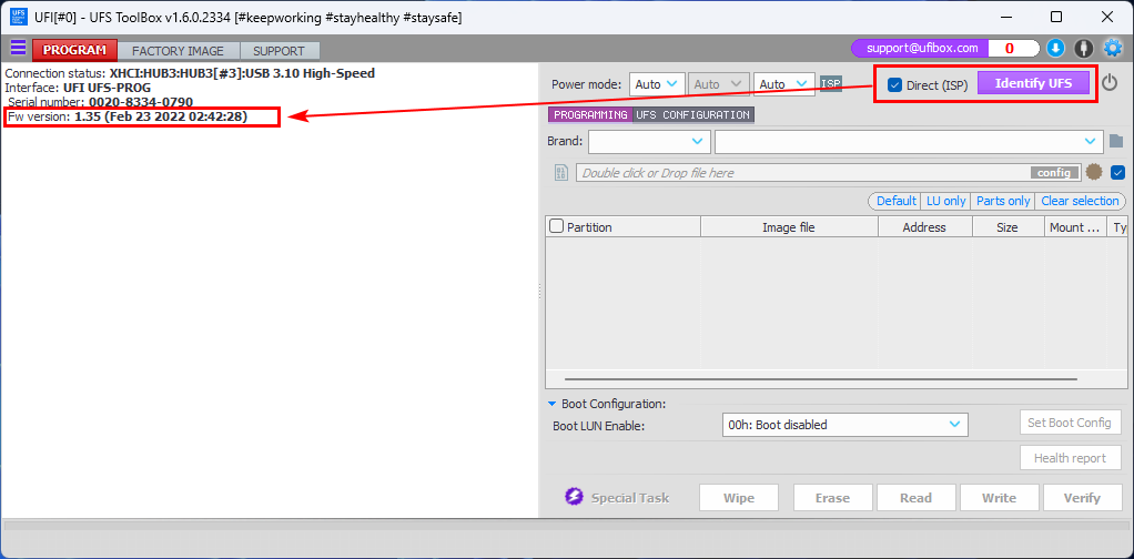

After getting several reports of UFS ISP issues in UFI UFS Toolbox,
this is caused by UFI UFS-PROG firmware version 1.35 which have incompability issue.

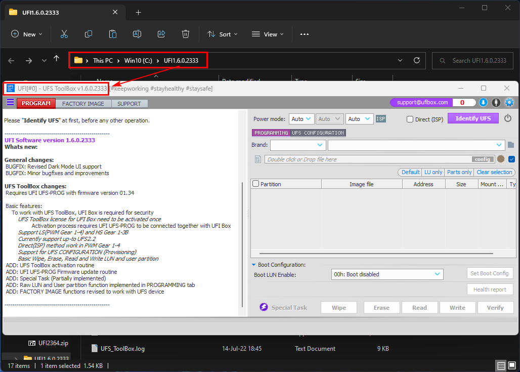

To fix this problem, we have to downgrade the firmware to previous version, please follow the following guide:
Download and install UFI Software version v1.6.0.2333 in this link.
Install to separate folder, and rename the installation folder according to the version.

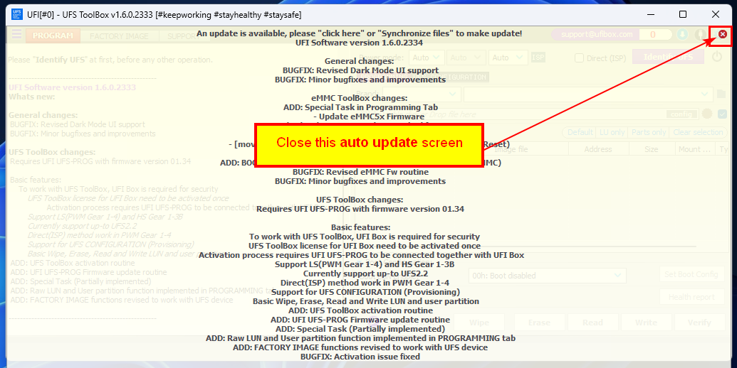

After opening the software, please skip auto update screen to prevent UFI Software being update to the latest version.

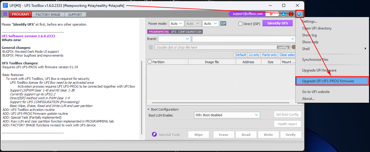

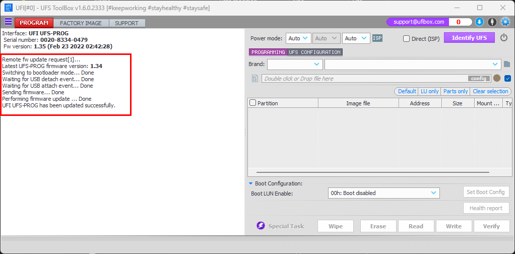

Now go to setting menu, and do Upgrade UFI UFS-PROG firmware to downgrade firmware version to 1.34.
Wait until the upgrade progress is completed successfully

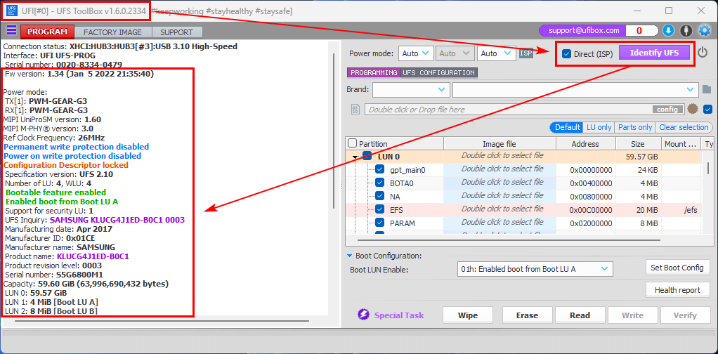

Now you can open the latest version of UFI UFS ToolBox to perform ISP operations without any problems.
In the meantime, do not upgrade the UFI UFS-PROG firmware to version 1.35 until we announce further fixes.
