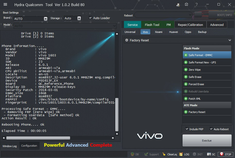

Vivo 1603 Zero Wipe Formatting user data successfully done by Hydra Tool
1. Run Vivo Quacomm Tool
2. Go to "Service"-- "Vivo" Tab
3. Choose Safe Format EMMC (Flash Mode)
4. Click on "EXECUTE"
5. Insert Device with computer using USB Data Cable
6. Wait until the operation is completed.
7.Done.

Phone Information.....
Brand : vivo
Vendor : vivo
Model : vivo 1603
SDK : 23
Release : 6.0.1
ABI : armeabi-v7a
Locale : en-US
Description : msm8937_32-user 6.0.1 MMB29M eng.compiler.20180314.095125 release-keys
Device : PD1613F_EX
Board : QC_Reference_Phone
Display ID : MMB29M release-keys
Security Patch : 2018-03-01
Emmc_size : 16GB
Platform : msm8937
Fingerprint : vivo/1603/1603:6.0.1/MMB29M/compiler03140954:user/release-keys
Processing Safe Format - EMMC....
- Removing FRP [Zero Wipe] Ok
- Formatting Userdata [Safe method] Ok
Action Result : Ok
Rebooting Phone.... Ok
Elapsed Time : 00:00:05
