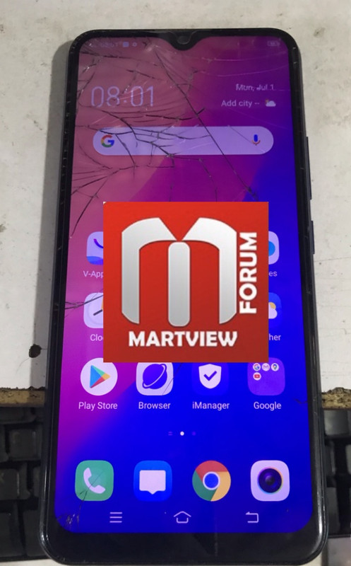

Selected model: Vivo PD1901BF (Vivo Y12)
Operation: Erase FRP And Wipe
Software version: 9.3
Erasing of partitions can damage your device.
Make sure that you have a backup created. Continue? YES
Connect Type-C to NONE... OK
Host Power Off... OK
Connect phone to [PC] in PRELOADER Mode
Waiting for device... OK
Driver: [MediaTek Inc.,wdm_usb,MediaTek PreLoader USB VCOM_V1632 (Android),usb2ser.sys,3.0.1504.0]
Device found at COM56 [PRELOADER]
Open port... OK
Send start cmd... OK
Get HW code from device... 0766
Get sec config... OK [00000005]
Active sec flags: [SBC DAA]
Get HW & SW version from device... OK
HW VER: CA00, SW VER: 0000, HW SUB CODE: 8A00
Detect chip [MT6765]
Library Version [2]
Select platform... OK
Init BROM... OK
Force Charge... OK
Disable WatchDog Timer... OK
Reopen port for libver2... OK
Preloader exist. Skip connection verification.
Get ME ID... OK
ME_ID = 0x439A0295, 0x31D954EE, 0xC90BD2F6, 0x923D039F
Load DownloadAgent... OK
Search DA... OK [2]
Send bootloader... OK
Start bootloader... OK
Wait for answer from bootloader... OK
Send SYNC signal... OK
Setup device enviroment... OK
Setup device parametres... OK
Receive DA SYNC signal... OK
Set DA parametres... OK
Get device connection agent... [PRELOADER]
Preloader alive. Skip initializing external RAM
Send 2nd DA... OK
DA2 auth: disabled
Get device info... OK
EMMC INFO:
EMMC_CNAME: RP64MB
EMMC_ID : 0x150100525036344D420124D568AF2745
EMMC_BOOT1: 0x0000400000 (4.00Mb)
EMMC_BOOT2: 0x0000400000 (4.00Mb)
EMMC_RPMB : 0x0001000000 (16.00Mb)
EMMC_USER : 0x0E8F800000 (58.24Gb)
RAM INFO:
INT_SRAM: 0x000003A000 (232.00Kb)
EXT_RAM : 0x0100000000 (4.00Gb)
Checking USB status... USB_HIGH_SPEED
[EFUSE INFO]: BROM not disabled
Read partitions info from phone... OK
Checking A/B state... OK
Read product info... [EXT4] ... OK
Product Brand : vivo
Product Manufacturer : vivo
Product Model : vivo 1901
Product Name : 1901
Product Device : 1901
Product Board : k62v1_64_bsp
Board Platform : MTK6765
Build ID : RP1A.200720.012
Build Date : Mon Oct 21 14:39:05 CST 2024
Display ID : RP1A.200720.012 release-keys
Security Patch : 2022-05-01
Version SDK : 30
Version Release : 11
Version Codename : REL
Firmware Version : eng.compil.20241021.144209
Userdata FS Type : EXT4
Read partition "frp"... OK
Backup saved to C:/Program%20Files%20(x86)/Z3X/Pandora/Backup/MTK/Vivo_PD1901BF%20(Vivo%20Y12)/FRP_BACKUP_(2025-8-23_11-29-58)/
Format FRP... [P3] OK
Formatting "userdata" partition... [P3] OK
Formatting "cache" partition... [P3] OK
Formatting "metadata" partition... [P3] OK
Wipe data done!
