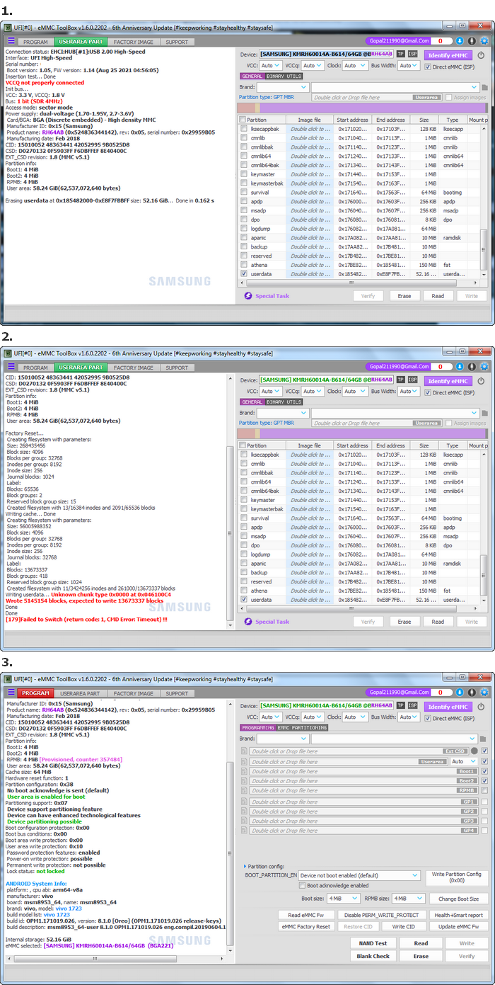

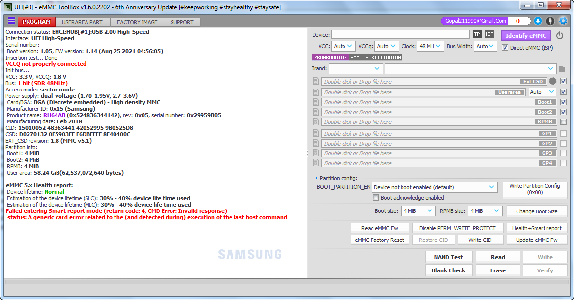

today in my shop come vivo v9 hang on logo & again-2 come in fast boot mode only so please help me
connect successfully & info:
health report:
so please help me & solve my problem

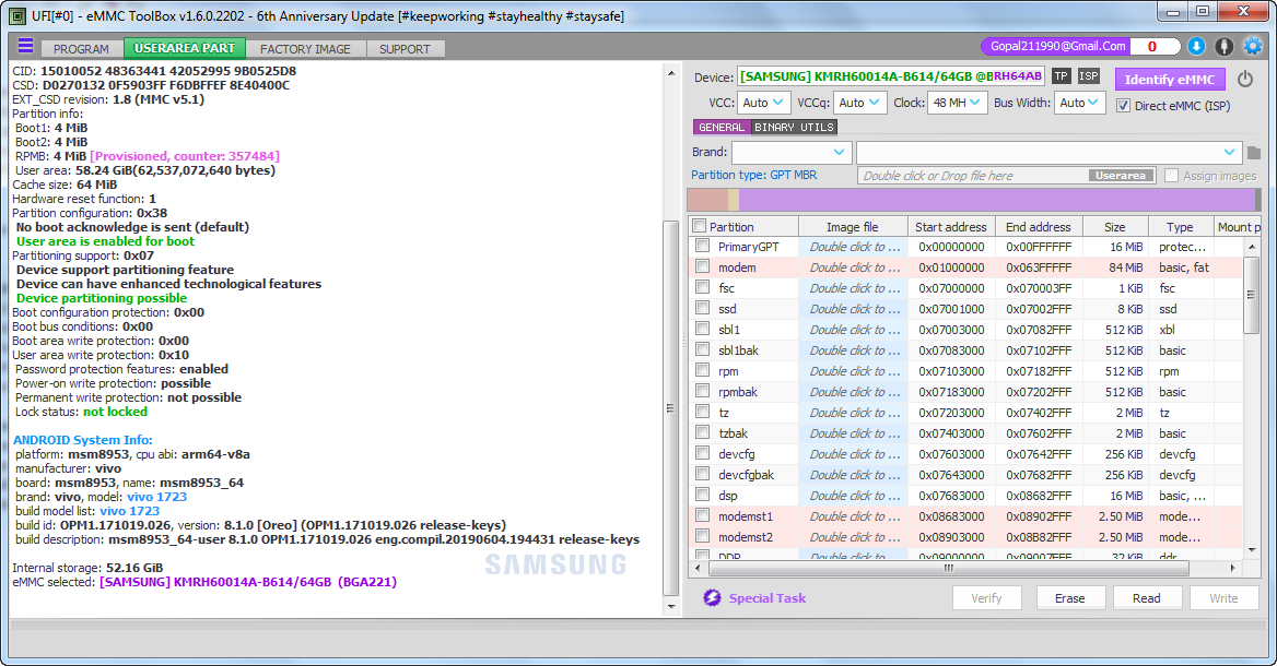

health report:

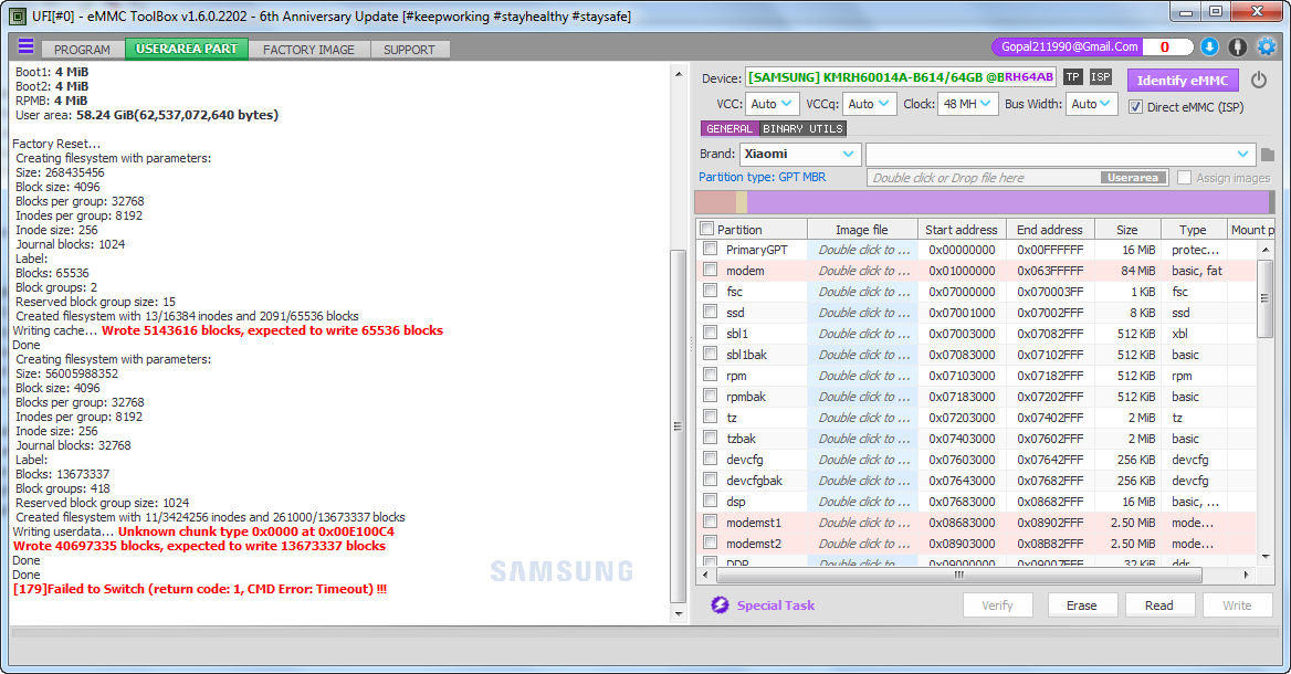

many times again-4 identify emmc this info coming:
error coming during FORMAT:

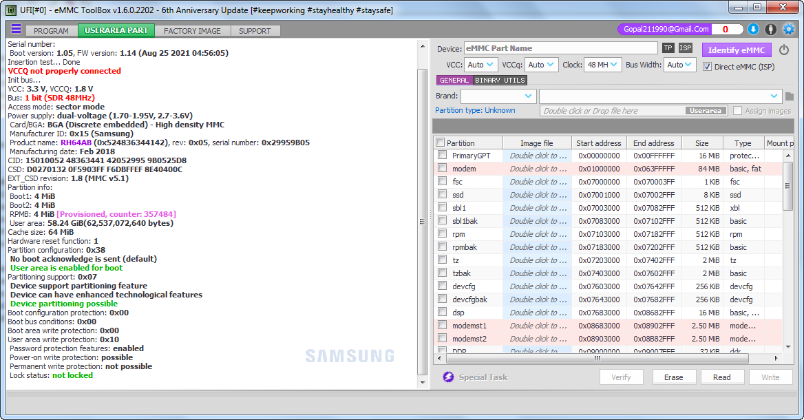

aftab_ansari5287
This problem is solved. thanks [B]All TECH 4 You[/B] for given the solution.
The Solution is only formating userdata and cache partition, will never cause deadboot issue. if not solve flash userdata & cache file from stock firmware.
Thanks You So Much All.
