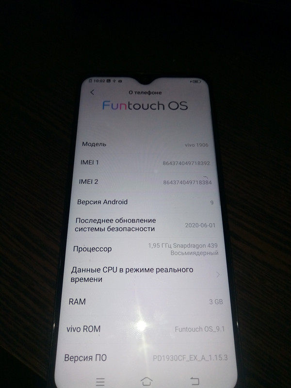

![](/proxy.php?image=https%3A%2F%2Fi.postimg.cc%2FMKHWM7dh%2FP01222-130506.jpg&hash=e857d9cb3cb192b89cc9f9a84845eb5a)
