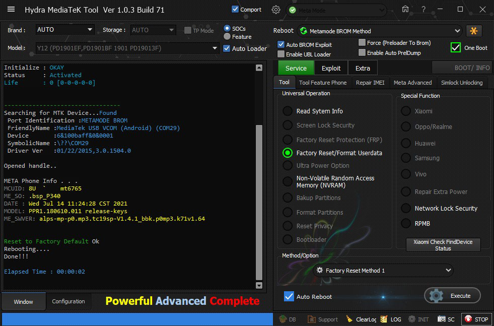

Vivo Y12 MT6262 Reset Factory Default successfully done by Hydra Tool
1. Run Hydra MTK Tool
2. choose Brand and Module
3. Go to "Service"--> "Tool"
4. Choose "Factory Reset / Format user data".
5. Choose "Factory Reset Method 1" from "Option / Method" drop down menu.
6. Tick "Auto Reboot"
7. Click on "Execute"
8. connect test point of disassembled cellphone / mobile.
9. Connect device to computer with USB Data Cable.
10. Wait until the operation is completed.
