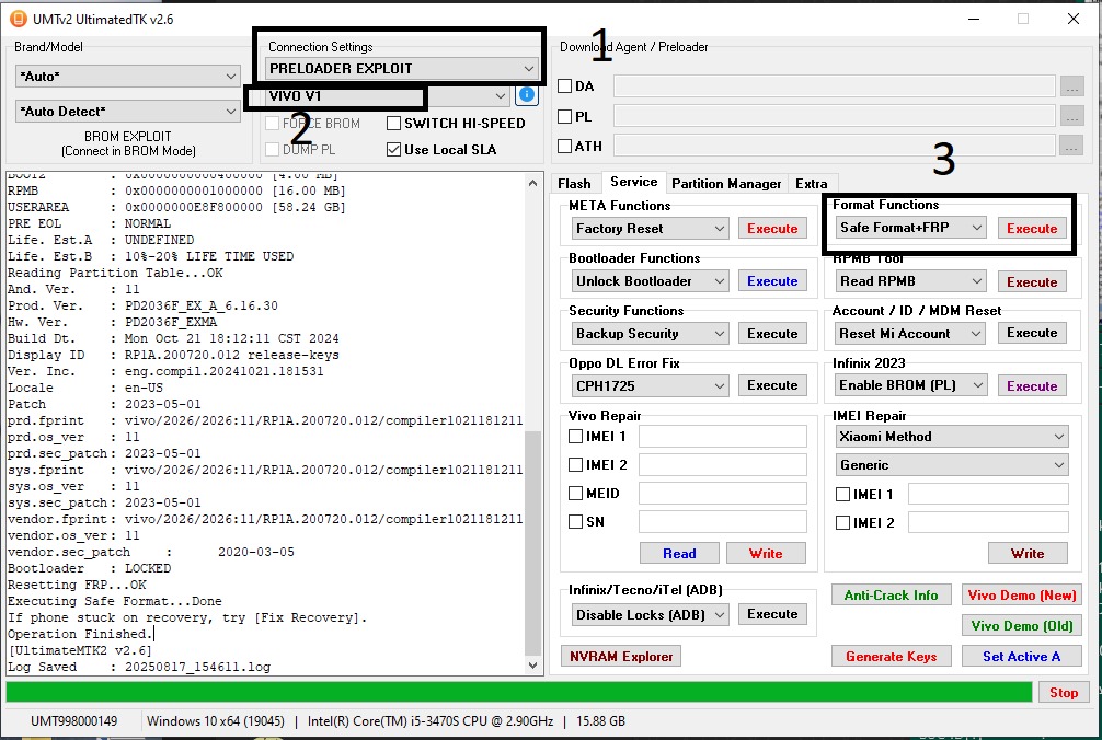

UMT vivo Y20 2021 safe formate and factory reset done by umt tool

Brand/Model : Auto / Auto Detect
Operation : Safe Format+FRP
LOCAL SLA : ON
BOOT CFG : [EXPLOIT:PL][VIVO V1]
Waiting for Device...Found
Port : MediaTek PreLoader USB VCOM (Android) (COM8)
Device Path : \\?\usb#vid_0e8d&pid_2000#6&323149bf&0&2
#{a5dcbf10-6530-11d2-901f-00c04fb951ed}
Driver : MediaTek Inc., 3.0.1512.0 [usb2ser.sys]
Mode : PRELOADER
Hw ID : MT6765 [0766] Helio P35/G35
Details : 8A00,CA00,0000
Sec. Config : [SBA:ON] [SLA:OFF] [DAA:ON]
MEID : C95ED0A31734EBDAB4DFCA5580F9A212
SoC ID[0] : A98CCAA3E189D74A8B04E0FDE29182C7
SoC ID[1] : DBD32BA7E36ACEE0A72DC942D9C04B11
Sending 1st DA..OK
Jump DA Address...OK
Syncing...OK
Checksum Level is Storage
Connection : preloader
Speed : HIGH-SPEED
Reading RAM Configuration...OK
Running PL_EXPLOIT [1]...Done
Sending 2nd DA...OK
HRID : 3A59A8B04FCD7FE9737C683E7F86DF82
Int. RAM : 0x000000000003A000 [232.00 KB]
Ext. RAM : 0x0000000100000000 [4.00 GB]
Flash ID : hC9aP3
CID : 90014A6843396150330110114C04184B
BOOT1 : 0x0000000000400000 [4.00 MB]
BOOT2 : 0x0000000000400000 [4.00 MB]
RPMB : 0x0000000001000000 [16.00 MB]
USERAREA : 0x0000000E8F800000 [58.24 GB]
PRE EOL : NORMAL
Life. Est.A : UNDEFINED
Life. Est.B : 10%-20% LIFE TIME USED
Reading Partition Table...OK
And. Ver. : 11
Prod. Ver. : PD2036F_EX_A_6.16.30
Hw. Ver. : PD2036F_EXMA
Build Dt. : Mon Oct 21 18:12:11 CST 2024
Display ID : RP1A.200720.012 release-keys
Ver. Inc. : eng.compil.20241021.181531
Locale : en-US
Patch : 2023-05-01
prd.fprint : vivo/2026/2026:11/RP1A.200720.012/compiler1021181211
prd.os_ver : 11
prd.sec_patch : 2023-05-01
sys.fprint : vivo/2026/2026:11/RP1A.200720.012/compiler1021181211
sys.os_ver : 11
sys.sec_patch : 2023-05-01
vendor.fprint : vivo/2026/2026:11/RP1A.200720.012/compiler1021181211
vendor.os_ver : 11
vendor.sec_patch : 2020-03-05
Bootloader : LOCKED
Resetting FRP...OK
Executing Safe Format...Done
If phone stuck on recovery, try [Fix Recovery].
Operation Finished.
[UltimateMTK2 v2.6]
Log Saved : 20250817_154611.log
