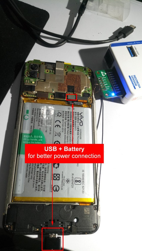

VIVO Y53 RADIO OFF NO SERVICE PROBLEM SOLVE BY UFI BOX ON ISP PINOUT REPROGRMING
VIVO Y53 RADIO OFF and no service problem solve by reprogram on ufi box

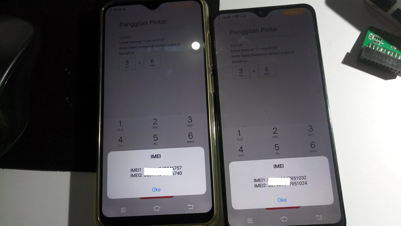

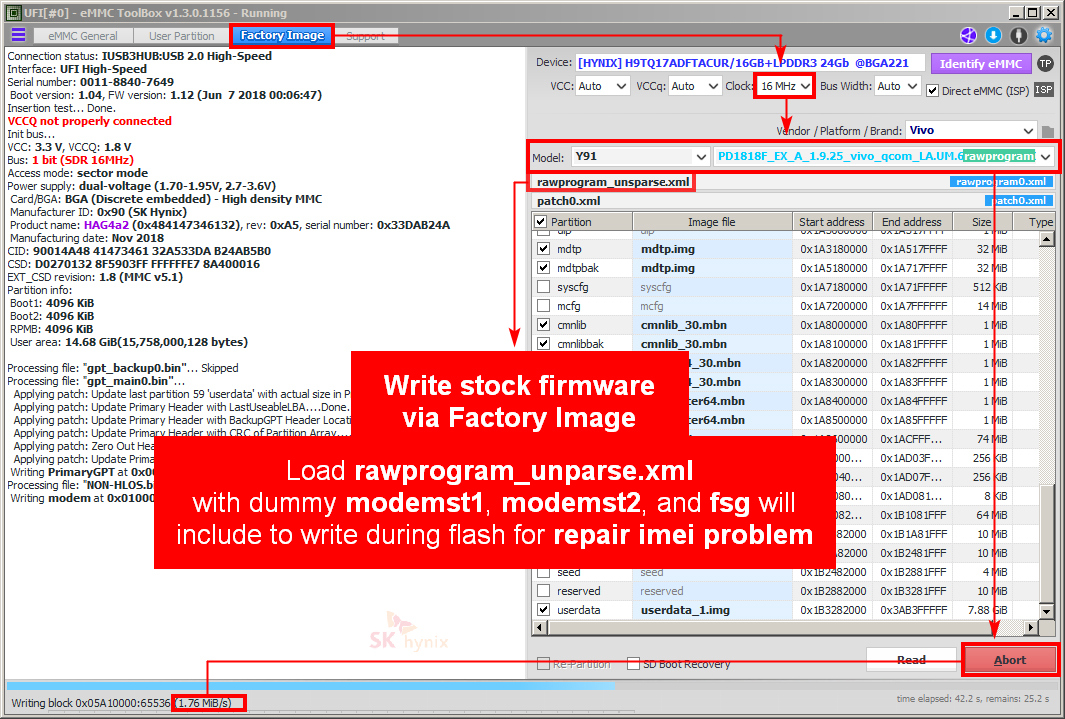

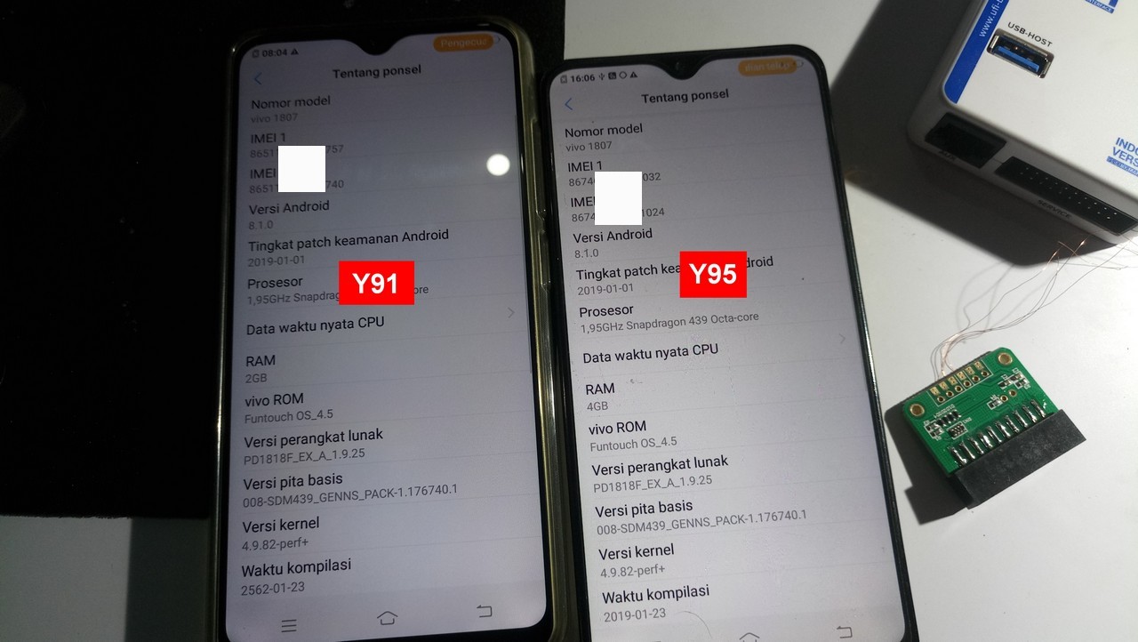

I can confirm that this above methode also working in Vivo Y91, Y93, and Y95
dead boot during erase user data partition for clear user lock use QFIL,
which end up by wrong erase entire disk.
Because entire disk is format, so imei data partitions is also erased.
To recover imei and callibrations data, you can use official vivo split firmware,
and pick rawprogram_unparse.xml with dummy modemst and default fsg image.

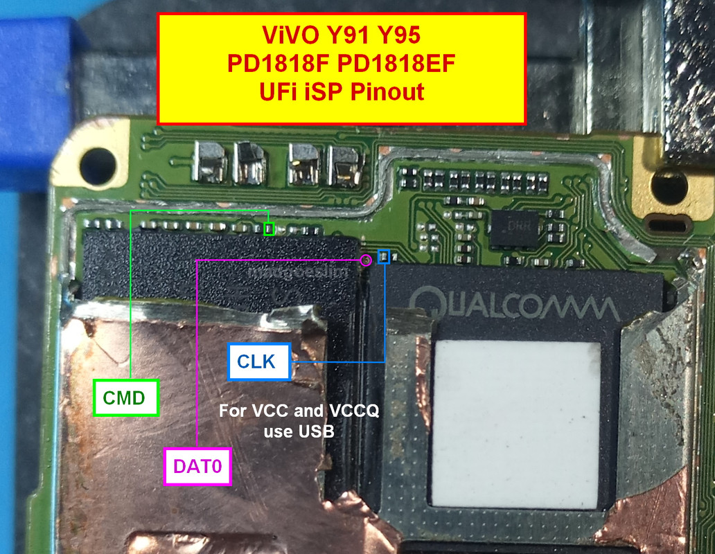

Anyone plz. give
Vivo y53i 1606 ISP Pinout

pd1818f dead boot repair solution please help me it's unfortunately full emmc partition erased gpt area blank show qualcomm port 9008. any one have solution please
