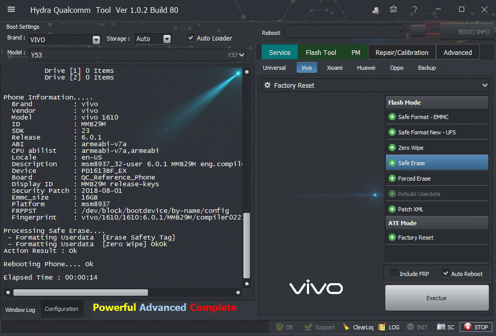

Vivo Y53 zero wipe successfully removed by Hydra Tool
1. Run Qualcomm Tool and choose "Sosc"
2. Choose Brand and Module.
3. Go to "Service"--> "Vivo"
4. Choose "Factory Reset" from drop down menu
5. Choose "Safa formet EMMC" from Flash Mode
6. Click on "Execute"
7. Connect device to computer using USB Data Cable.
8. Wait until the operation is completed.
BRPreOperation Configuration
Brand : VIVO Model : Y53 Storage : Auto
Loader: 8917.mbn
Port : Auto
Connection :
FriendlyName :Qualcomm HS-USB QDLoader 9008 (COM13)
SymbolicName :\??\USB#VID_05C6&PID_9008#5&167c16fb&0&2#{a5dcbf10-6530-11d2-901f-00c04fb951ed}
Getting device info......
Serial No.: 0xF1080AFD
MSM ID : 0x000560E1, MSM8917-Qualcomm Snapdragon 425
PBL Ver : 00000000
PK HASH : 60BA997FEF6DA9F05885FA11F1DD6D2A
90D052A257A09C2075D7246CC73C0D43
Firehose Loader[8917.mbn]
SaharaBoot... Ok
Sending .................Ok
Connecting to Firehose...
Ping... Ok
Configuration......
Identifying Chip....
Ok
Chip Configuration :
MemoryName : eMMC
MaxXMLSizeInBytes : 4096
TargetName : 8917
Version : 1
*** STORAGE DEVICE INFO ***
Memory Type : eMMC
Block Size in Bytes : 512
Page Size : 512
Manufacturer ID : 21
Serial Number : 1003645666
Firmware Version : 13
Product Name : RE1BMB
Physical Partitions : 3
Total Logical Blocks:
Drive [0] 30535680[14.561 GB]
Drive [1] 8192[4 MB]
Drive [2] 8192[4 MB]
Protocol : Universal
Running : Ok
Reading GPT[3]
Drive [0] 52 Items
Drive [1] 0 Items
Drive [2] 0 Items
Phone Information.....
Brand : vivo
Vendor : vivo
Model : vivo 1610
SDK : 23
Release : 6.0.1
ABI : armeabi-v7a
Locale : en-US
Description : msm8937_32-user 6.0.1 MMB29M eng.compiler.20190227.121058 release-keys
Device : PD1613BF_EX
Board : QC_Reference_Phone
Display ID : MMB29M release-keys
Security Patch : 2018-08-01
Emmc_size : 16GB
Platform : msm8937
Fingerprint : vivo/1610/1610:6.0.1/MMB29M/compiler02271214:user/release-keys
Processing Safe Erase....
- Formatting Userdata [Erase Safety Tag]
- Formatting Userdata [Zero Wipe] OkOk
Action Result : Ok
Rebooting Phone.... Ok
Elapsed Time : 00:00:14
