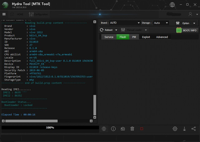

Vivo Y81i (1812) Flashing done with Hydra Tool
- First Keep Press Boot Info
To Enable BROM  Mode :
     Method 1    - Bootkey (Vol + - Power) or any combination
     Method 2    - Enable Preloader to brom(crashing Method)
     Method 3    - Test Point Data0 + ground
To Enable Preloader  Mode :
     Method 1    - Just Insert cable
  MTK Port Type   : Flashmode BROM
  FriendlyName    : MediaTek USB Port_V1633 (COM4)
  Device          : /6&37254210&0&4
  SymbolicName    : \\?\usb#vid_0e8d&pid_0003#6&37254210&0&4#{a5dcbf10-6530-11d2-901f-00c04fb951ed}
  Driver Ver      : 01/22/2015,3.0.1504.0
  Service         : wdm_usb
Openning Port [COM4] Ok
Handshaking...Ok
  HwCode          : 0717 {MT6761/MT6762/MT3369/MT8766B}
  Hwver           : 0000
  Target config   : E5
  SBC             : 01 (True)
  SLA             : 00 (False)
  DAA             : 04 (True)
  SWJTAG          : 04 (True)
  EPP             : 00 (False)
  CERT            : 00 (False)
  MEMREAD         : 20 (True)
  MEMWRITE        : 40 (True)
  CMD_C8          : 80 (True)
  Connection      : BROM
  HW Subcode      : 8A00
  HW Subcode      : CA01
  SW Ver          : 0200
  ME_ID           : 820D42FD152D436532D17D77D6118563
  SOC_ID          : F4D91C36D3D43BA509BF9E2EBF5C5DDFA6CC7E1F565A7414884E8613CC43E70C
Exploiting Device...
Successfully Exploited..
Handshaking...Ok
Starting to dump...
Prel Size : 0x0003B72C
Successfully dump preloader..  [C:\Hydra Tool\Boot\PreloaderDump\preloader_k61v1_64_bsp.bin]
  Target config   : 00
  SBC             : 00 (False)
  SLA             : 00 (False)
  DAA             : 00 (False)
  SWJTAG          : 00 (False)
  EPP             : 00 (False)
  CERT            : 00 (False)
  MEMREAD         : 00 (False)
  MEMWRITE        : 00 (False)
  CMD_C8          : 00 (False)
  Connection      : BROM
Patching da2 ... Ok
Uploading Stage 1....
Jumping to 0x00200000 Ok 0xC0
Successfully received DA sync
  ONNECTION_AGENT : brom
  DRAM config needed for : 90014A4841473461
Sending auto preloader from dump...  [preloader_k61v1_64_bsp.bin]
Sending emi data succeeded.
Uploading stage 2...
Successfully uploaded stage 2
  ERAM Size       : 0x000000000003A500-233.25 KB
  IRAM Size       : 0x0000000080000000-2 GB
  EMMC RPMB Size  : 0x0000000000400000-4 MB
  EMMC USER Size  : 0x00000003AB400000-14.676 GB
  EMMC CID        : 90014A484147346132A52EEB687D660D - HAG4a2
  HW-CODE         : 0x717
  HWSUB-CODE      : 0x8A00
  HW-VERSION      : 0xCA01
  SW-VERSION      : 0x200
  CHIP-EVOLUTION  : 0x0
  DA-VERSION      : 1.0
  Speed           : high-speed
Reading Partition Table ..
Partition Count : 44
  Brand          : vivo
  Vendor         : vivo
  Model          : vivo 1812
  Product        : k61v1_64_bsp
  Manufacturer   : vivo
  SDK            : 27
  Release        : 8.1.0
  ABI            : arm64-v8a
  CPU abilist    : arm64-v8a,armeabi-v7a,armeabi
  Locale         : en-US
  Description    : full_k61v1_64_bsp-user 8.1.0 O11019 1563630544 release-keys
  Device         : PD1917F_EX
  Display ID     : O11019 release-keys
  Security Patch : 2019-06-05
  Platform       : =MTK6761
  Fingerprint    : vivo/1812/1812:8.1.0/O11019/1563592353:user/release-keys
  StorageType    : mtp
Reading IMEI........
IMEI1 : 86352***********
IMEI2 : 86352***********
Bootloader Status...
  Bootloader : Locked
Elapsed Time : 00:00:16

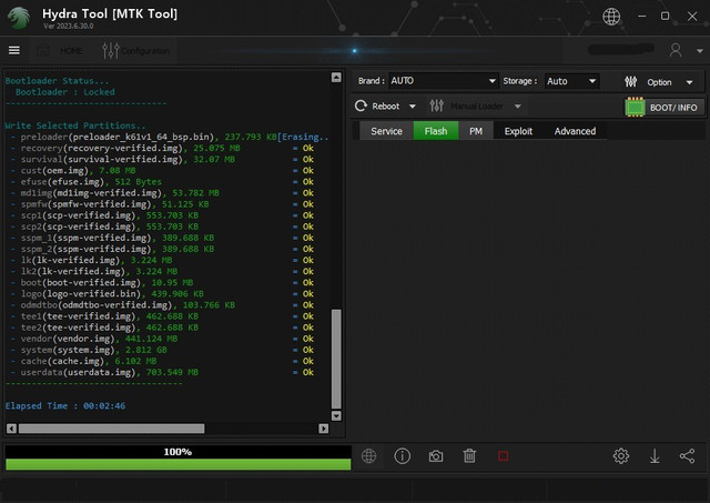

- Select firmware and click execute
                  MTK Flash Function...
  Service         : wdm_usb
  HW-CODE         : 0x717
  HWSUB-CODE      : 0x8A00
  HW-VERSION      : 0xCA01
  SW-VERSION      : 0x200
  DA-VERSION      : 1.0
  Speed           : high-speed
  Brand          : vivo
  Vendor         : vivo
  Model          : vivo 1812
  Manufacturer   : vivo
  SDK            : 27
  Release        : 8.1.0
  ABI            : arm64-v8a
  Locale         : en-US
  Device         : PD1917F_EX
  Platform       : =MTK6761
  StorageType    : mtp
  Bootloader : Locked
Write Selected Partitions..
- preloader(preloader_k61v1_64_bsp.bin), 237.793 KB[Erasing...Ok]  Status  :C0010001 Error= Failed
- recovery(recovery-verified.img), 25.075 MB          = Ok
- survival(survival-verified.img), 32.07 MB           = Ok
- cust(oem.img), 7.08 MB                              = Ok
- efuse(efuse.img), 512 Bytes                         = Ok
- md1img(md1img-verified.img), 53.782 MB              = Ok
- spmfw(spmfw-verified.img), 51.125 KB                = Ok
- scp1(scp-verified.img), 553.703 KB                  = Ok
- scp2(scp-verified.img), 553.703 KB                  = Ok
- sspm_1(sspm-verified.img), 389.688 KB               = Ok
- sspm_2(sspm-verified.img), 389.688 = Ok
- lk(lk-verified.img), 3.224 MB                       = Ok
- lk2(lk-verified.img), 3.224 MB                      = Ok
- boot(boot-verified.img), 10.95 MB                   = Ok
- logo(logo-verified.bin), 439.906 KB                 = Ok
- odmdtbo(odmdtbo-verified.img), 103.766 KB           = Ok
- tee1(tee-verified.img), 462.688 KB                  = Ok
- tee2(tee-verified.img), 462.688 KB                  = Ok
- vendor(vendor.img), 441.124 MB                      = Ok
- system(system.img), 2.812 GB                        = Ok
- cache(cache.img), 6.102 MB                          = Ok
- userdata(userdata.img), 703.549 MB                  = Ok
Elapsed Time : 00:02:46
