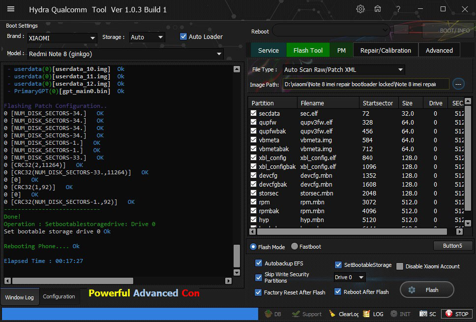

Xiaomi Redmi Note 8 (Ginkgo) Successfully Flashed using EDL mode by Hydra Tool
- Run Hydra Qualcomm Module
- Select Model of your device (cellphone / mobile)
- go to "Flash Tool"
- Choose Flash file and its location manually.
- Select Flashmode
- Tick"Factory reset after flash"
- Join the TP or Short the TP of Device (you need to disassemble the device).
- Click "Flash"
- Connect USB Cable and wait until the process is completed.
- DONE
