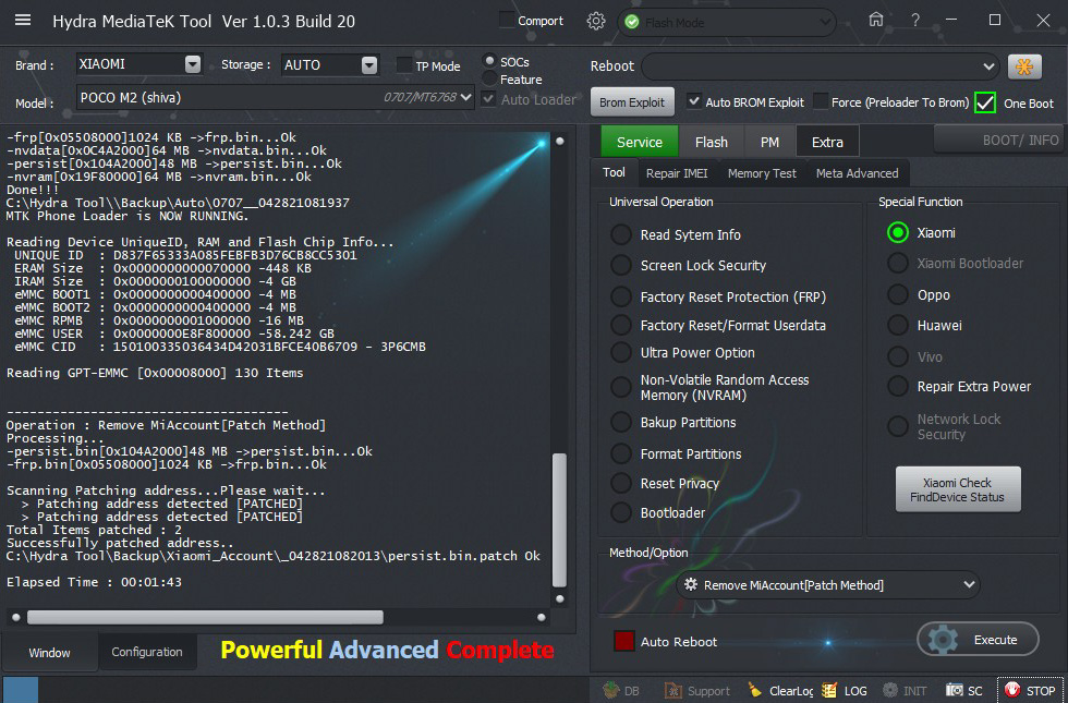

Hydra Xiaomi Poco M2 (Shiva) Mi Account removed using Patched Method by Hydra Tool
549
1. Run Hydra MTK Module, Select Brand and Model
2. Go to Service-->Tools-->Xiaoami
3. Choose "Remove Mi Account Patched Method" from Method / Option
4. Execute and connect the device to the computer with data cable
5. wait until the process is completed.
Note: Only in MTK devices, Android above 8, need to install VPN software before you connect wify. But, no need VPS software in Qualcomm module even highest miui vesion ie. 12.xx.xx. No need server! No need Credit! No need yearly activation! No need any extra cost .

FriendlyName :MediaTek USB Port_V1633 (COM45)
SymbolicName :\??\USB#VID_0E8D&PID_0003#6&12e3c9ed&0&1#{a5dcbf10-6530-11d2-901f-00c04fb951ed}
Handshaking...Ok
Identifying Hardware ID.....
BROM CPUID : 0707MT6768[6768]
getMTKPayloadExploit : 0707
#Executing Exploit..
#SUCCESS..
Handshaking...Ok
FUSEID : 00000000
SECURE VERSION : 00
BL VERSION : FE
BR Secured : E0
Preparing Download Agent..
DA : MT6768_Xiaomi_New.bin
Ver : MTK_AllInOne_DA_v3.3001.2020/07/07.10:10_513994
Init : Loader [1]
Sending : Accepted
Identifying Protocol...
Protocol : New
Synchronization...SYNC
Mode : brom
Preloader Initialization...
Parsing preloader_shiva.bin
Init : Accepted
Execute Secondary Loader
Init : Loader [2]
Executing : SYNC
UNIQUE ID : D837F65333A085FEBFB3D76CB8CC5301
eMMC CID : 150100335036434D42031BFCE40B6709 - 3P6CMB
DA Speed : high-speed
Autobackup Partitions
-> Renaming Preloader.... preloader_shiva.bin
Creating Scatter file... C:\Hydra Tool\\Backup\Auto\0707__042821081937\MT6768_Android_scatter.txt
-frp[0x05508000]1024 KB ->frp.bin...Ok
-nvdata[0x0C4A2000]64 MB ->nvdata.bin...Ok
-persist[0x104A2000]48 MB ->persist.bin...Ok
-nvram[0x19F80000]64 MB ->nvram.bin...Ok
Done!!!
Operation : Remove MiAccount[Patch Method]
Processing...
-persist.bin[0x104A2000]48 MB ->persist.bin...Ok
-frp.bin[0x05508000]1024 KB ->frp.bin...Ok
Scanning Patching address...Please wait...
> Patching address detected [PATCHED]
Total Items patched : 2
Successfully patched address..
C:\Hydra Tool\Backup\Xiaomi_Account\_042821082013\persist.bin.patch Ok
Elapsed Time : 00:01:43
