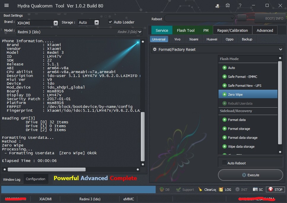

Xiaomi Redmi 3 IDO zero wipe formatted user data successfully removed by Hydra Tool​
1. Run Hydra Qualcomm Tool.
2. Choose Brand and Module..
3. Go to "Service"--> "Universal"
4. Choose "Format Factory Reset" from drop down menu.
5. Choose "zero wipe" from flash mode.
6. Connect cellphone with computer using usb data cable.
7. Wait until the operation is completed.
Screen Shorts
Xiaomi-Redmi-3-IDO-zero-wipe-formattting-user-data-successfully-removed-by-Hydra-Tool.jpg
Logs​
PreOperation Configuration
Brand : XIAOMI Model : Redmi 3 (Ido) Storage : Auto
Loader: mi_0_1.mbn
Port : Auto
Connection :
FriendlyName :Qualcomm HS-USB QDLoader 9008 (COM67)
SymbolicName :\??\USB#VID_05C6&PID_9008#6&223f1529&0&1#{a5dcbf10-6530-11d2-901f-00c04fb951ed}
Getting device info..Ok
Device MODE : Firehose
Connecting to Firehose...
Ping.. Ok
Configuration.......
Identifying Chip....
Ok
Chip Configuration :
MemoryName : eMMC
MaxXMLSizeInBytes : 4096
TargetName : 8936
Version : 1
Protocol : Universal
Running : Ok
Phone Information.....
Brand : Xiaomi
Vendor : Xiaomi
Model : Redmi 3
SDK : 22
Release : 5.1.1
ABI : arm64-v8a
Description : ido-user 5.1.1 LMY47V V9.6.2.0.LAIMIFD release-keys
Miui Ver : V9
Device : ido
Mod_device : ido_xhdpi_global
Board : msm8916
Display ID : LMY47V
Security Patch : 2017-01-01
Platform : msm8916
Fingerprint : Xiaomi/ido/ido:5.1.1/LMY47V/V9.6.2.0.LAIMIFD:user/release-keys
Reading GPT[3]
Drive [0] 32 Items
Drive [1] 0 Items
Drive [2] 0 Items
Formatting Userdata...
Method :
Zero Wipe
Processing...
- Formatting Userdata [Zero Wipe] OkOk
Elapsed Time : 00:00:06
